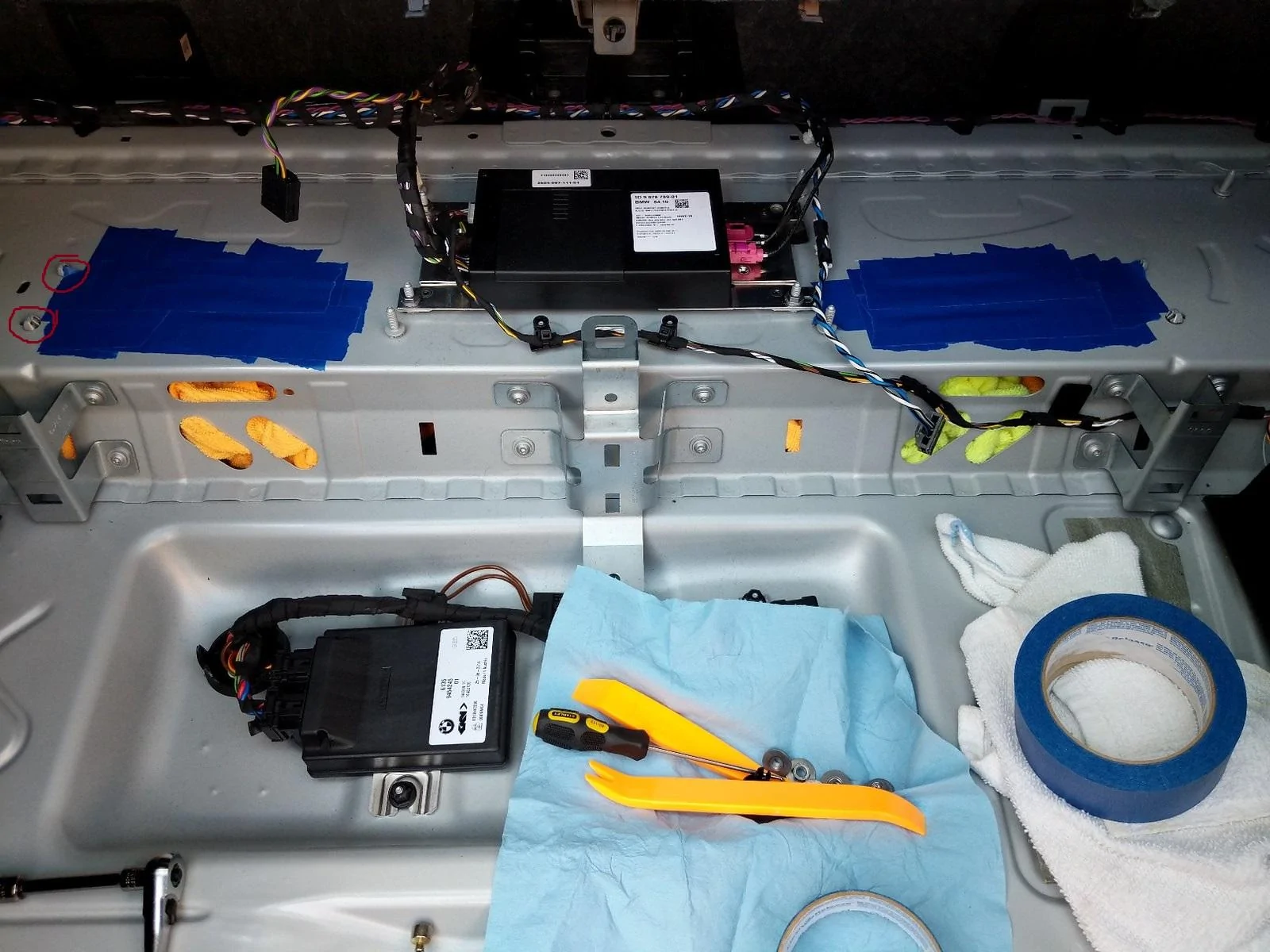

Update: I ended up ripping apart the entire back end of the car trying to figure out what was causing the vibrating. Was a two day ordeal trying to figure out where it was coming from.
I swapped subwoofers, same thing was happening, the noise stopped when I held the subwoofer off of the enclosure slightly. Found a little prong in the top of the metal enclosure that the sub sits on that was slightly loose so I ended up slapping a fat sheet of dynamat over the top of the enclosure on the left side and cutting holes for the ports. Ended up solving the vibration issue and now the subs/setup sound fantastic!
You will have to adjust EQ settings with the stock amp if you’re using Tadda’s settings because these are definitely punchier. Next step is figuring out what my plan is for the AMP.
