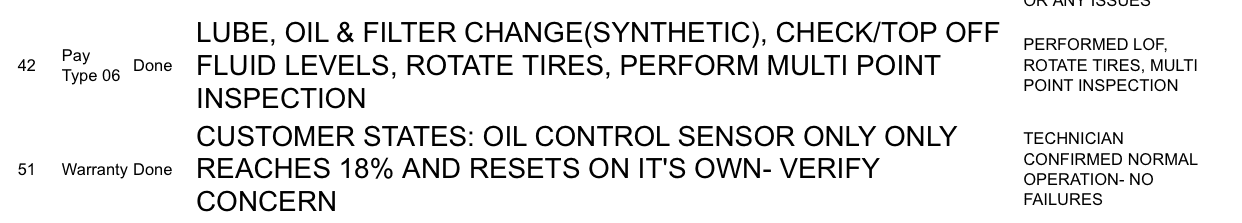

went to the dealership they found no error codes in their check. This is what their tech said:

I did to my service advisor- but because they couldn’t find any errors in the system they said it’s all good. If you google “bmw can’t measure oil stop at 17% etc” there’s tons of issues like this.

So quick update... my car has now been at the dealership third week going in for this issue and they are at a dead end. They simply don’t know what to do.
On the other hand they said they contacted an ex-BMW tech that now works for Toyota in Texas to get his input-this was last week and they still haven’t gotten a response from. Either they are giving me the run around- or they are lost. Thinking of using lemon law if they don’t get this fixed soon.

So another quick update- the Toyota rep my dealer has been in contact with told them yesterday to disconnect battery for 30 min and reconnect and test drive. This was a solution another member was able to use for this same exact issue. They did that and then a test drive but it didn’t work for me.
Now in this new test drive a new error came up. They had low oil pressure code and check engine light came on.
I have been telling them since day one of dropping off my car that they need to replace the oil pressure valve assembly assembly because that’s what people on bmw forums did when this issue happened. I already pointed them to the correct part number 23950WAA01.
Having said that, I am also one of those Supra’s who oil is consumed at an alarming rate. Now if this specific part which controls oil pressure and consumption throughout the engine is faulty this early, does this mean this may be the main culprit in all the 21s who have oil consumption issues?
Let’s see and find out once this part is replaced.

They are doing a calibration on my car now.
They claimed the OBD scanner I had might have messed with the electrical stuff? Is this something that people have had problems with? With their OBD scanners?
