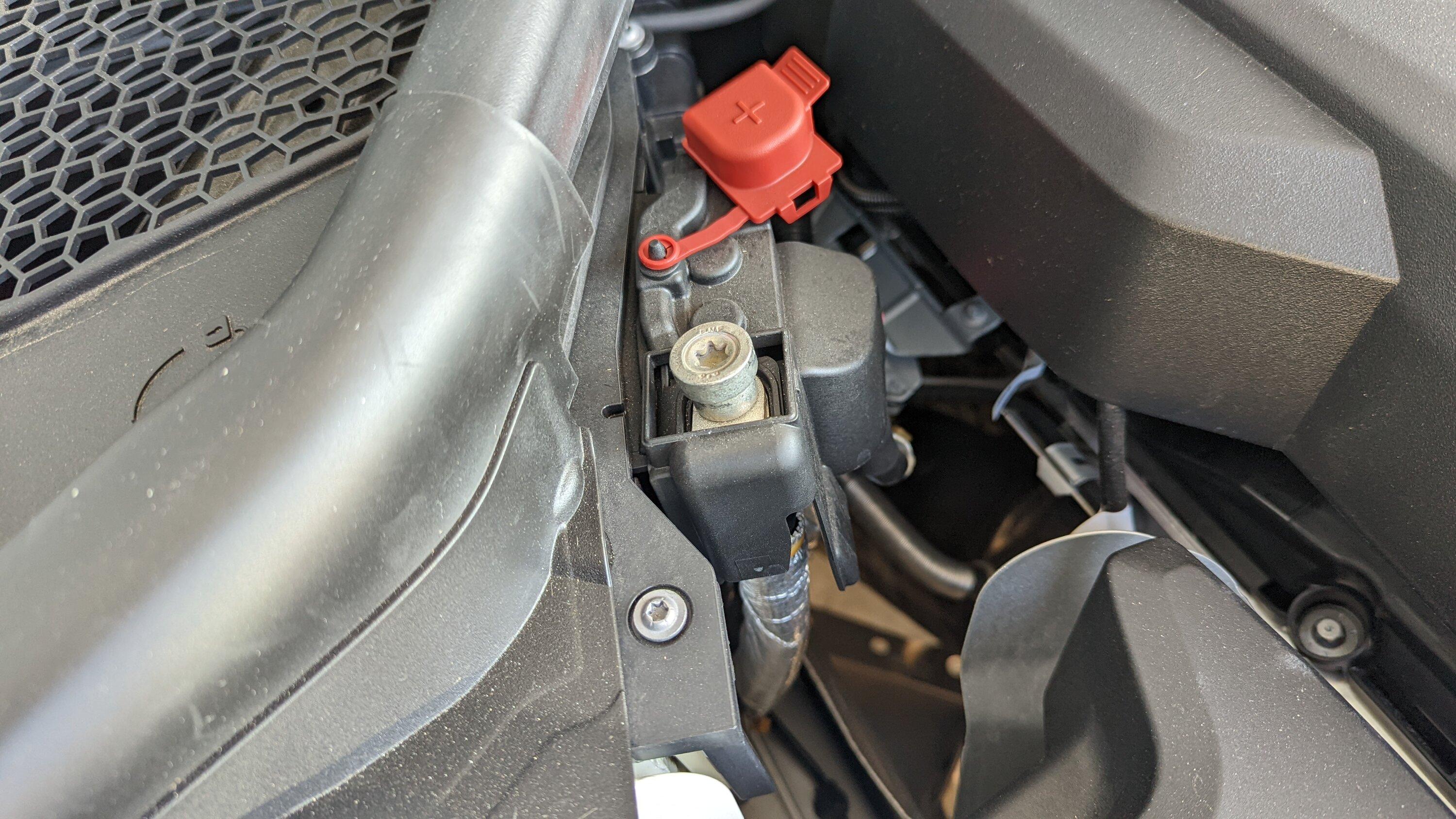

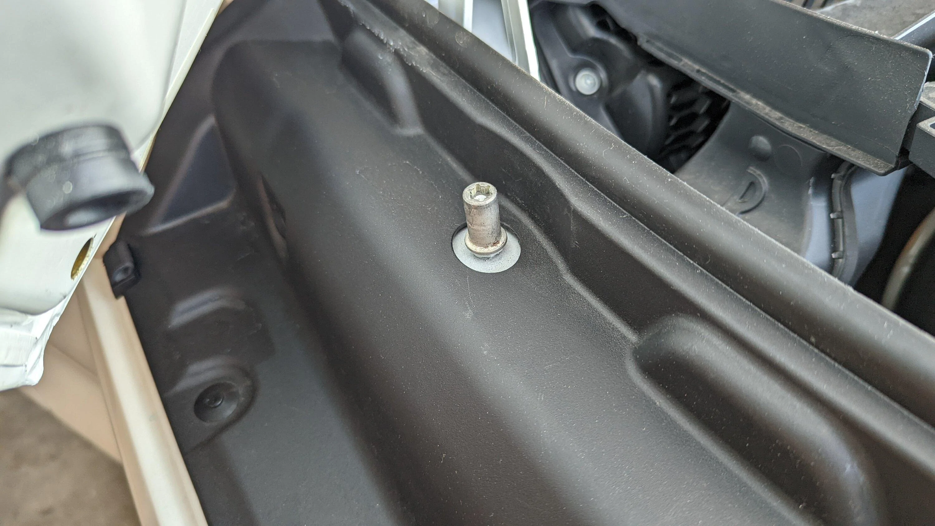

@NewSupraOwner a standard battery charger won’t do a thing for that battery, not overnight, not ever! If you can’t start it from UNDER THE HOOD, then you must’ve popped a fuse or something. I had to charge my jumper box 100% before it would start the car from under the hood. I don’t care if you have 15 diesel trucks hooked up to the battery, it will not start!
Thanks. As mentioned, I only attempted to jump the car from under the hood. Pics are the +/- terminals I used.

Make sure your jumper box has at least 14.6 volts. If it doesn’t start, it’ll need to be towed most likely
