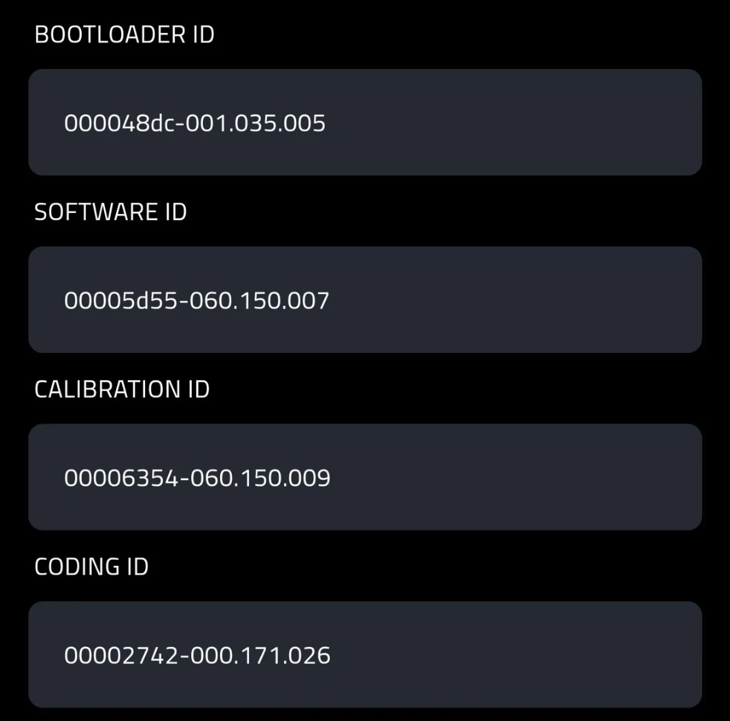

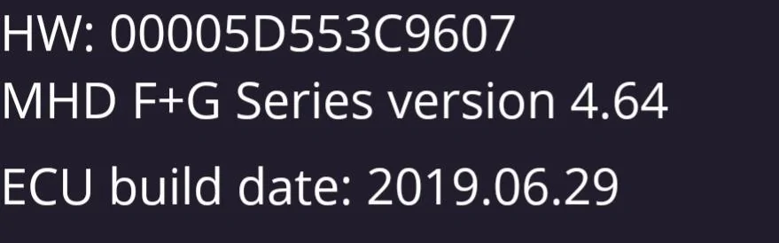

Plugged into MHD and BM3 and these were the outputs:
As far as I know, there shouldn't be any open recalls for this car so it's potentially got at least whatever the most recent dealer update was.
