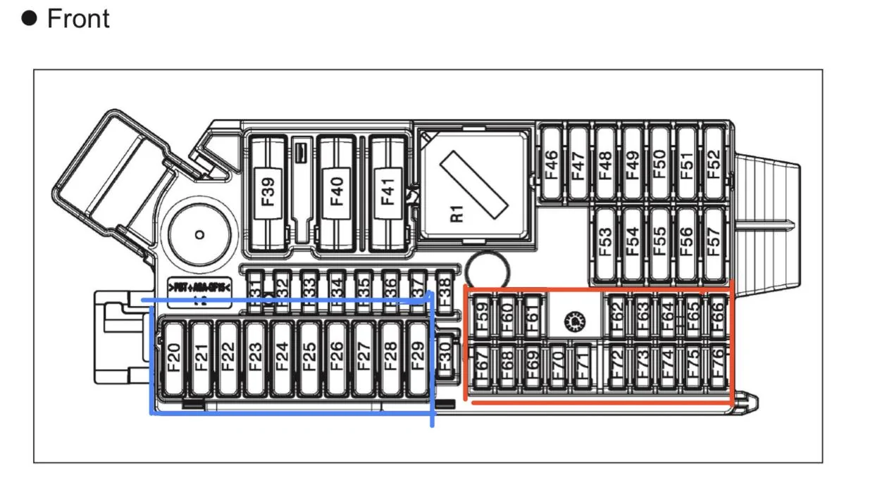

It has been a while, but I seem to remember the following:
Front:
  • The bank of fuses F20-F29 is always on.
  • The bank of fuses F59-F76 comes on when the car is unlocked, the doors open, car is turned on, etc.

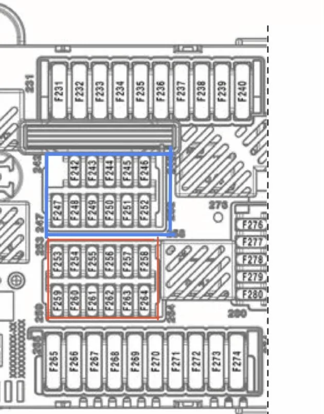

Rear:
  • The bank of fuses F242-F252 is always on
  • The bank of fuses F253-F264 comes on when the car is unlocked, the doors open, car is turned on, etc.
I’m pretty sure this is what I found when hooking up my dash cam/interior lights.
A couple of notes: I only added my fuses to empty slots rather than tap into an existing fuse. Also, check which fuse you are using in your owner’s manual to make sure you are not overloading anything, nor taping into a fuse for a critical system.
Hope this helps! Good luck!
Front:
Rear:

From what I’ve heard, tapping into any constant power is likely to cause a battery drain issue on these cars. I only used the fuses that turn off after 6 minutes - I found the constant power fuses only to make sure I avoid them. I know a lot of dash cams/other car electronics will have some sort of battery voltage protection, but I can’t say how effective these are. Sorry I can’t be of more assistance.

Thanks to this thread I was able to find the front fuse box on the passenger side. Nothing in the manual to say where it is. It’s below the glove box and there are two plastic parts that unscrew and the panel comes off. You will see the fuse box on the right. Hope this helps.

It’s in the fuse box in the passenger foot area. I don’t remember what fuse exactly but there’s a schematic floating around here somewhere

I tapped into F62. The floor lights stay on while the car is running but turn off 6 minutes after locking.
If anyone comes up with a better solution, some of us are listening.
I'm trying to do something similar however I wanted the lights to be on only when dark so basically whenever the interior buttons are backlit (headlights/parking lights on).
Does anyone know what fuse controls the cabin's backlighting/minimal ambient lighting? I suppose the headlight fuse would work but that seems overkill and I assume there's something simpler I can tap into
