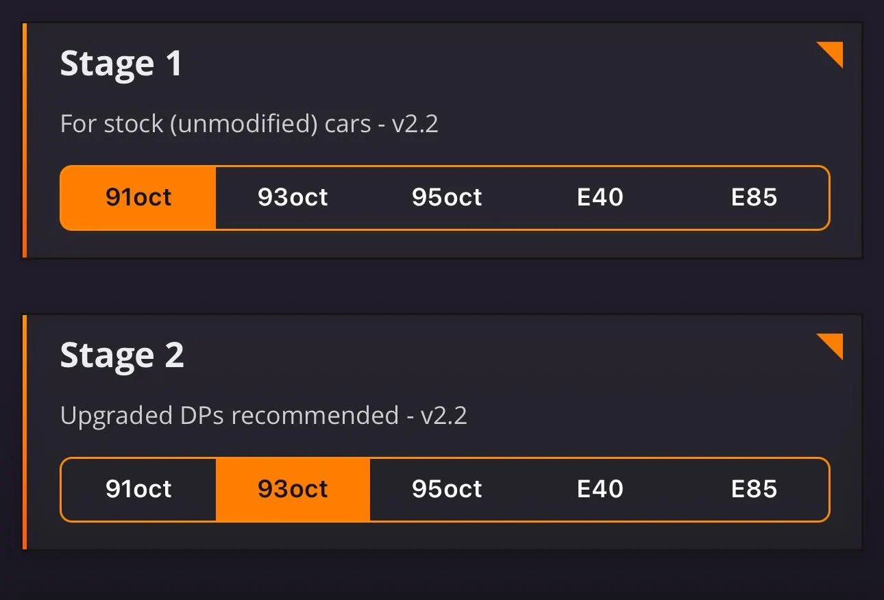

Has anyone used the E85 OTS Map on MHD for the supra?

Just realized I had this map show up after I started the car up after a month. I thought full E85 cannot be used unless you have a LPFP and PI. Thanks.

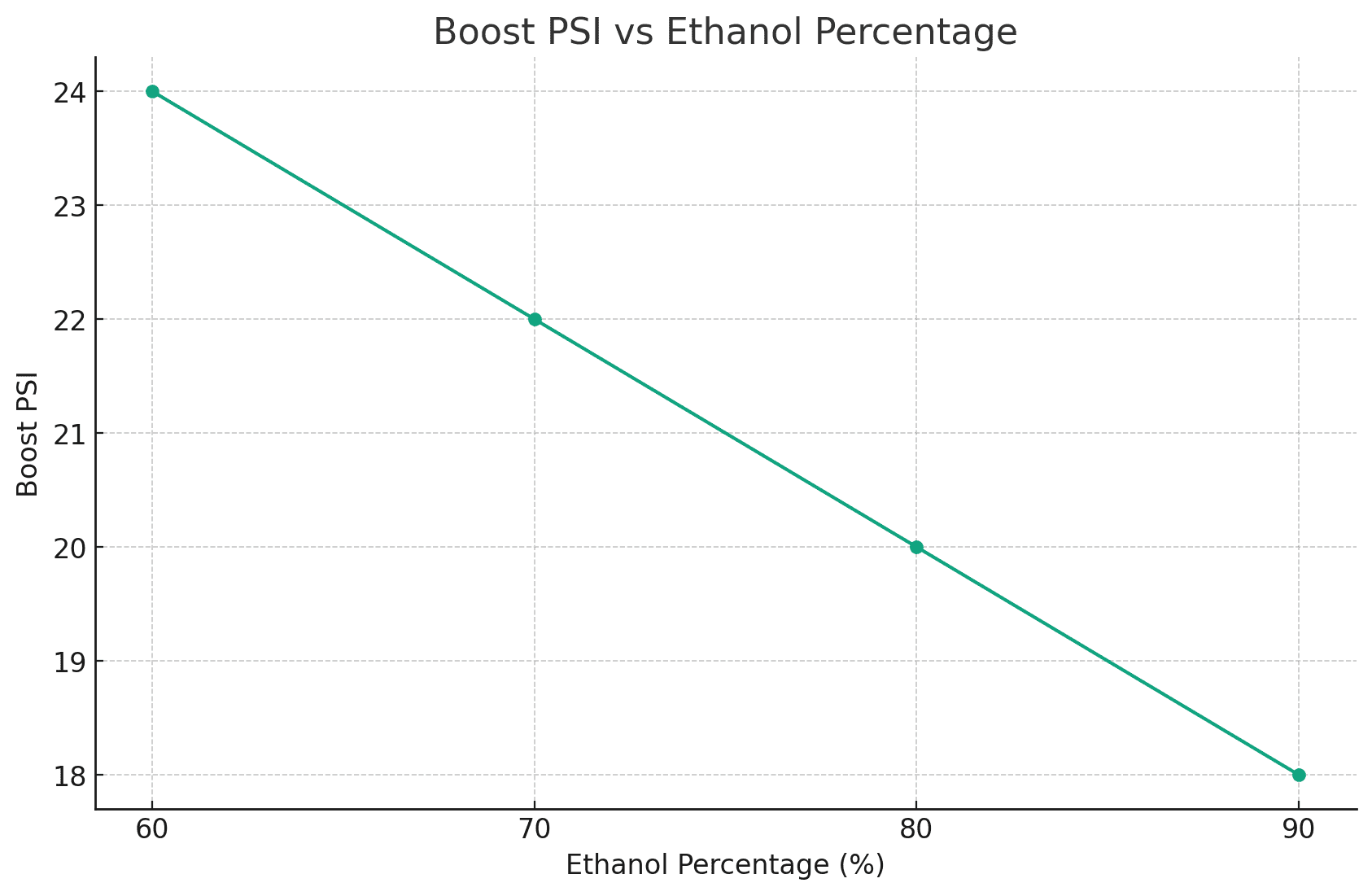

//Edit: just to help visualize what I'm talking about, here's a made up chart that illustrates the issue. As you add more ethanol, the PSI (air volume) needs to come down so the fuel pump can keep up and keep the air/fuel balance correct. You can run full E85, but you need to give up boost. Exactly how much kinda depends on intake and ambient air temps.
