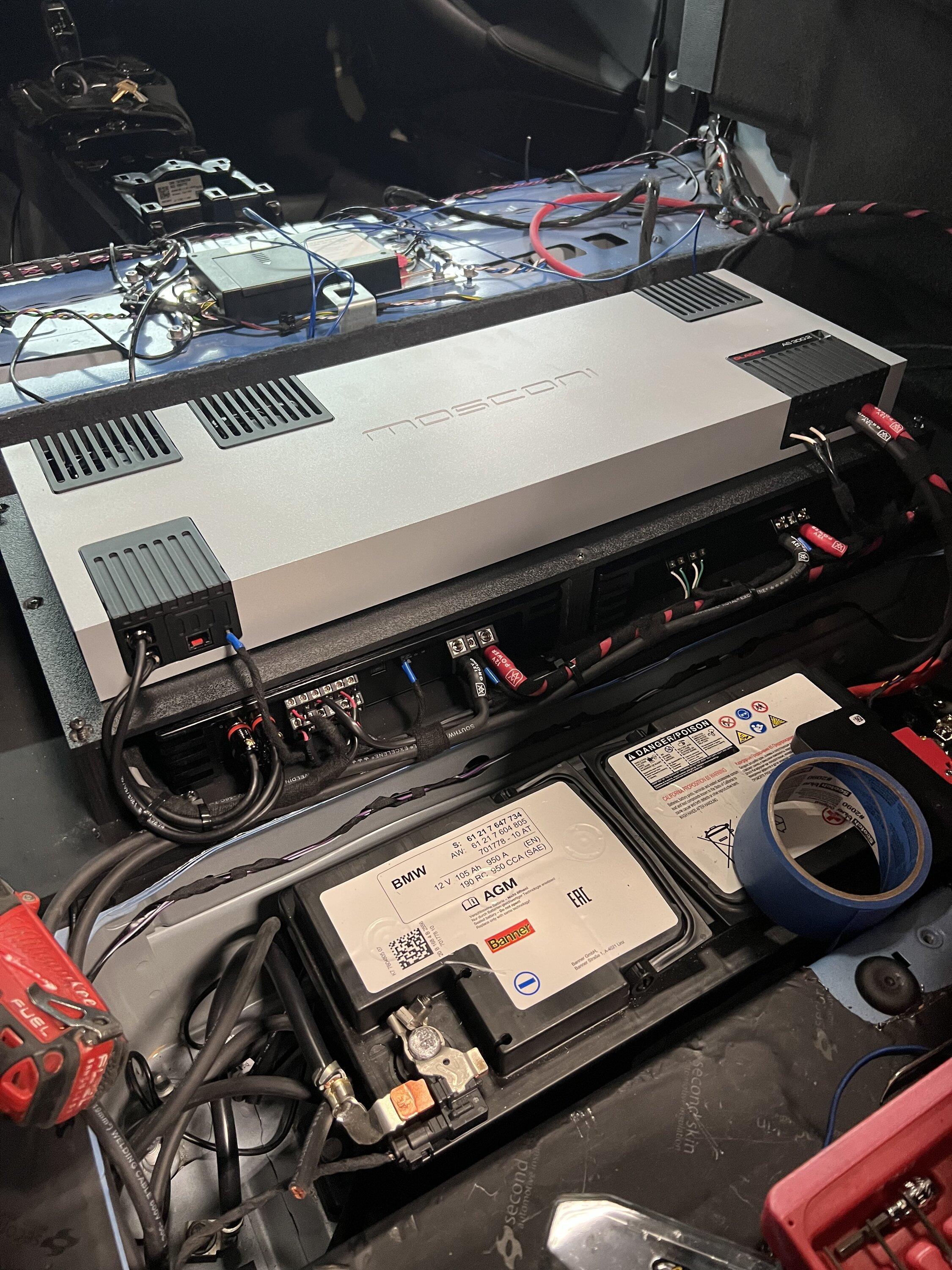

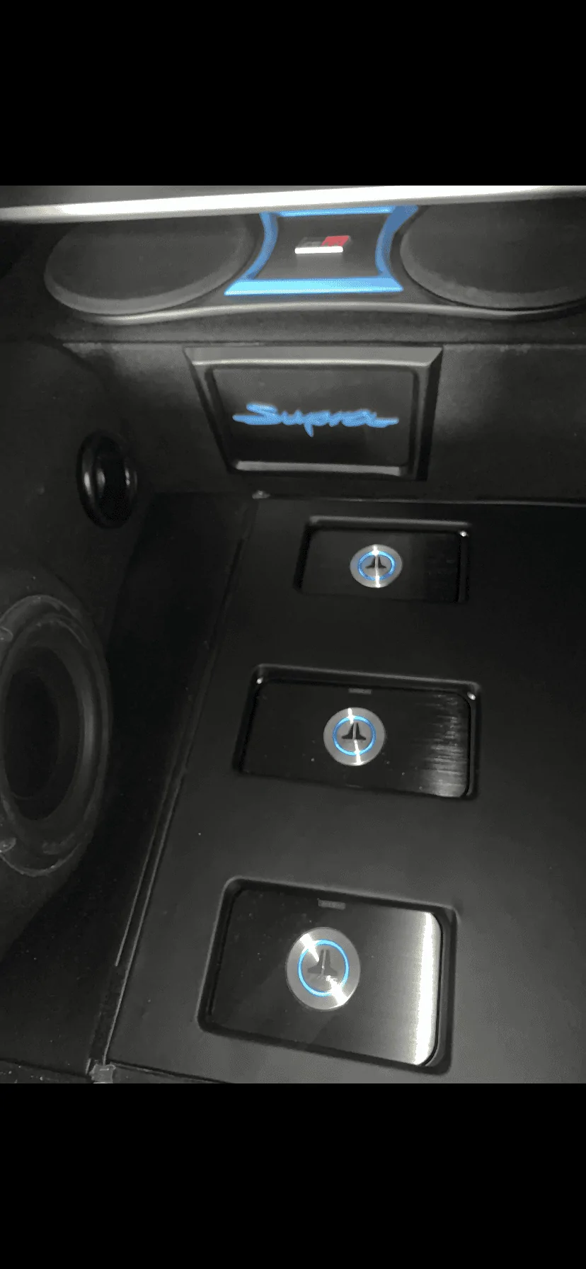

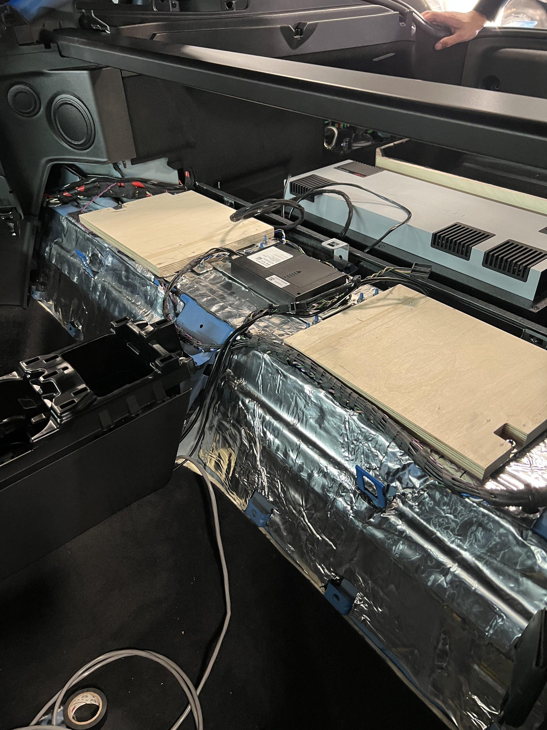

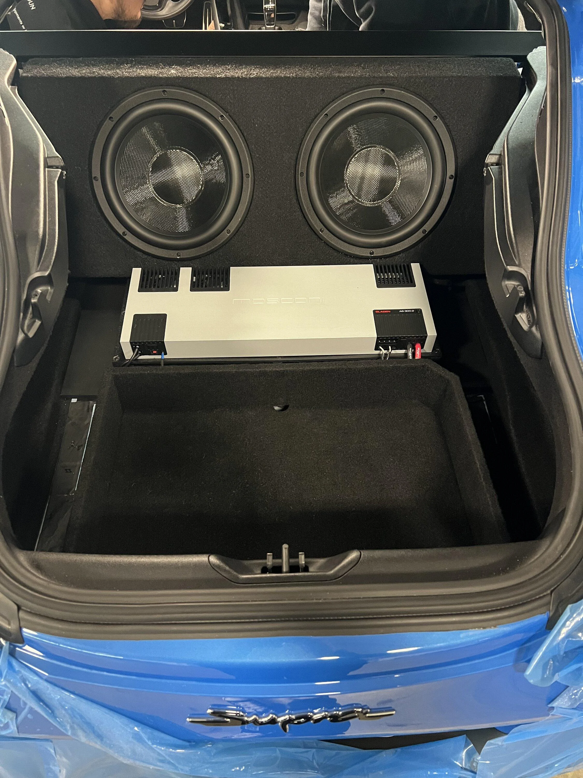

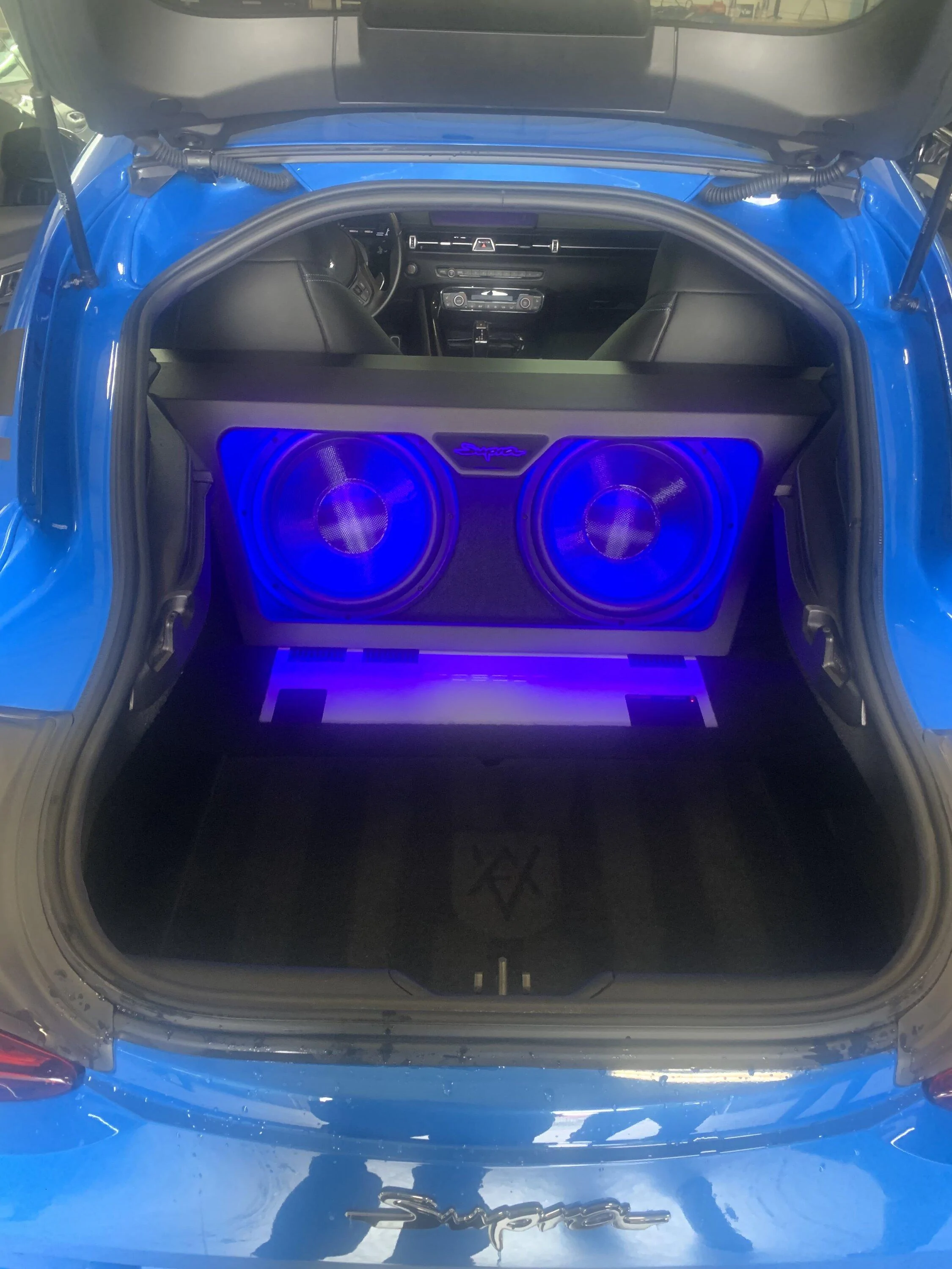

I tried that way first. Was bad idea. Went this route instead
That set up is nice. A bit to much for me though. Did you remove the OEM subwoofer components for that audio job or just build on top of and/or around?

I did the first time. Will show you my first build. If it’s ok w the recent guy shaming everyone for adding a sub.
Sam B
Sam
Jul 5, 2021
31
371
272
Northeast PA
2021 Supra
Here’s how I did this part. Will have to go back and find the other ways. Give me a minute
Sam B
Sam
Jul 5, 2021
31
371
272
Northeast PA
2021 Supra
This was the first attempt. Midbass on top of existing box and ported 10 in the rear

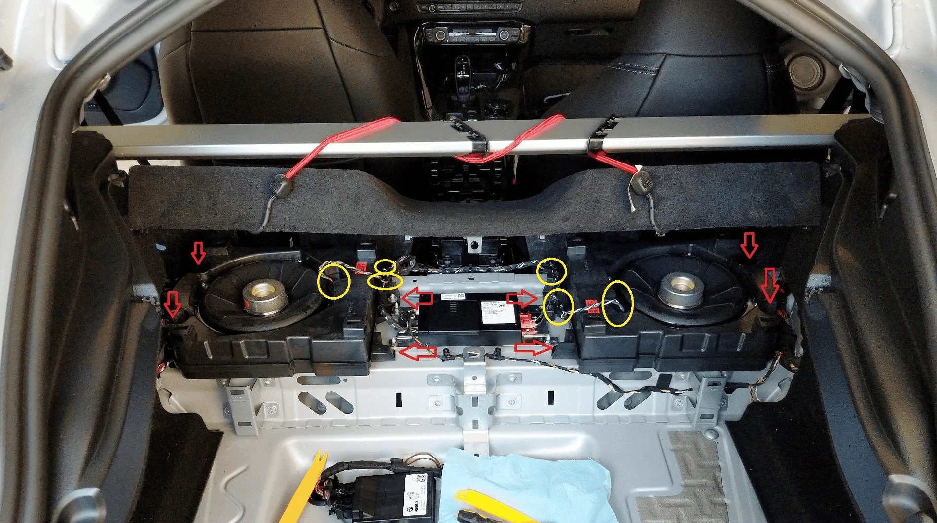

What's interesting though is that it wasn't that bad before I started the project, so I kinda feel there's something at the upper piece of the subwoofer box. I see you removed the side panels before, have you removed that top part as well?
I forgot to post on here but the dealer did end up replacing that speaker finally (probably) and if anything just made matters worse. At this point I'm thinking there is just something vibrating behind one of those panels so I'm probably just going to tear it apart and fix it myself. It's bad enough now that I can hopefully track it down more easily.
The reason I say they probably replaced it is because the receipt they gave me listed the part number for the passenger side but they say it was actually the driver side they replaced.

I tried just removing the top subwoofer case to try to see something but it didn't helped mine on anything (at least on mine). It's worth trying to see if you can find something before tear it down. There's just a couple clips around that you need to gently pull each one up. Easy to remove and reinstall.
I also found this topic where they just slid the baffle high enough to access the subs so no need to remove the entire thing, I will try to do that any day. That would definitely help on finding the damn noise.

The stock rear vanity bar rattles alot
Also stuffing the inside of the subwoofer e closer with speaker wadding helped out tremendously
I ended up using the Integral Audio subs for F series BMW and did the Cusco harness bar plus speaker wadding mod and all of my rattles are now gone

It's definitely NOT the small set of speakers behind my head. I have that taken out now and the sound is coming from the subwoofer area. I'm leaning toward the driver side subwoofer itself having a blown voice coil.
Are you saying integral audio makes a replacement speaker that will fit in the stock subwoofer box? If so can you link exactly what you bought?
