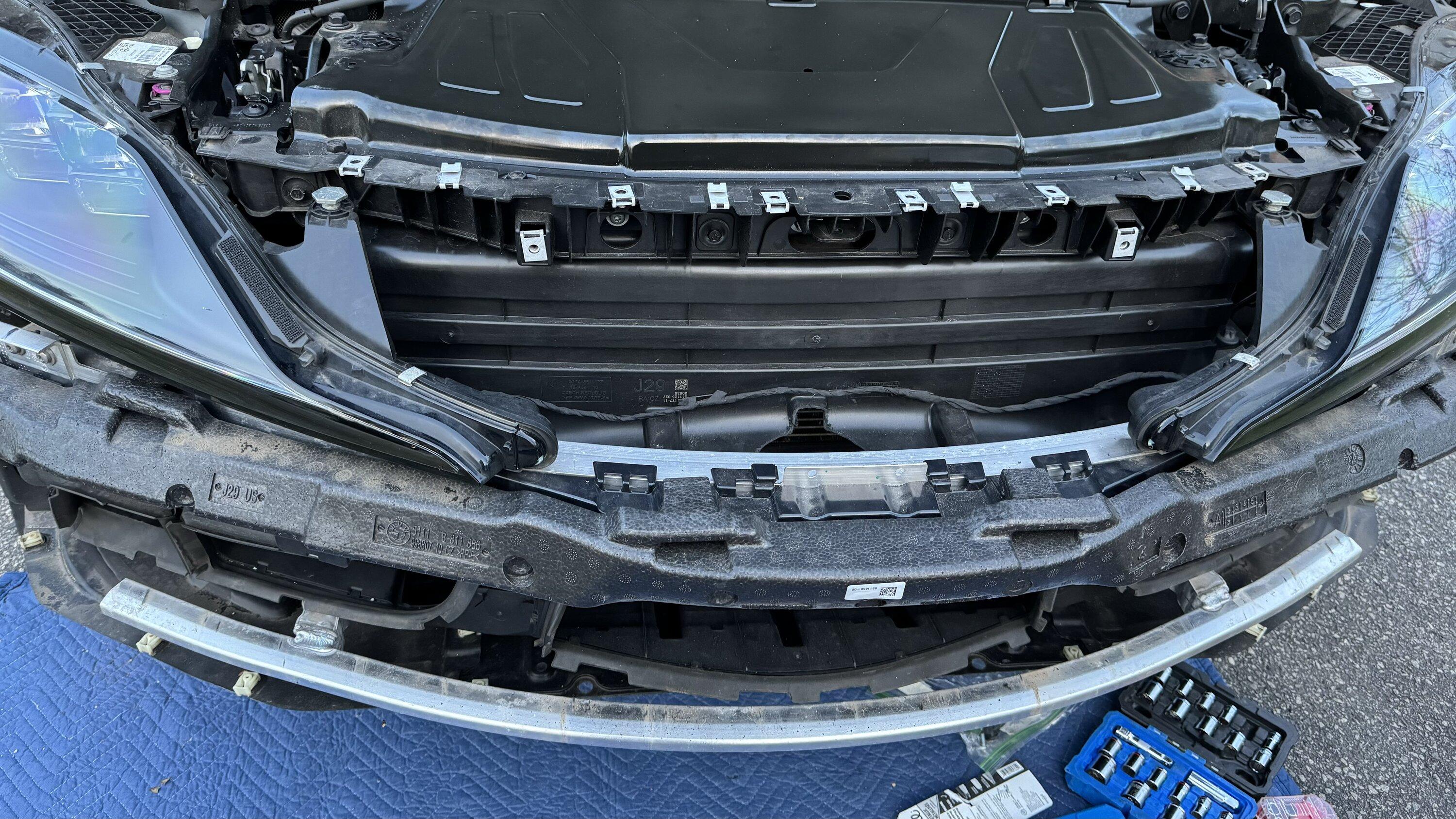

I installed a ram air snorkel. I put the 2022 Supra on a ramp and unhooked the battery. I then removed the front bumper and installed the ram air snorkel. It required cutting out a plastic piece for the air duct to be routed. After the installation I rehooked the battery and have been driving the car over a couple hundred miles.

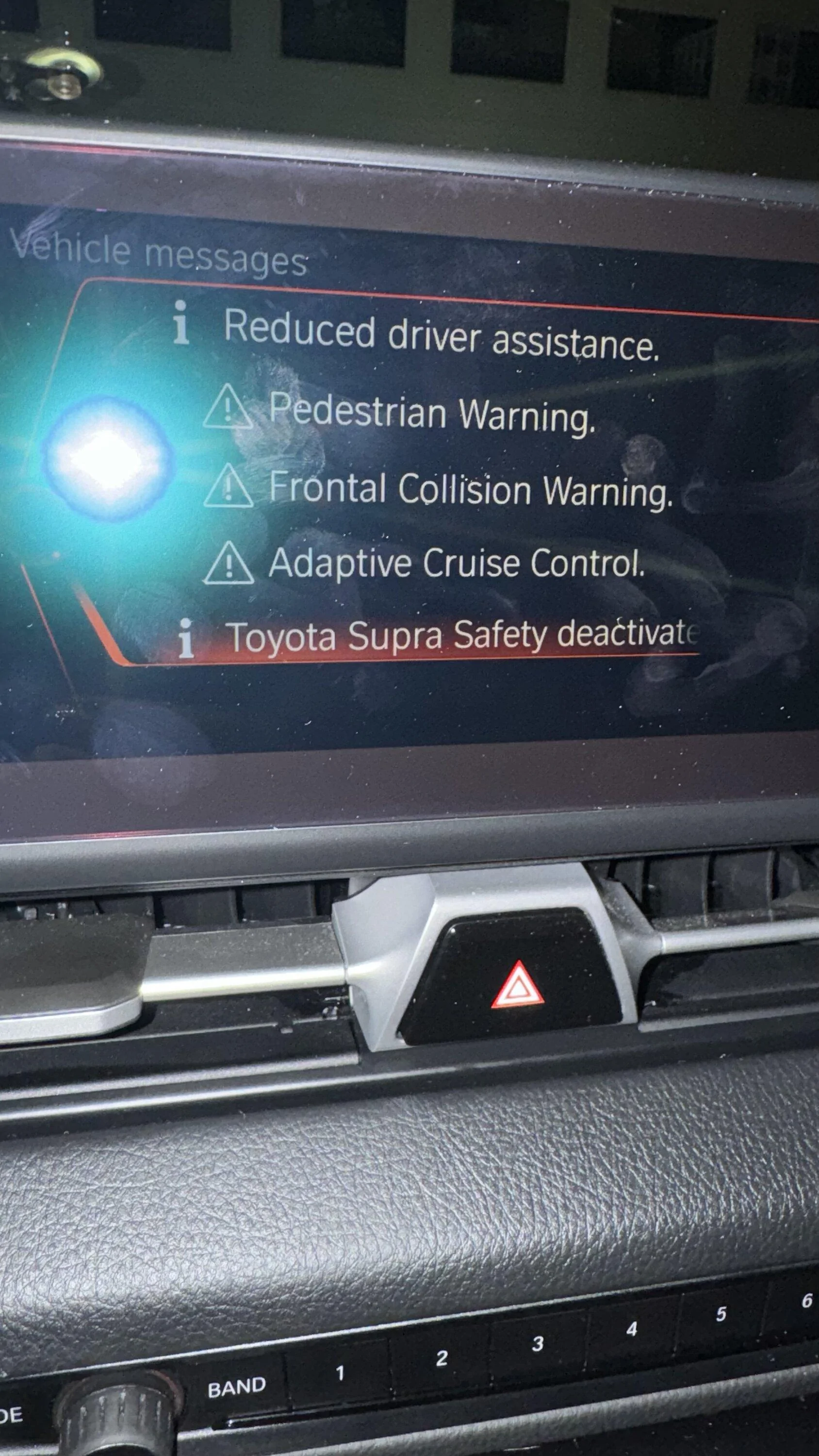

The initial warning error is
Reduced driver assistance
Pedestrian Warning
Frontal collision warning
Adaptive Cruise Warning
I also noticed cruise control is not responding and is not able to be used.

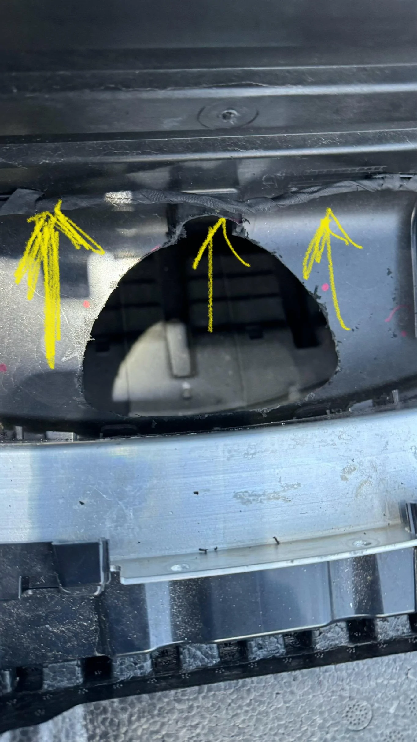

My question is how do I get rid of the warning and is it possible I might have damaged the wiring near the cut out plastic with the multitool? I have researched and on the bumper itself on some BMW there are fiber optic glass that is part of the pedestrian collision system.
attached is the wiring cable that I am concern about and if there is any knowledge if fiber optic may be wrapped with the wiring

Are parking sensors working ok? Sounds like it. So, wiring to those should be good...
Have you checked/damaged/ the radar or it's bracket or wiring ?
Is the bumper aligned/installed properly. Some had difficulty putting it back on...

Parking sensors are good and working. I think the radar may be the lower passenger square box with QR sticker. It appeared ok.
The bumper is correctly placed with all screws but can be pushed up some more closer toward the car engine. It’s slightly off and can be off by millimeters. I can revisit it and see what I can do with extra hands.

If everything is plugged in, reseat the bumper and then clear the codes and see if they come back.

No errors. Zero. Just warning and no cruise control. The bottom Infomation is due to me manually disabling the system from troubleshooting
Pedestrian Warning

My main concern is the wiring in the picture. Although the wiring wrap was not punctured, I did tap it a couple of time with the oscillating multitooll when I was cutting out the plastic.
If this wire wrap has a boobie trap fiber optic for collision signal then I am afraid it may be broke.
