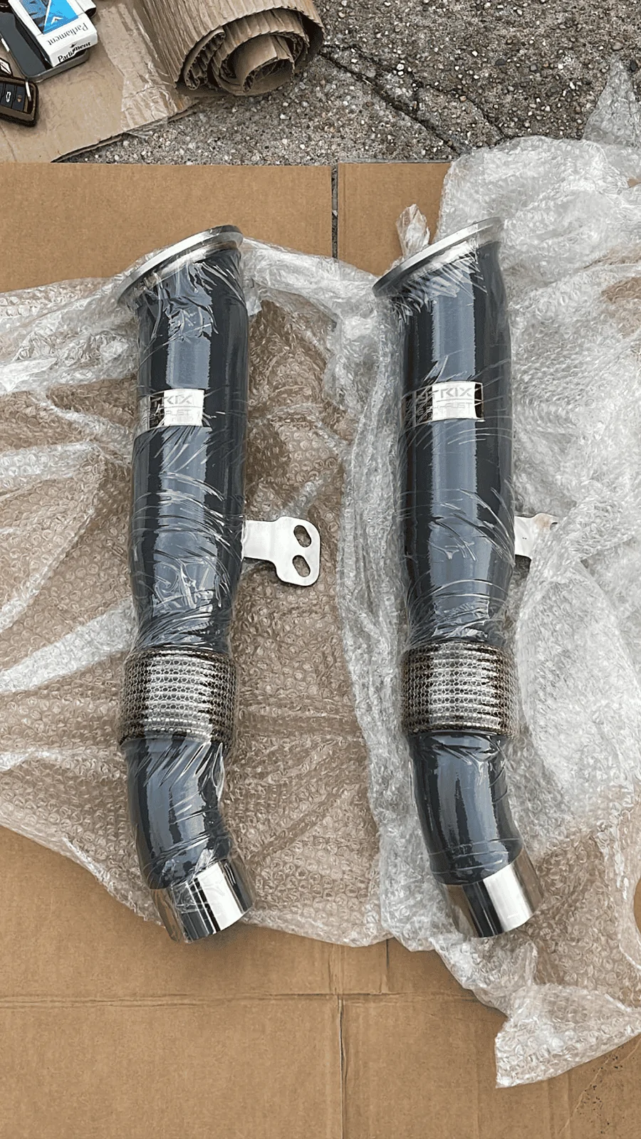

If you ask Vivid Racing, they will always advocate for army trix as they're the main north American supplier for the DP's. I bought one, but am still waiting for my car to arrive any day now then I can give you feedback. Welds *look* fine to me as the penetration is apparent at the flanges. But only time will tell.

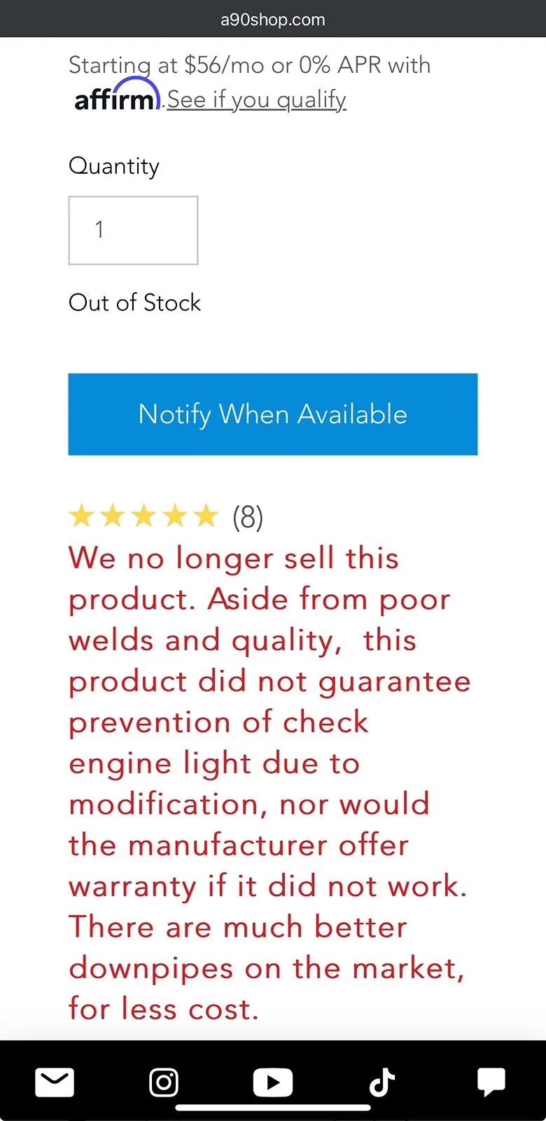

The welds look great and condition of the dp looks upto par as advertised.
Go back on a90 shop review and they deleted all the good reviews and posted some negatives ones as well lol. Still sour.

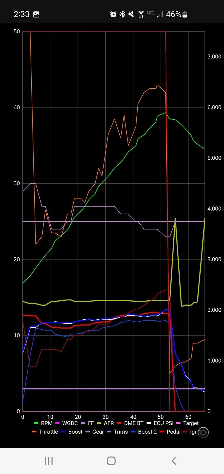

No, going catless on MT causes a lot of throttle closures even on stock tune, but it still feels normal and smooth. When you add a piggyback in the mix, it is a mess.

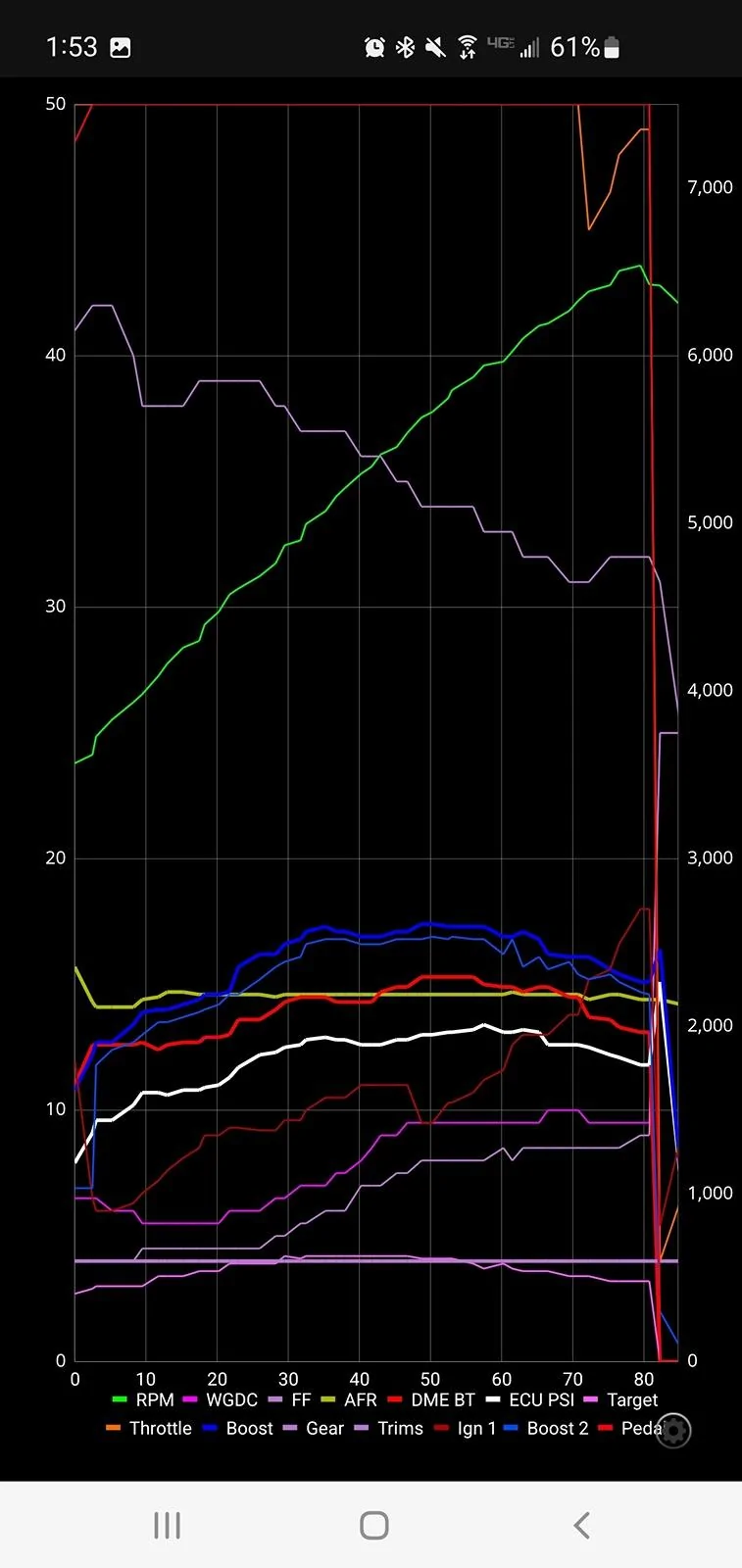

you need a JB4 with EWG control and custom firmware to resolve it (or unlock+flash obv). My catless MT runs just fine on JB4 now. Not quite as potent as the equivalent AT, but its much stronger than stock.
Here is a log of Map 0 (which is JB4 off/stock) on catless MT- pretty substantial throttle closure (orange line). 10-12 psi of boost.

Here is with the JB4 on, and the DP is tuned for. 16-18 psi boost
