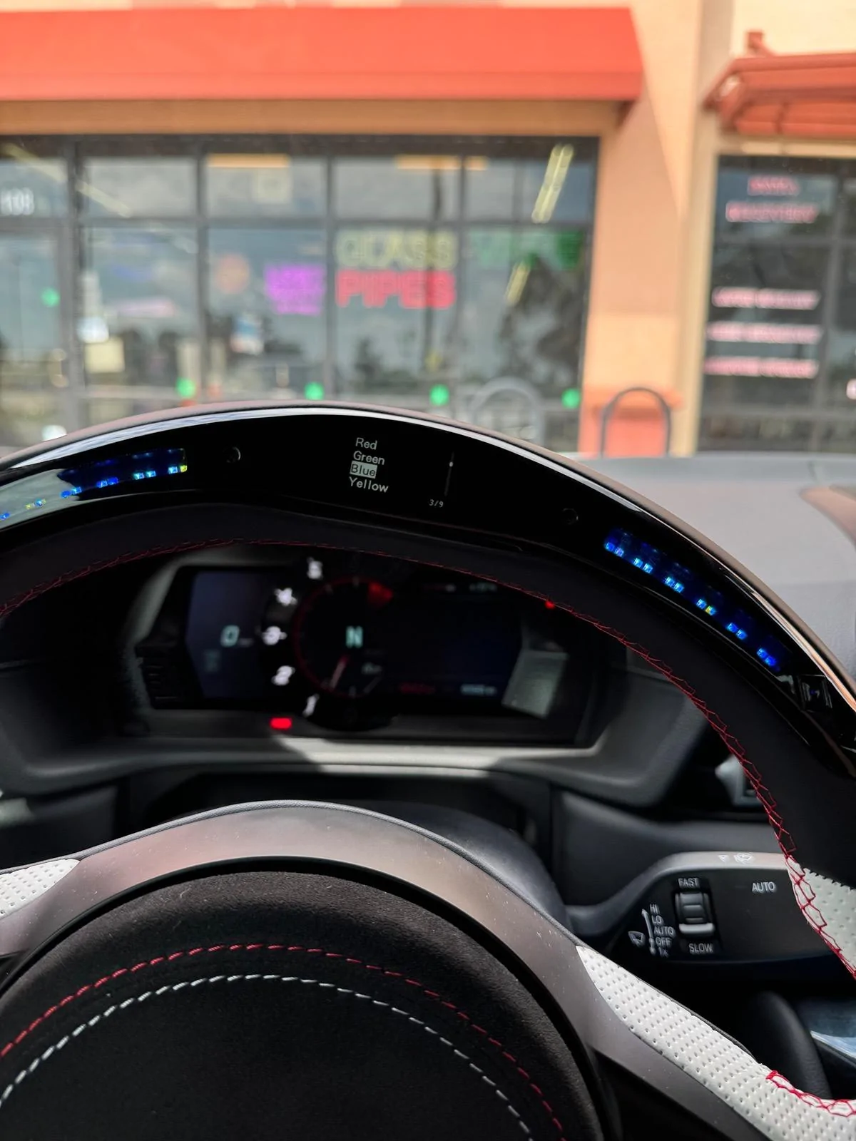

Hey everyone! Just got my steering wheel installed and wanted to make a brief write up about the install difficulties and features on the wheel. I’d be more than happy to answer any questions anyone has but without further ado, here we go!

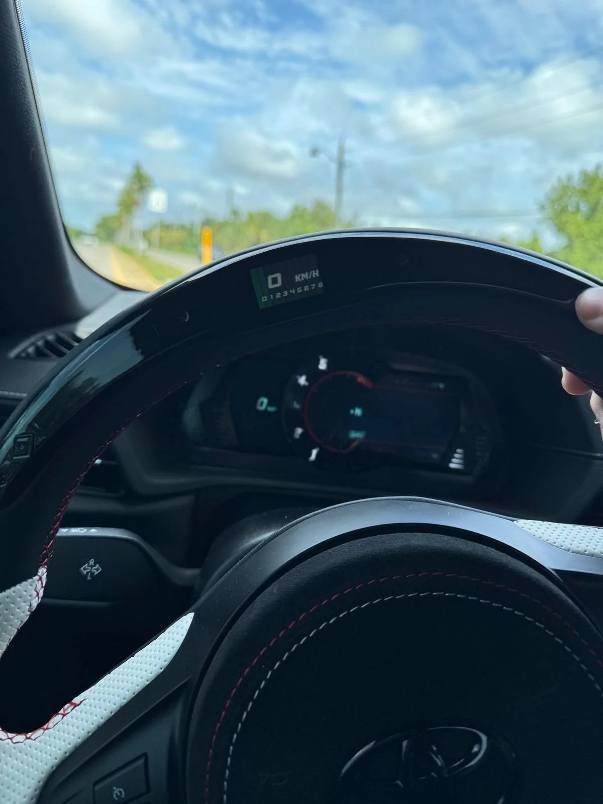

Firstly the wheel is a custom wheel from @NitroYellowMKV super high quality, definitely an upgrade over OEM. The LED itself has a fair few features as well that can all be adjusted with buttons on the wheel itself. The shift lights can be manually set to come on at your preferred RPM as well as the brightness of the display and units of measurement.
now to the install portion of things. I had a local shop, 1k Motorsports install the wheel for me. They were able to get the wheel itself installed and connected power to the LED on the wheel but were unable to get the Bluetooth OBD to pair. The way I solved the pairing is as follows, (this was on a MT 2024, not sure if it will be different on different models)

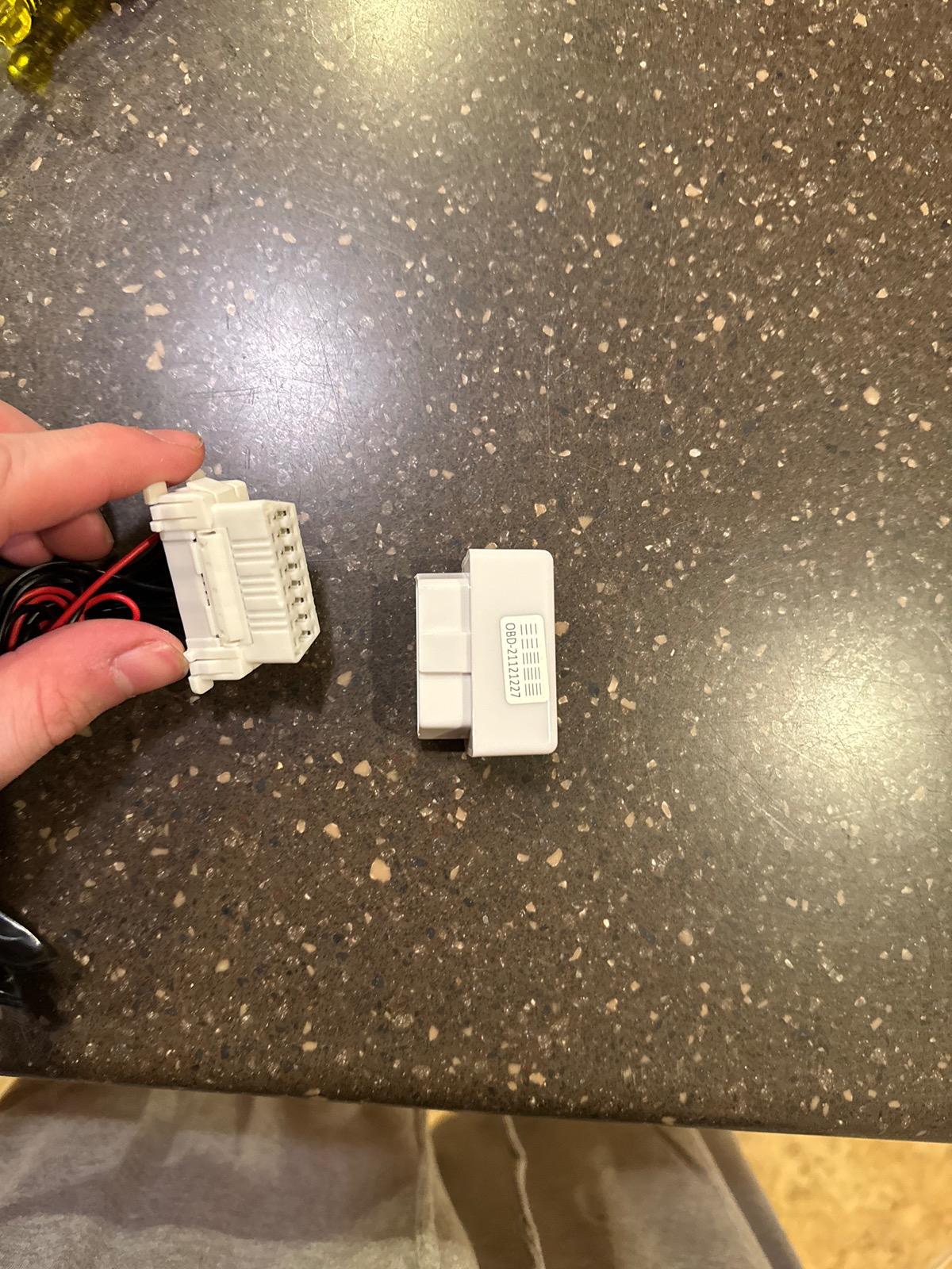

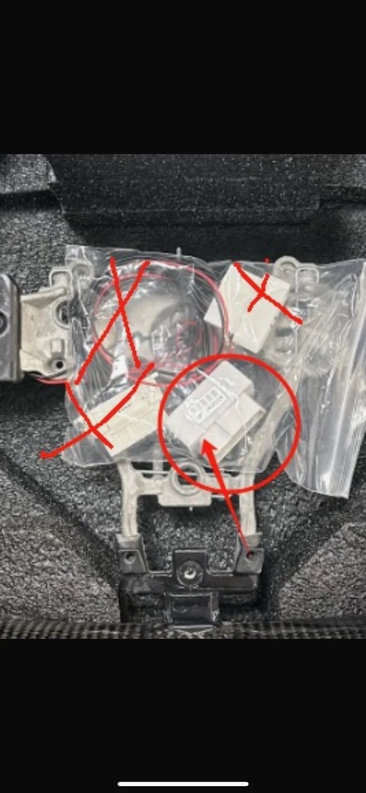

make sure that the small obd box is the only thing connected to your obd port. The extra plug that has the black and red wires coming off of it was not needed. When the obd box is plugged in you should be able to see a blue flashing light coming from it. Once this is in hold down both buttons on the wheel to turn on the LED, and then hold down the right button to search for your Bluetooth module. The wheel itself will search for a second or two then pair up.
Once I figured out it was just the module itself that needed to be plugged into the obd2 it was smooth sailing. These were the official steps that were sent to me while troubleshooting.
Here are the official steps :
1.hold down both side buttons and turn off the LED about 15'
2.remove the OBD
3.hold down both side buttons and turn on the LED after 2 min
4. plug the OBD , hold dow the right led buttons
