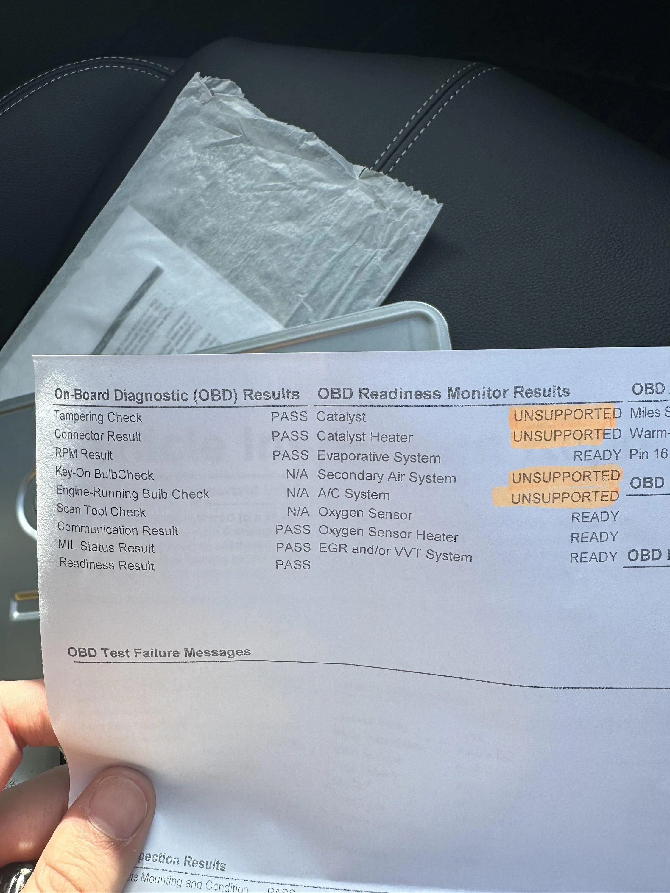

I ran into the exact same thing in Mass with BM3 and an AMS catted DP. Flash it back to stock and make sure that anything modifying the catalyst monitor is just set to OEM. BM3 turns off the CEL monitoring for the cat even with the stock map, I didn't realize this and had to go see the state referee as a result :). I had to go back to my original test when I bought the car to confirm what things were already unsupported. A/C system, Secondary Air, and Catalyst Heater were all unsupported from the dealership inspection.
You're gonna want every monitor ready so get yourself a cheap OBDII scanner that will show you emissions readiness.
After a lovely evening in the MACS I passed with the AMS DP.

They knew that the tampering was involved because the OBD test failure page was blank, no feedback which instantly flags you. Aftermarket exhaust isn't illegal so I don't think you need to change it back, for reference I have always had the OEM exhaust.
The MAC I was referred to is in Tewksbury but this may vary. You should have received a number to call from the failed test, the call center will refer you to a location closest to you. You make an appointment directly with person that makes the inspection, they'll quiz you about what has been done to the car and advise you on next steps.
There aren't many locations so it was sort of a pain to get to. I also needed to drive the car a lot in order to get the monitors into ready state. This was the worst part. Are you on BM3 or Ecutek?
