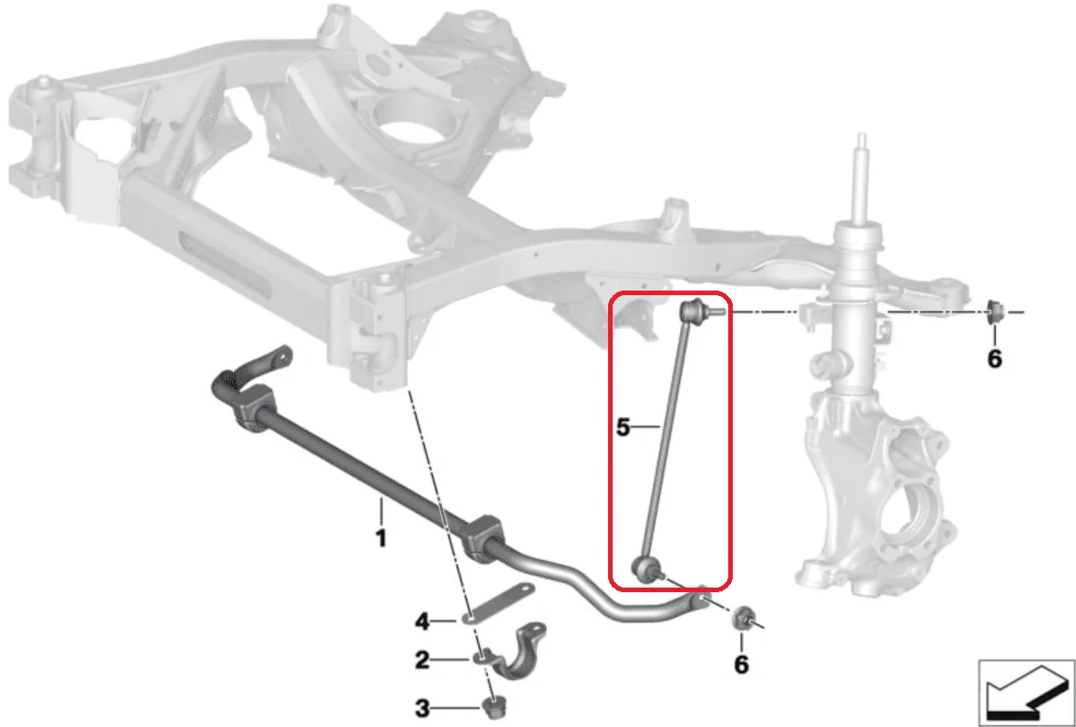

Righto I've had the chance to look at the ohlins and how they need to be located for use with after market swaybar links. As stated by someone else you need to have the J shaped link mount on the ohlins strut at the 10 o'clock position on R front and 2 o'clock on the L front this should give enough room for the thicker links to have room to move around. So if you are planning on using adjustable sway bar links you will need to position your struts as per above not what the ohlins install instructions say (sticker facing brake caliper). I thought i might save someone some time and confirm that this is how you gotta roll.
This is such vital information i havn't found anywhere else but on here, thank you. I ran into the same issue last night with the SPL / Ohlins combo and couldn't for the life of me figure why everything looked like it was going to smack each other. Even what SPL told me over the phone
conflicted with the instructions in the box.
I had just one more question, which way are the nuts mounted? for the bottom i remember the nut was on the inner side of the vehicle when i removed it. for the top are they supposed to be screwed on from the front?
thanks so much everyone.
Glad i could help someone, it cost me 1 SPL sway bar link due to it getting bent for me to figure it all out correctly

Update.
Got them on yesterday but just the fronts for now. I had the orientation of the link mounts exactly the opposite as @Oodis said to have it. I never put my stock links on after i installed them and took it straight to corner balance/ alignment. Adjusted the orientation and everything lined up nicely. All that's left is to somehow get my car to fit on my lifts at work so I can properly adjust length. Drove it around though and seem good but man these are noisy lol. Thanks again everyone.
