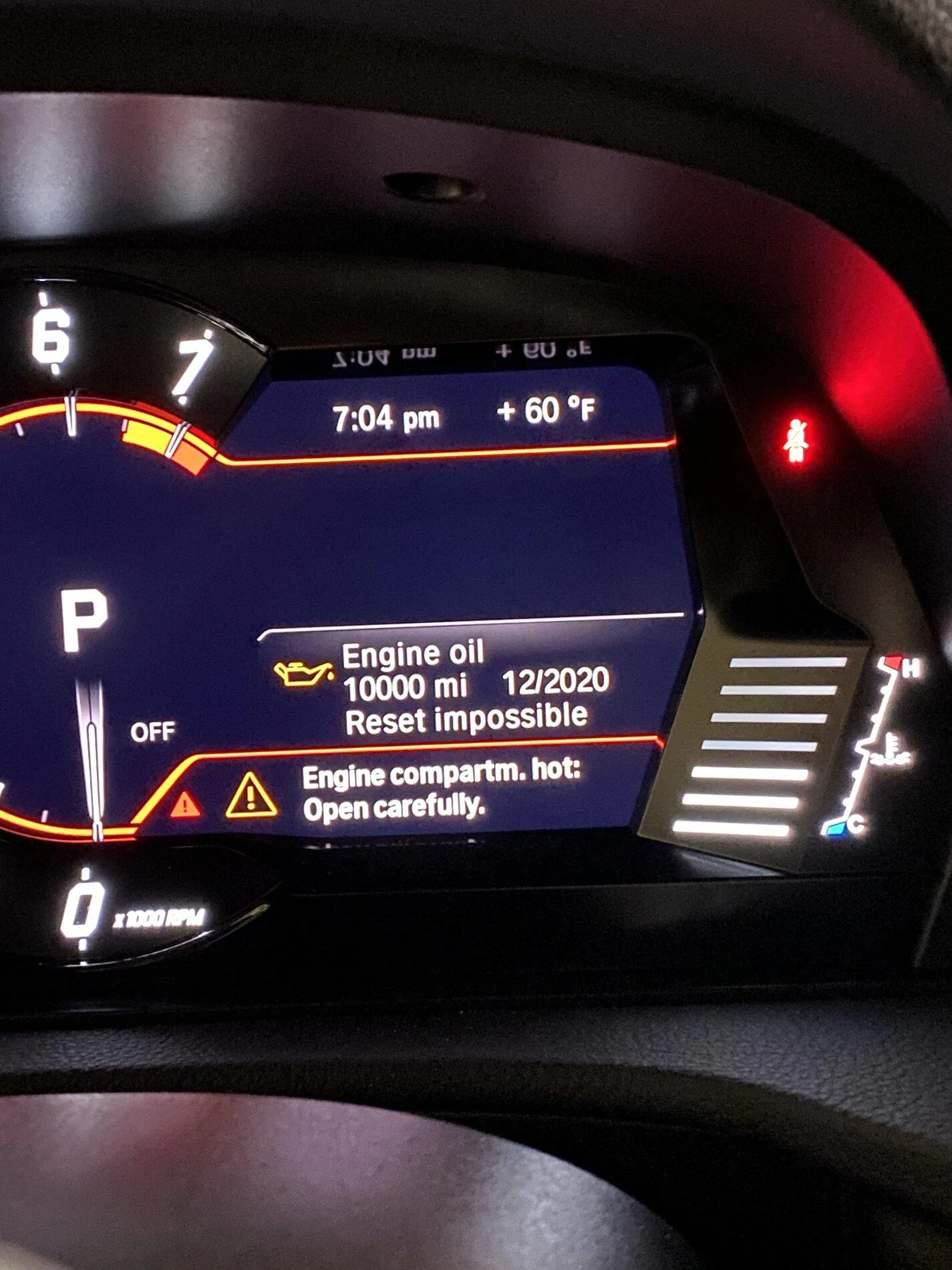

Car has only 600 Miles currently and maintenance light is on “10,000 miles and 12/20. I know low miles. Lol
I plan on doing an oil change next week myself and today I was unable to reset the oil maintenance light because it says “Impossible.” ?‍♂
I wanted to reset the oil light first bc it’s annoying as hell when driving it around with the maintenance light on.
Watched all the you tube videos but those always had a “possible” oil maintenance reset.
I know I haven’t hit the 10,000 miles yet but the 12 month time period has already passed.
I tried changing the date and etc. Still saying “Impossible.”
Oil level is fine as well when I go to measure it in the infotainment.
Anybody has any ideas? I seen people mentioned this issue in other thread with no solutions.
I did tons of bmw online forum search with no definitive answers. I really don’t want to take it Toyota.
My date and time is current in my car as well.

These Bimmer computers are weird about this, they have internal service counter flags, and if it's not set off in a particular way, it'll give you this "Not Possible" malarkey. The solution is to either wait until the service flag does get set again (maybe at 10k miles), or you can use one of the BMW Coding Apps to reset the oil light. I don't know if Bimmercode does it, but I believe the Carly OBD Coder has that functionality. No guarantees that it works for Supra though, but it does work on previous BMWs.

okay thank you! Right now, the oil maintenance light and service light is both on. Super annoying. I was going to wait another month to change my own oil. Only way I found to turn them off temporary is to dial back the date back to 1/19/20. lol
