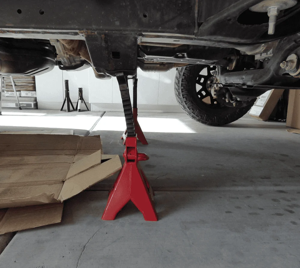

Don't trust your life to Harbor Freight tools.
My dad told me this for weeks but I'm thankful to have learned my lesson (and survive it) as a teen. Now I throw every jack stand possible underneath and always add a spare wheel or two.
