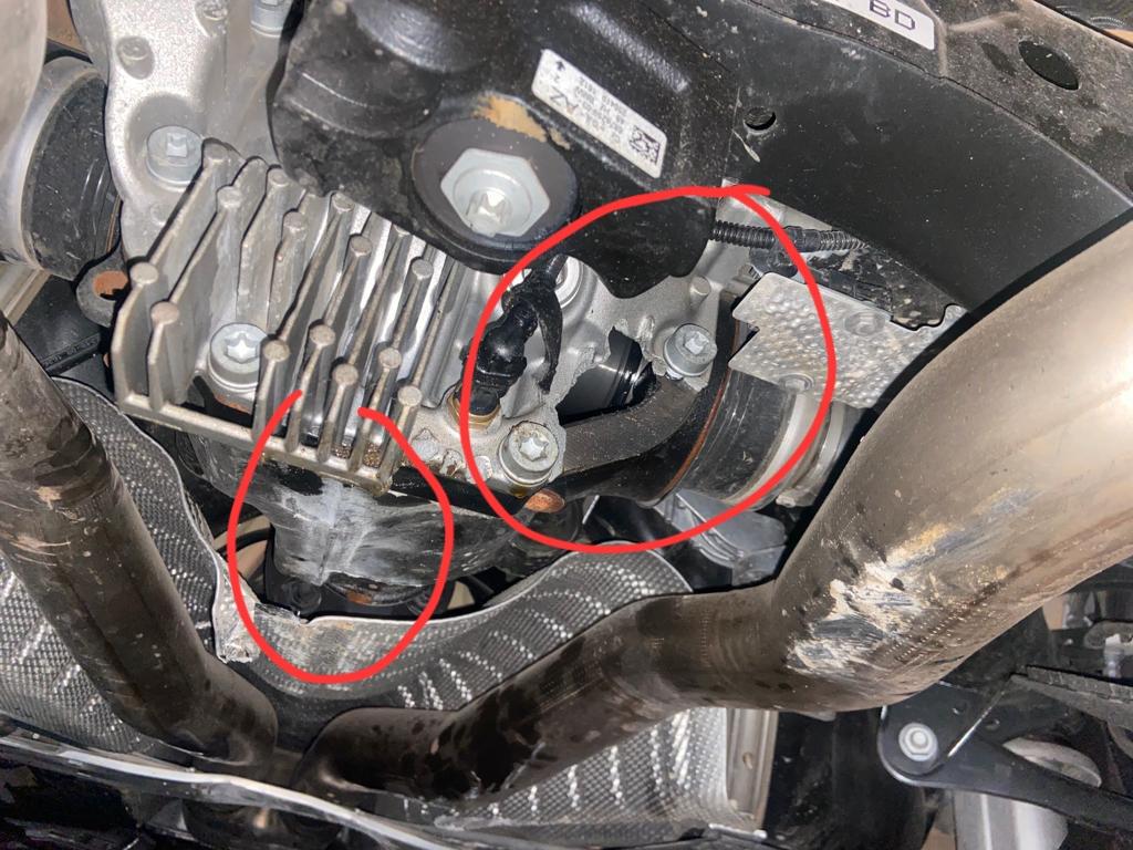

Oh right guys, so I recently changed the rear differential cover after it got hit and broke. So I went a head and ordered a new rear cover for the diff and installed it. i put new fluid on it and turn on the car and got a rear axle differential lock warning on the screen.( No yellow or red engine lights) . So we put the Asys on the car and these are the codes it got.
Codes:
-482BA6: Servomotor, actuation positive engine terminal and negative engine terminal wires mixed up.
-482BAB: Plausibility fault in servomotor movement .
After I saw the codes I went ahead and replace the servomotor and diff lock module to see if that was the issue but it did nothing. No changes after we put the new servomotor and module.
Is there maybe a fuse on the car that can be causing this issues? I want to see if i can check something else before I buy new differential.
Thanks for any help
The diff isn't really serviceable. If it got hit hard enough to break, it's likely broken internally. Swap it out.
This was the damage the differential took.
Question, How can I make sure this problem it is coming from the differential itself and not from something electronic? Because it seems more like a electrical problem than mechanical. I dont hear any noises coming from the differential.
Is there maybe a test i can do?
Thank you again for trying to help me out.

Thinking two things. 1st one is have you driven around enough to see if it just goes away? 2nd, if those codes were already there then something electrical was also damaged. Looking at the diff in the picture shows the electrical components attached to it. I doubt you can get that part separately. Also making sure the ground has good contact?
Bryan / Briana
4,770
9,623
Your moms bedsheets
You can.
Set positioning motor (the motor hanging off the side)
BMW: 33109894394
Toyota: 41400WAA01
Temp sensor
BMW: 3310784769
Toyota: 89429WAA01
Ground strap
BMW: 12428742822

Have you checked for proper power and ground going to the motor?
