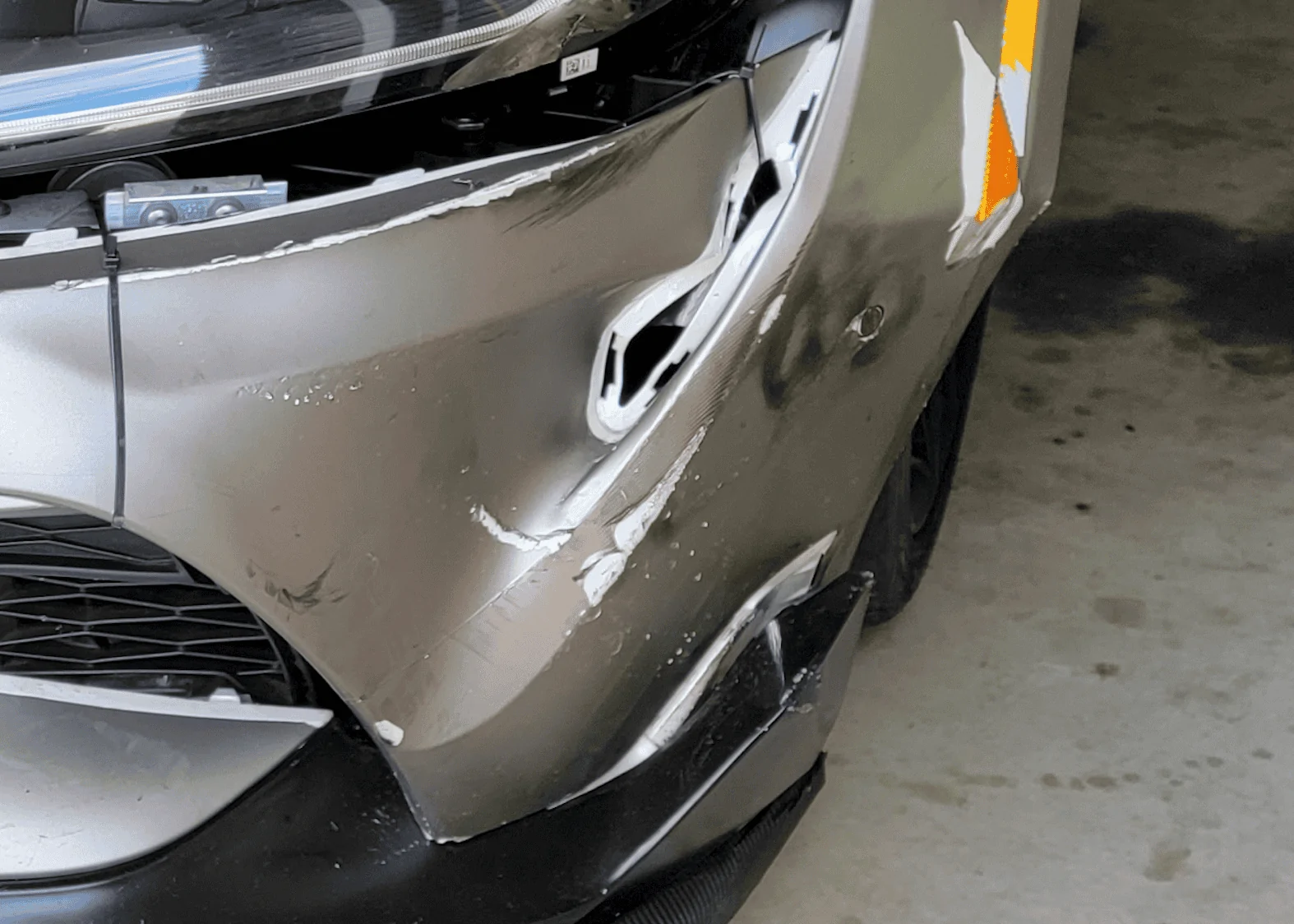

Typically, you will have to detach front bumper cover and headlight. However, if you can hire a very skillful RAM 5500 truck driver run you over in a very precise manner to crush open headlight and front bumper cover while parked. Drawback is, it may take you more than 2 months to get the car back. which is in my case, except I did not hire him. Hence I don't have information on detaching/attaching information of bumper cover and headlight.

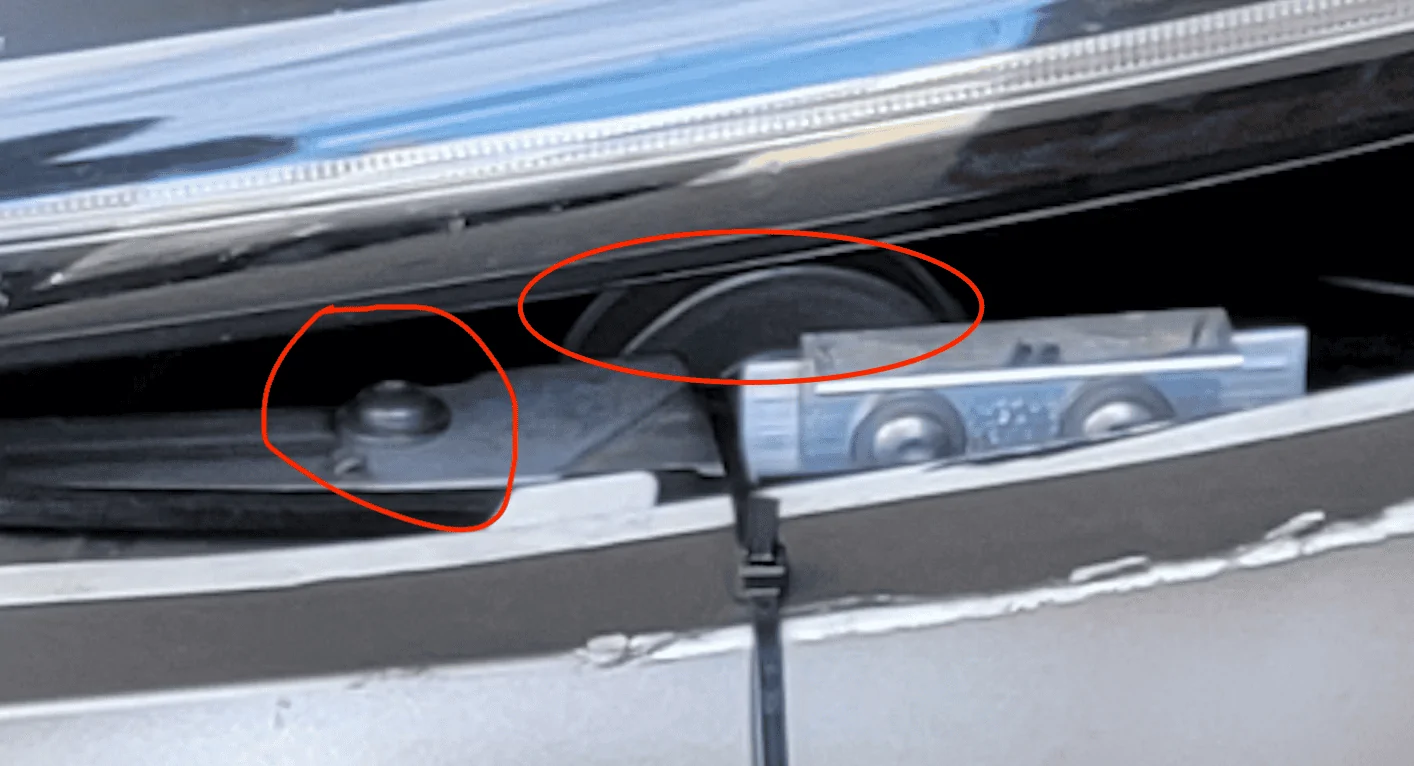

So once you have your bumper cover detached, you will the the horn and its bracket attached to aluminum frame.
so.. here's debate. there's only 1 torx screw holding the horn and its bracket. I was able to take it out without taking the headlight off but it would be much easier if head light was off. so pick your poison but if I had to do it again, I would chose to leave headlight because I don't want to adjust the headlight after re-attaching it.

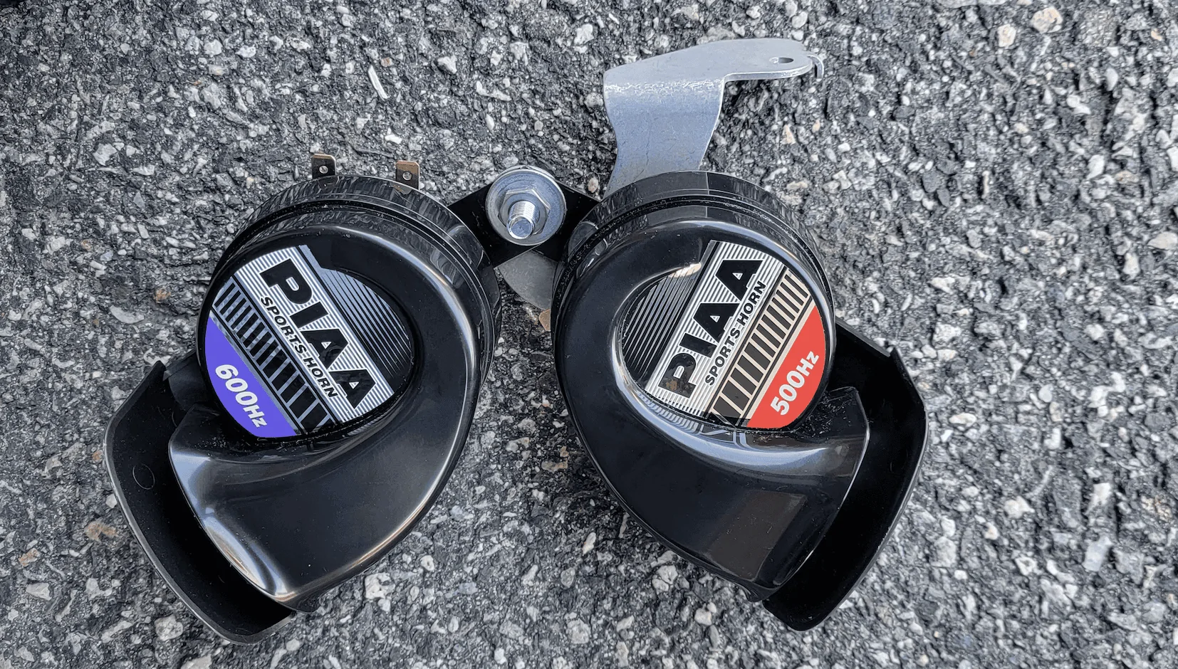

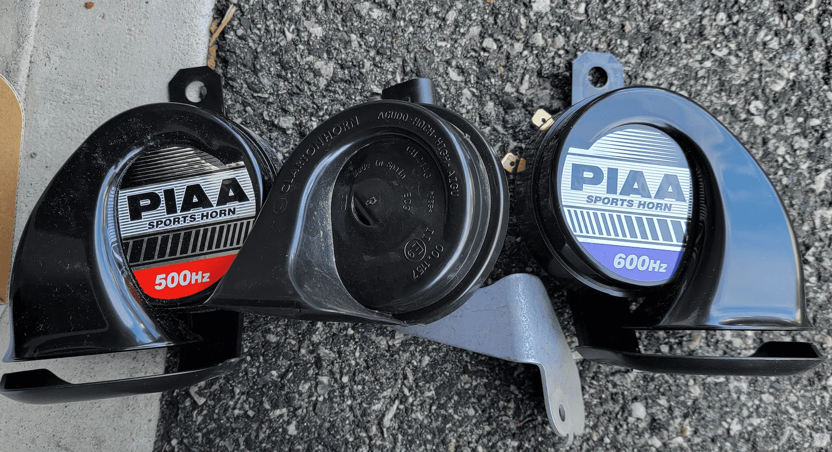

Before removing the Torx screw, make sure to disconnect the horn. Once it is off, use 13 mm wrench to detach the horn from the bracket. Here's comparison of horns.

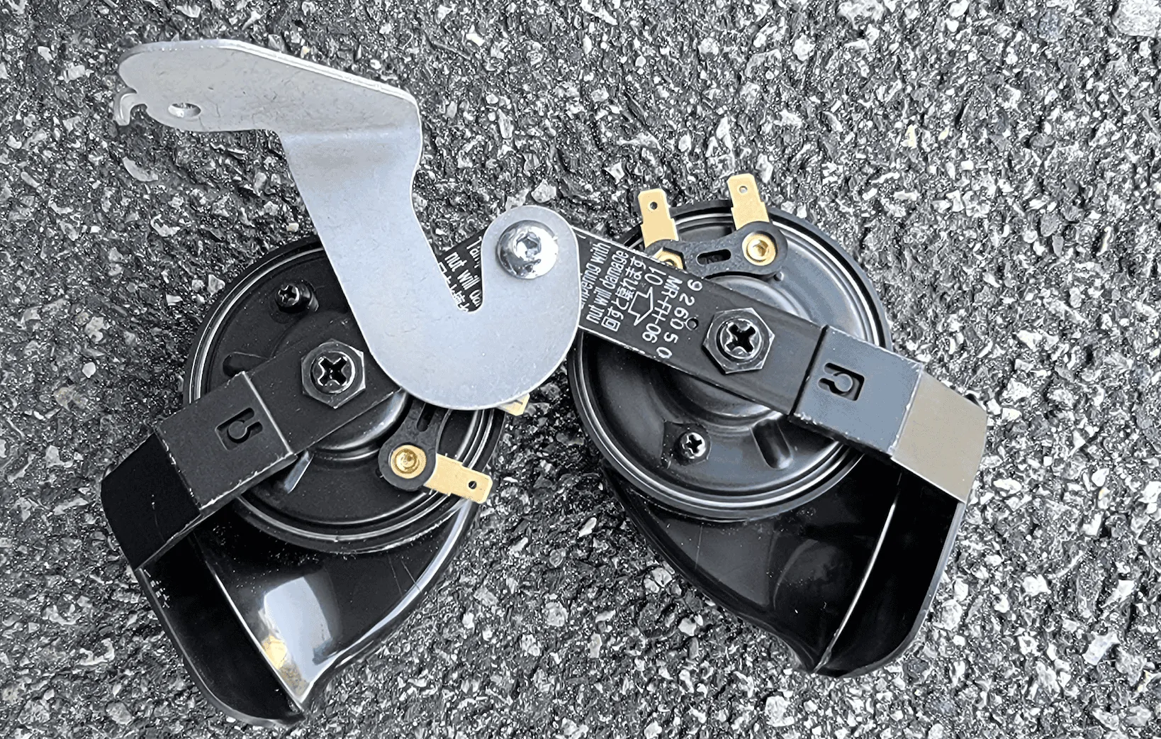

And then survey how much room you have behind the frame. initially, I thought I would not have enough room to fit 2 horns. but after much wiggling around, I found some rooms. And roughly arranged horns with the stock bracket. See below for front and back. I was able to source the bolt that fit the nut from original horn but if you don't have 2 buckets of extra bolts from other project, it might be better to buy a matching bolt and nut that fits.
at this stage, bolt is snug enough to move around and then I test fitted to make sure it is positioned correctly. once I'm comfortable with fit, I made sure the bolt is tight.

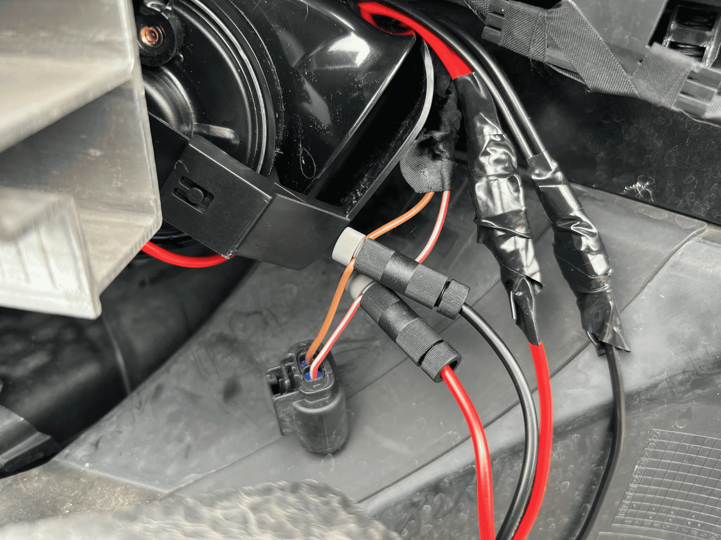

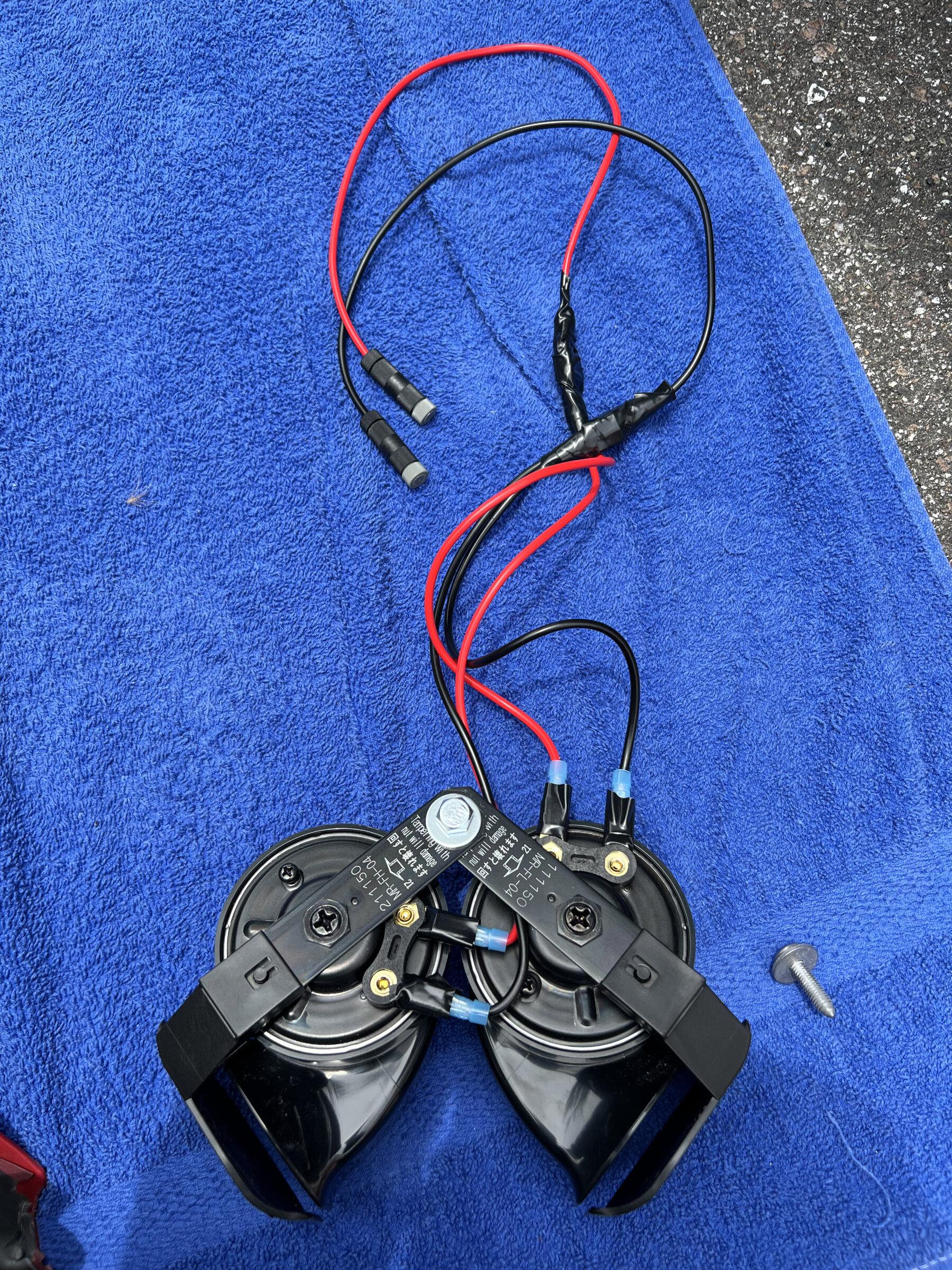

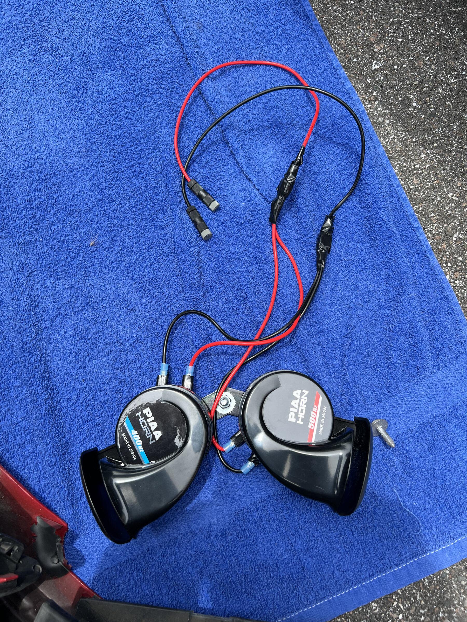

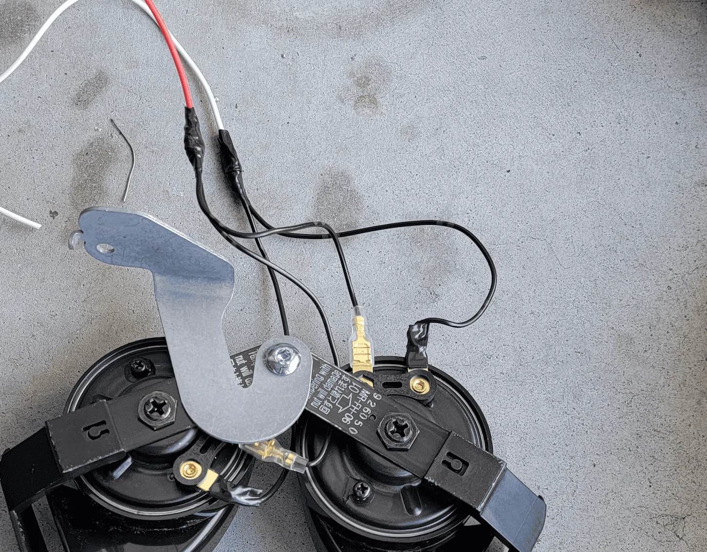

Here's the wiring.
PIAA Only supplied 2 strands of wire so I used connector on positive terminals and soldered the other connections.

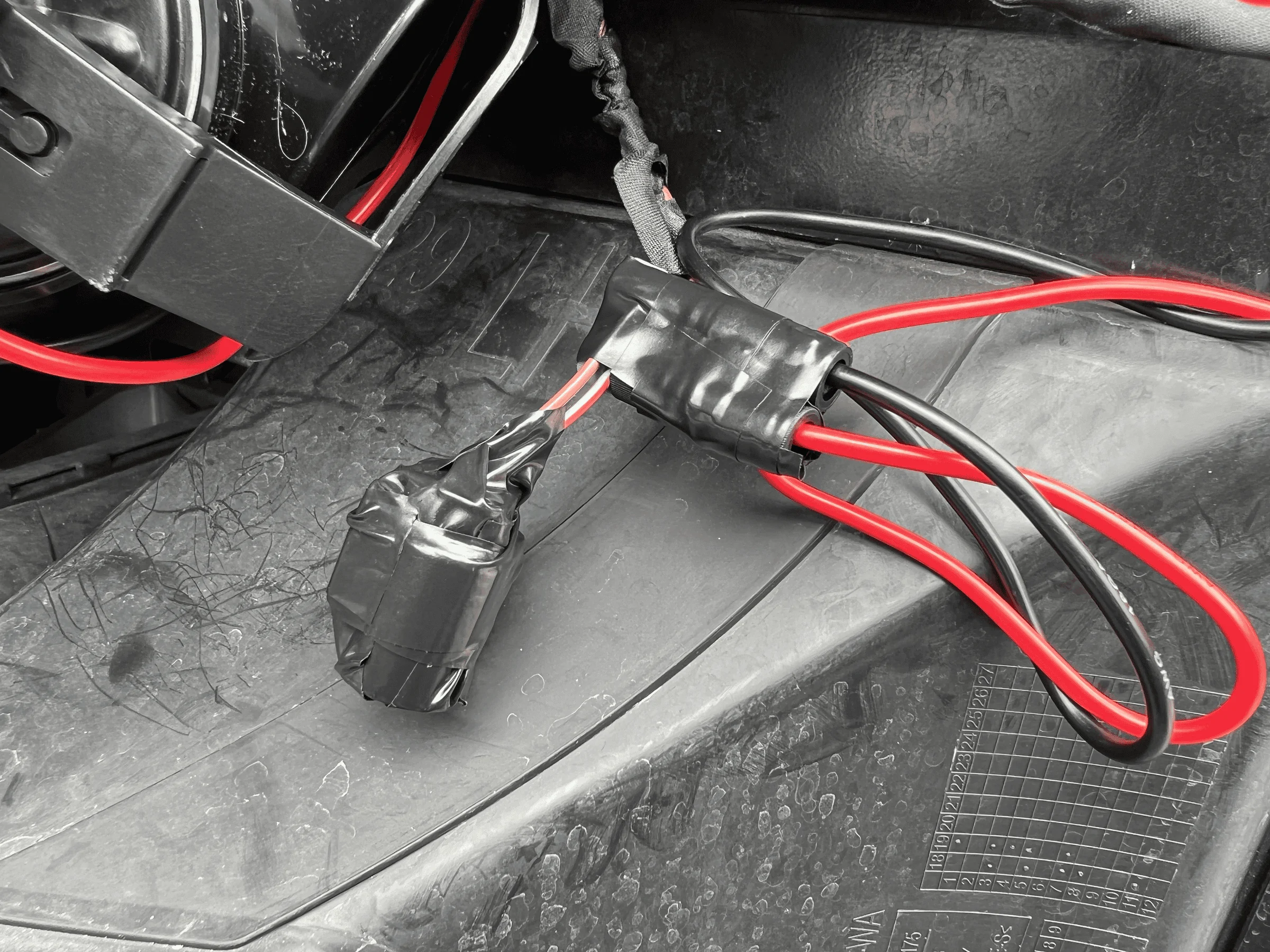

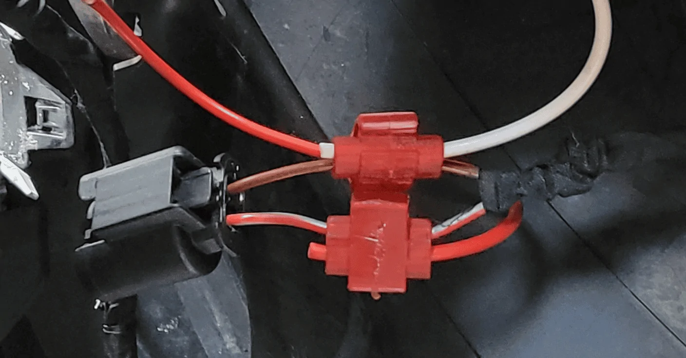

After re-attaching the horn to the car with bracket, here's what I did to connect from original wire. instead of cutting the original wire, I used tapping connector. I also taped the connector to prevent dust and moisture to get in.

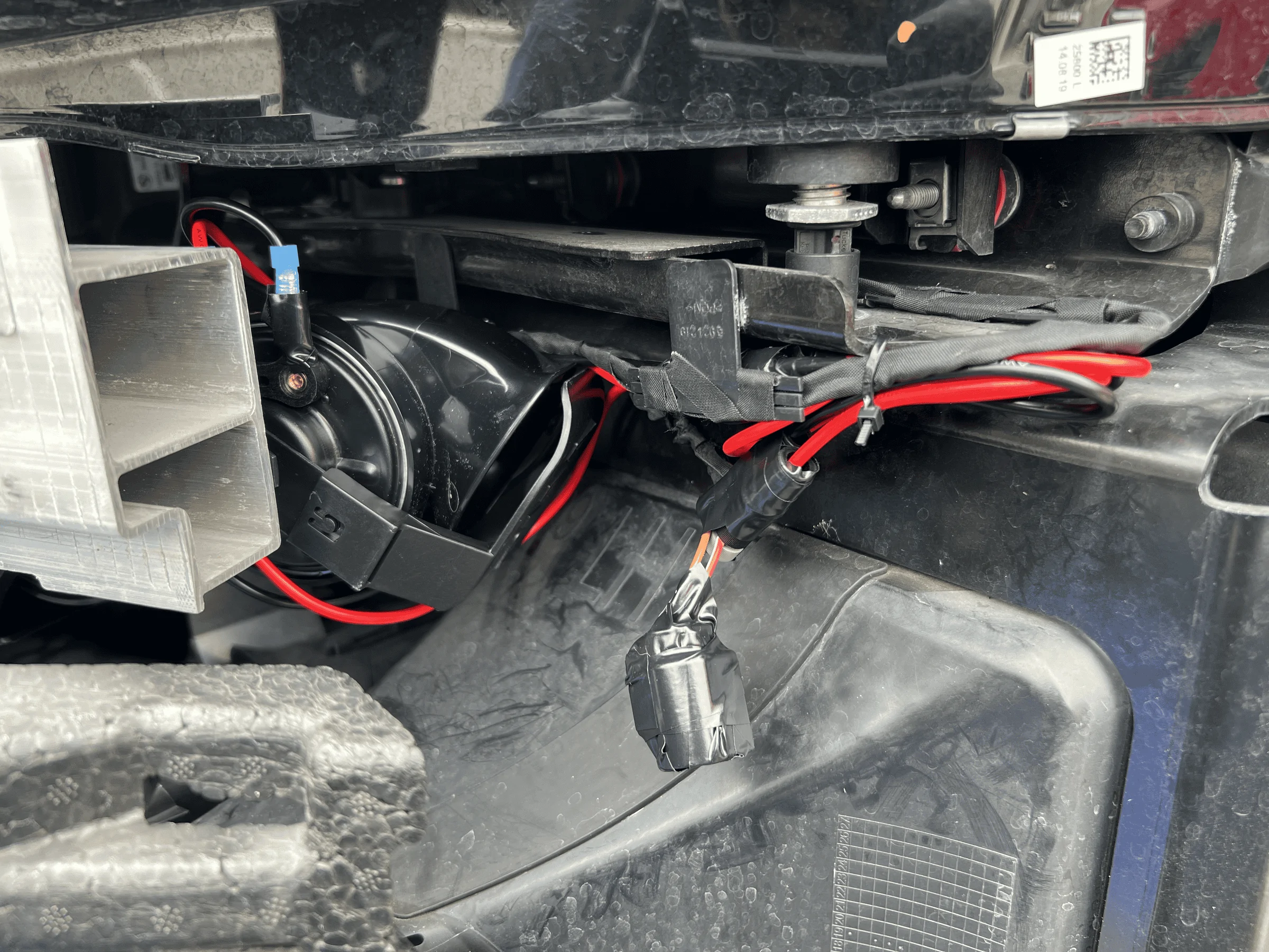

Thanks so much for the write up. I just completed this upgrade using your mounting and wiring as a reference. Sharing some photos for others who are thinking about this.
Notes:
  • I just took the two horns to Home Depot and sourced a nut, bolt, and two washers.
  • I grabbed 16 gauge wire, the connecters, and the posi-taps from Amazon.

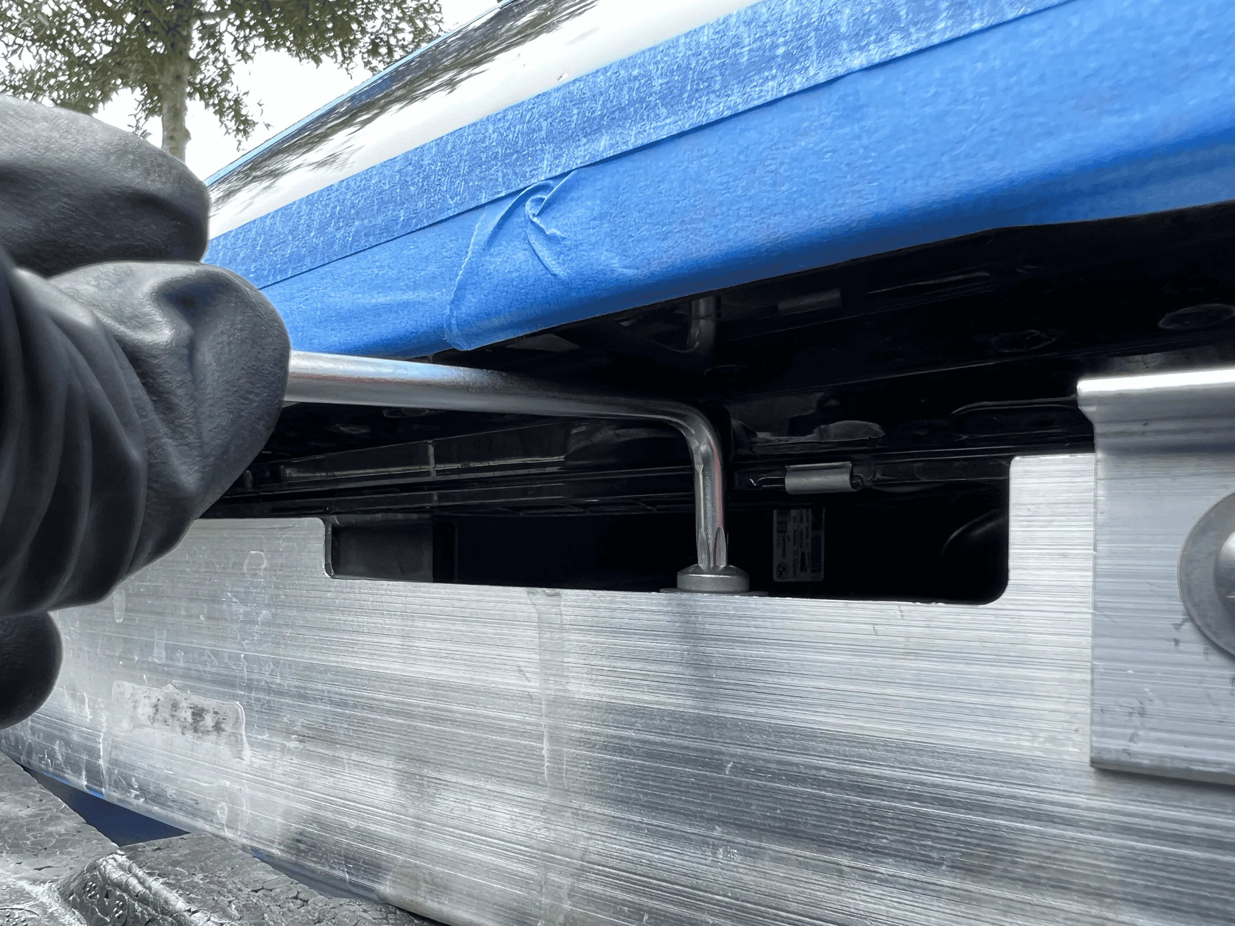

  • The bolt holding the OEM horn mount is a T30, and it's in a hard to reach location. Make sure you have a low-ish profile T30 tool in order to do this without removing the headlight (easier to just buy the tool).

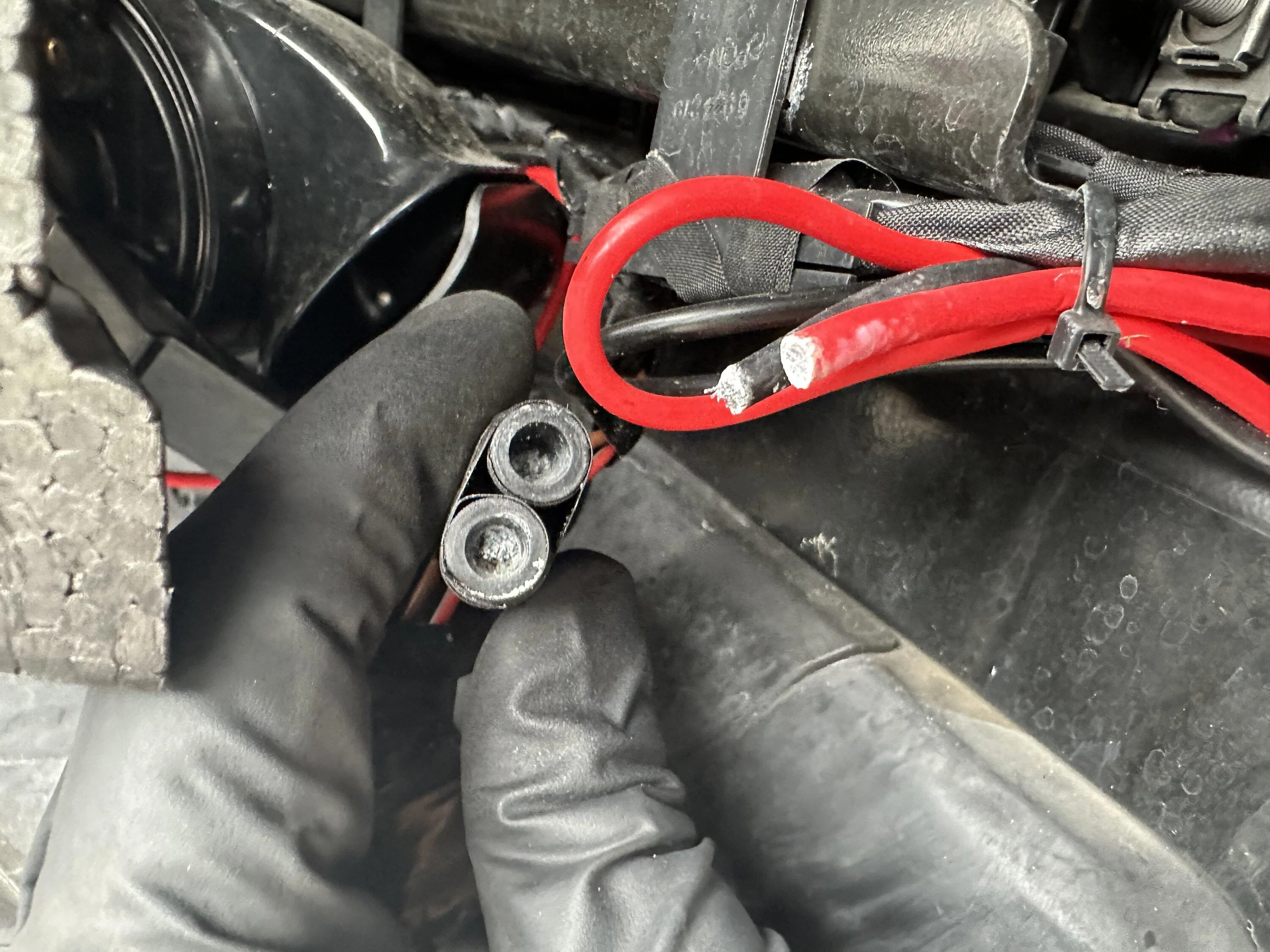

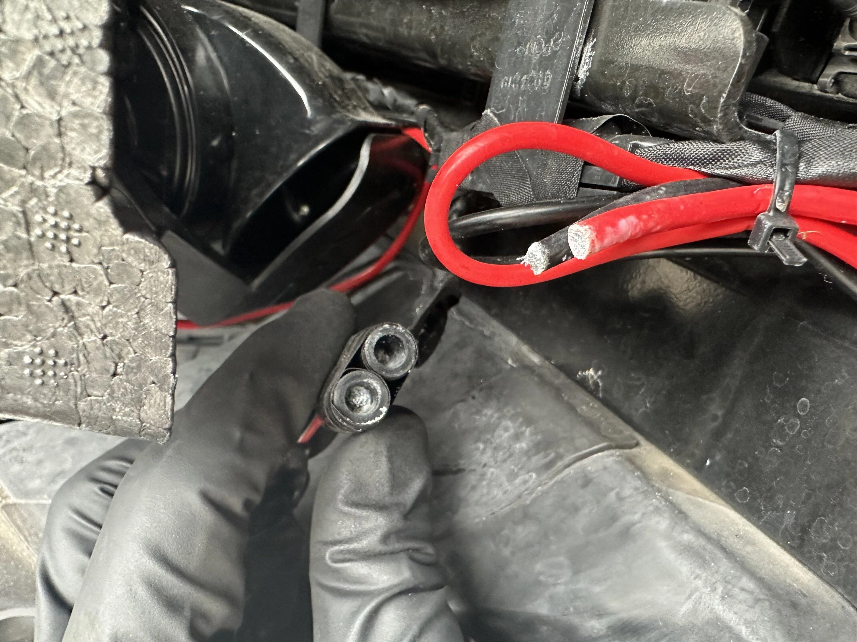

UPDATE: My wiring corroded?!
My (upgraded) horn stopped working last December, but I haven’t gotten around to troubleshooting it until today. My wiring basically disintegrated.
I’m hoping someone with more electrical knowledge than me can tell me what happened and how to avoid it going forward. My theory is that the wire corroded in the one spot I didn’t cover with electrical tape 🤦‍♂️
I’m pretty sure my wiring mirrors that of OP’s (refer to my quoted images).
Later, I’m going to check if my OEM horn still works or whether this incident caused other issues. (Update: OEM horn works fine!)

It's kind of hard to tell, but is that aluminum wire?
Lots of corrosion, I know.
It’s copper: GS Power 16 AWG (True American Wire Ga) CCA Copper Clad Aluminum Primary Wire. 25 ft Red & 25 ft Black Bundle. for Car Audio Speaker Amplifier Remote Hook up Trailer Wiring (Also in 14 & 18 Gauge) https://a.co/d/5o9QD7G
CCA is aluminum wire with a copper coating. Just an fyi.
TYMBOM
CJ
Feb 19, 2021
311
405
Alberta, Canada
A91, Trackhawk, Golf R
The problem is that moisture works its way up and inside the shielding. People use taps and call it a day. When ever exposing a wire, use liquid electrical tape to seal the insulation and wires.
