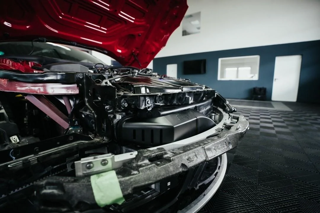

Cold Air Intake

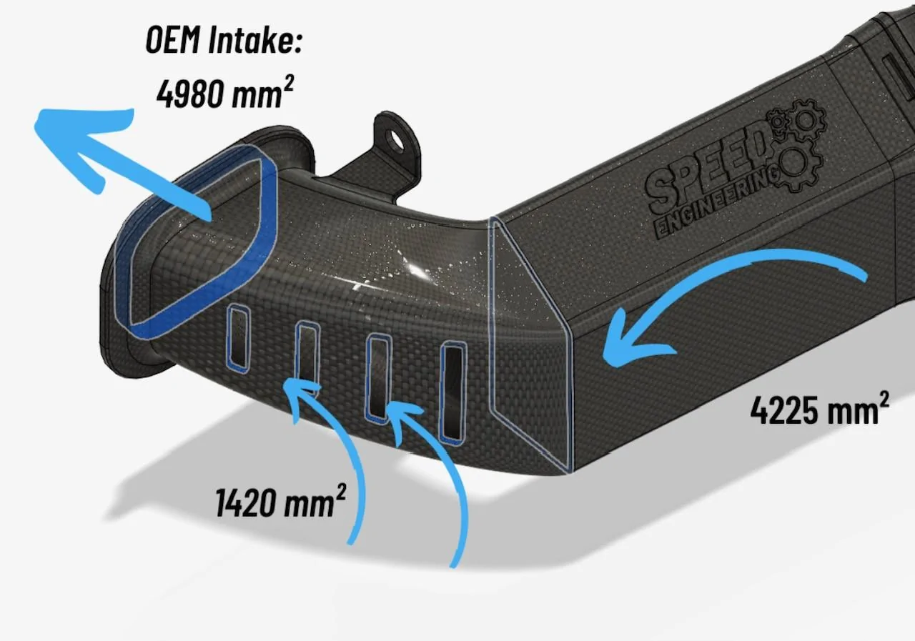

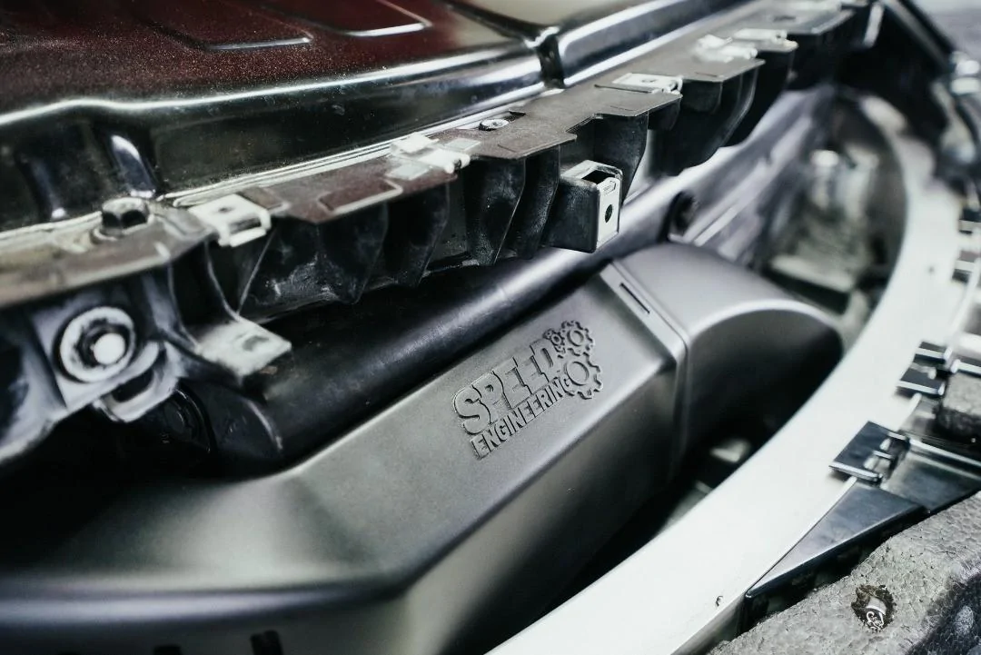

With this solution, we do not change the basic concept of the airbox and we have a reason for this: it works! However, what we are changing is the way to the airbox, because it has optimization potential. We use the overpressure area in front of the radiator, which is created while driving and grows steadily with increasing speed. In this overpressure area, we have placed an opening to not only pick up cooler air, but also more of it! Due to the overpressure, we push air through the channel, directly into the airbox. If the volume is not sufficient, we have placed further opening ribs so that there is never a bottleneck in the air volume, even if you significantly increase the performance of your vehicle.

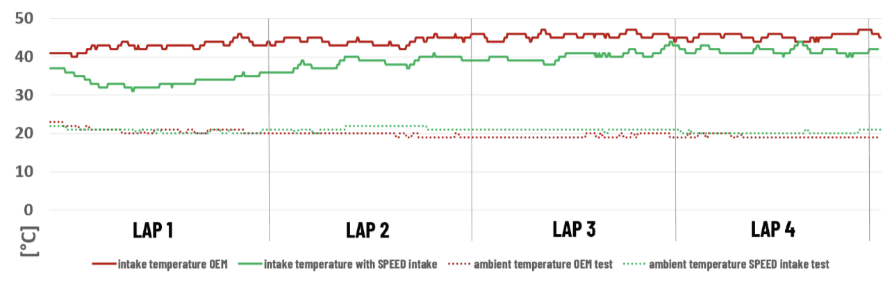

Measurement
B48 (2.0L) & B58 (3.0L) engines in the Toyota Supra have a lot in common: They are extremely sophisticated engines, efficient, optimized for low pollutant emissions, stable and both at the same time still have a high performance potential. In order to do something good for your engine, we have developed a plug&play intake kit, which we have put through its paces not only on the road, but also on the racetrack under extreme conditions.
From the factory, both engines suck in the air inside the warm engine compartment. Through an elaborately designed, non-restrictive intake channel, which moves the intake point to the front of the vehicle and allows the turbocharger to suck in the ambient temperature, we now achieve a significant reduction in the intake air temperature. Especially with high load and only average ambient temperatures, this is noticeable despite potent charge air cooling of the B48 and B58 engines. The best indication of Even after the maximum possible thermal load (extremely hot turbocharger, hot charge air system), the reduction remains clearly measurable with a further 5 degrees or 10%. Regardless of whether you drive on the racetrack or not, this reduces the thermal load of your turbocharger and engine and expands the headroom for potential tuning (lower knocking trend)
