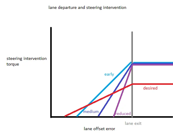

was really hoping this video would go into coding so we could CUSTOMIZE the strength curve of the force feedback, rather than just talking over a menu with 4 options 🙄
Are you talking about how much the wheel shakes and pulls you back into the lane? If so these can be changed already.
are you referring to a configuration that is NOT the early/late setting? if so, I'm all ears.

Switch to late and switch wheel vibration to light. Or just turn it all off.
Okay, so it seems like there's some disconnect. I want to adjust the torque response curve as a function of lane offset and lane yaw angle. The early late setting is NOT what I want, choosing between three pre-configured curves is not customization (I thought we were in the bimmercode thread?). Wheel vibration is irrelevant to this discussion for now.
From my experimentation, all settings for the lane departure feel like they get extremely aggressive as you approach the lane lines. I've sketched how I THINK the intervention torque feels to me.
OTOH, from playing with my wife's car, Hyundai seems to have dialed in lane keep assist perfectly. It comes on extra early and gentle, but doesn't fight you if there is a highway lane shift or an angled seam in the pavement. This is illustrated with the red curve here.:
