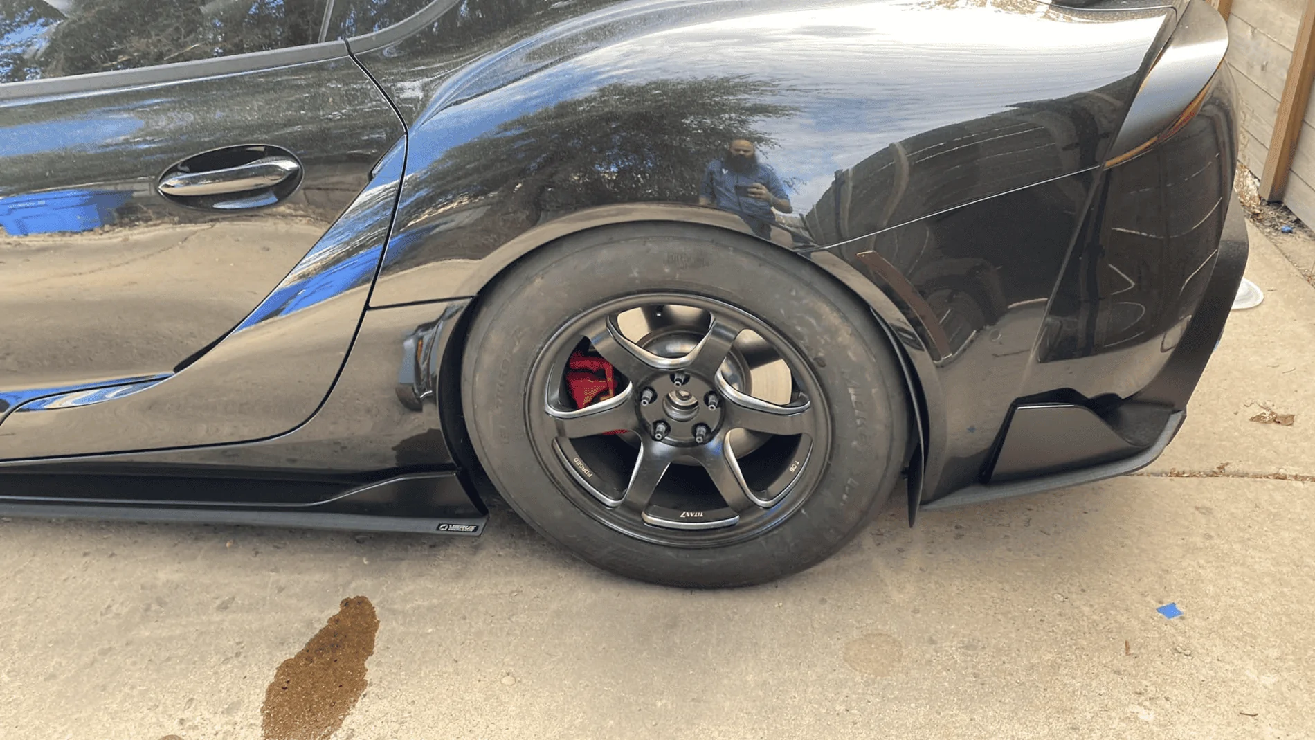

I've been meaning to do this for a while, so I figured I'd put something together.
I'll add some post-dated progress pics in the future, but as it sits.
Wheels and Tires:
- Weld Belmont 17s rear, 18s Front
- Mickey Thompson ET Street R - 305/45/17
- M&H Radial Front Runner - 185/50/18
Suspension & Brakes:
- Stock Suspension
- FCP Euro Stud Conversion Kit
- Evolution of Speed Line Lock Kit (w/ Steering Wheel Button)
- SPL Rear Drag Kit
Tuning
- Tuned by Payn on Ecutek
- PPE Bench Unlock
- 2019 BMW X5 ECU
Powertrain:
- Billy Mason Built Engine
- Evolution of Speed Turbo Kit/Xona Rotor 10569 X3C
- Kelform B Camshafts
- RK Titanium Track Exhaust - Passenger Exit
- Evolution of Speed Port Intake Manifold
- Evolution of Speed Icebox
- Verus Engineering Motor Mounts
Safety
- RaceQuip Harness/VAC Brackets
- Sparco Evo XL Seat & Brackets
- Titan Driveshaft Loop
- Titan Parachute and Bracket
- Motion Raceworks Parachute Handle
Fuel System
- Evolution of Speed Fuel System
- Snow Performance 1000cc Methanol Nozzles
- Misc Snow Performance/Vibrant fittings
- Vibrant Performance Braided Flexible PTFE Race Hoses
- p2uned Meth Bracket
- Injector Dynamics 1700cc Injectors
- Motiv Reflex
- AEM Methanol Controller
- 5ive Performance Reflex Harness
Drivetrain:
- Pure Drivetrain Solutions Stage 2 Transmission
- Pure Drivetrain Solutions Torque Converter
- DSS Carbon Fiber Driveshaft
- DSS Axles
- SPL Diff Bushings
Cosmetic:
- Autotecknic Carbon Fiber radiator cover
- Suvneer Carbon Fiber deck lip
- AWE Foiler Wind Deflectors
- Carbon Fiber front air dam replacement
- American Panda Design badges
- XPEL Prime XR Window tint - 35%
- Verus Engineering carbon hood louver
- Verus Engineering carbon poly weave side splitters
- Verus Engineering engine bay fluid cap kit
- Verus Engineering A/C Caps
- Verus Engineering gas cap
- Rexpeed painted front & rear reflectors
- Acexxon rear bumper reflector inserts
- A90Shop Carbon Fiber Hood Vents
- Autotecknic Carbon Fiber Mirror Caps
- Autotecknic sequential mirror turn signals
- Stickerfab taillight covers
- NV Specialties Carbon Fiber Bumper Vent Covers
- NV Specialties Carbon Fiber Rear Engine Cowls
- IND Rear Paint Match Reflectors
- Titanium Works Misc
- Downstar Misc Dressup
Misc:
- iPhone Mounted w/ ProClip
- Uniden R3 Radar detector
- Mirror Tap
- Titanium Works Engine Cover Badge
From The Factory
Current Form
