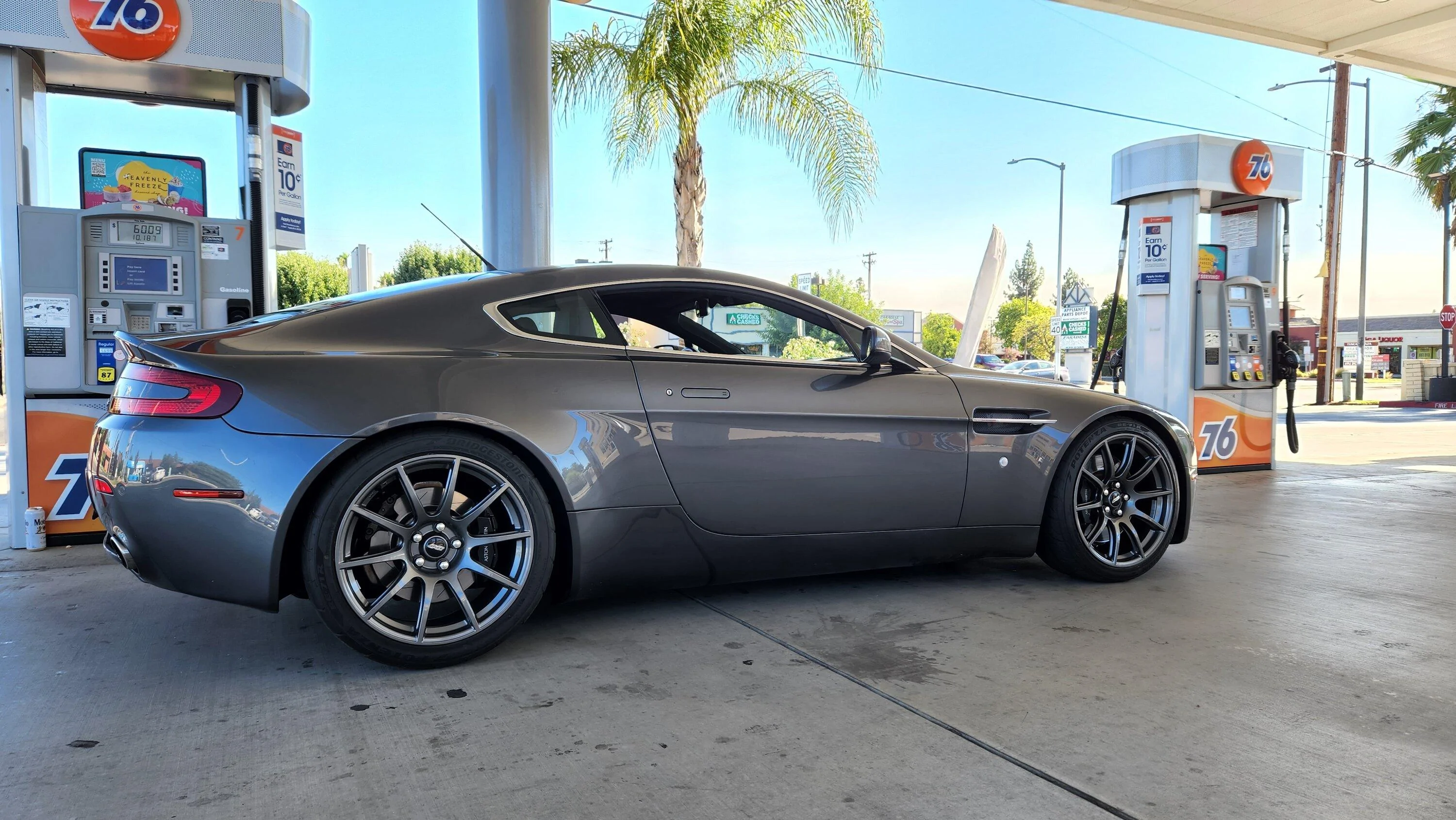

Also, on a kind of related note, we should have a OEM+ SM-10 option arriving in a similar timeframe to the current existing Supra SM-10 fitments thanks to development of a G20 3 series BMW wheel. The bolt pattern and bore are identical and the incoming BMW wheels will be 19x9 ET28 front and 19x10 ET38 rear. The plan is to have them available in Anthracite, Race Silver, and yes... Satin Black. Perhaps not as optimal for those looking for a wider setup, but these are a few mm more aggressive front and rear than the OE wheels and should be a solid direct bolt on fitment for those content with factory or +1 tire sizing.
I don't have photos of this fitment on a Supra yet, but its going to sit 4mm further out up front and 2mm further out in the rear than the factory Supra 19s. Here's a brief look at our sample set if you guys don't mind BMWs.

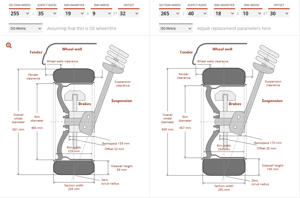

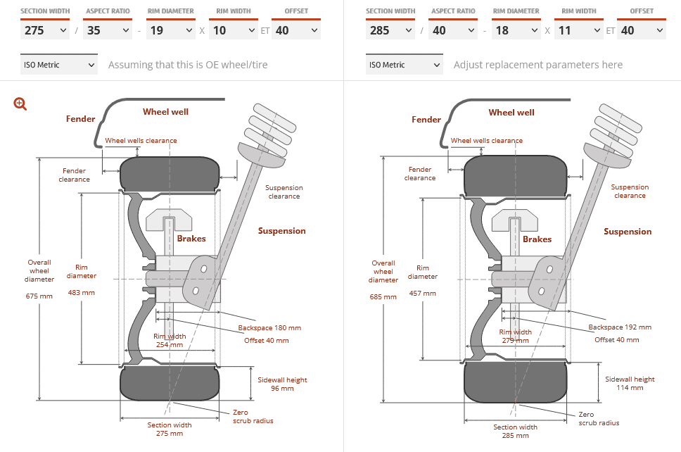

@APEXRaceParts : So the October target is the expected date for those of us in the group buy on the VS-5RS 18" staggered sets to ship?
Also for those interested and looking at the sizing guides... there are a couple "unicorns" which will give a slightly taller setup (but not requiring spacers I think). These are the ExtremeContact Sport model from Continental. They are the only tires I'm aware of available in both 265/40-18 and 285/40-18 sizes - if you're looking for just a slight gain width and height over stock.
The difference on the fronts will be 4mm taller (total 8mm larger diameter) and the rears would be 5mm taller (total 10mm larger diameter). Probably not as wide (especially in rear) as most would like, but another option that shouldn't rub anywhere and provide a bit closer fitment than wider 35 aspect tires will get.
Fronts:
Screenshot 2022-08-16 at 21-05-05 Rim & Tire Size Calculator. Custom Offsets.png
Rears:
Screenshot 2022-08-16 at 21-02-55 Rim & Tire Size Calculator. Custom Offsets.png

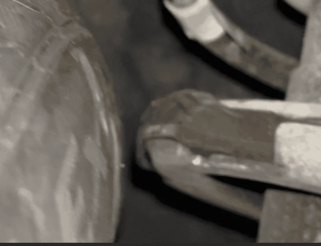

Correct, October ETA for the 18" VS-5RS shipments in all finishes.
I believe a prior customer ran the 265/40-18 contis on our 18x10 ET30 up front. Clearances were tight, but the tire did clear the spring without spacers:
-Tom
