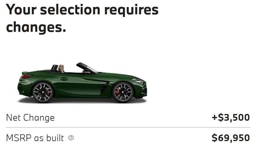

I will still be very surprised if the manual Z4 sales figures get anywhere close to 50% of the manual Supra sales. It's only going to be available as part of a $3500 upgrade package... so $70K MSRP (or more depending on other options). Even if you don't opt for the limited edition color... it's still essentially the same price.
I'm sure there are some dedicated Z4 fans that will cheer it's release and rush to order. However, I'd guess that any that aren't 100% committed to a Z4 specifically, are already included in the number of MKV MT sales. Many aren't likely to pay the premium just to have a soft-top, BMW branded version - when the hard-top non-BMW branded version is lighter, faster, and ~$10K less. I certainly could be wrong, but we'll see in a year.
I’m waiting around as well to hear the sales figures. That’s too much for a z4 6MT unless you are a diehard fan of the platform. A lot of YouTube online trolls in MKV 6MT videos commenting about “being better off” waiting for the Z4 6MT instead. We’ll find out if they put their money where their mouth is. I said it before and I’ll said it again, the MKV is the most misunderstood car in automotive history specially by purists.
