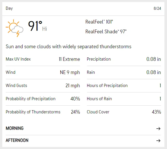

To 5w/40 because it’s been running 100 degrees lately where I live.

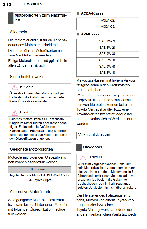

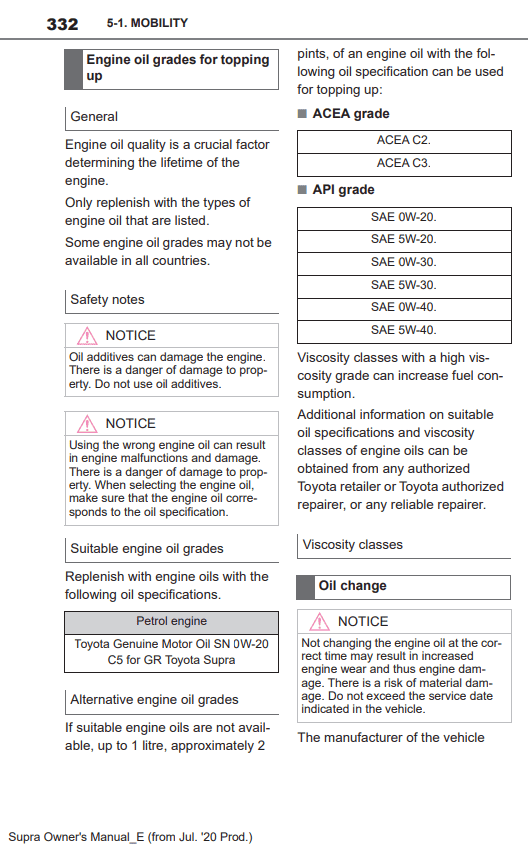

5w-40 is listed in the Europe manual.
Thanks, realized I spoke before searching:
Found a very nice thread/post on it:
https://www.supramkv.com/threads/toyota-gr-supra-owner-manual-navigation.1845/
Deleted my initial post but not before you replied lol.
Anyways from a Europe manual (MY21, B58TU1 or updated motor):

Does anyone use this heavier oil in there
3.0 Supra? …. Manufacturer says 0w/20
I’ve been using 5w/30, thinking of switching
stay with the the 5w30, you'll be fine.
- miami resident

The EU manual reads to use only up to 2 pints for "Topping Up" using other weights, but reads to only use 0W20 for full service / oil change.
