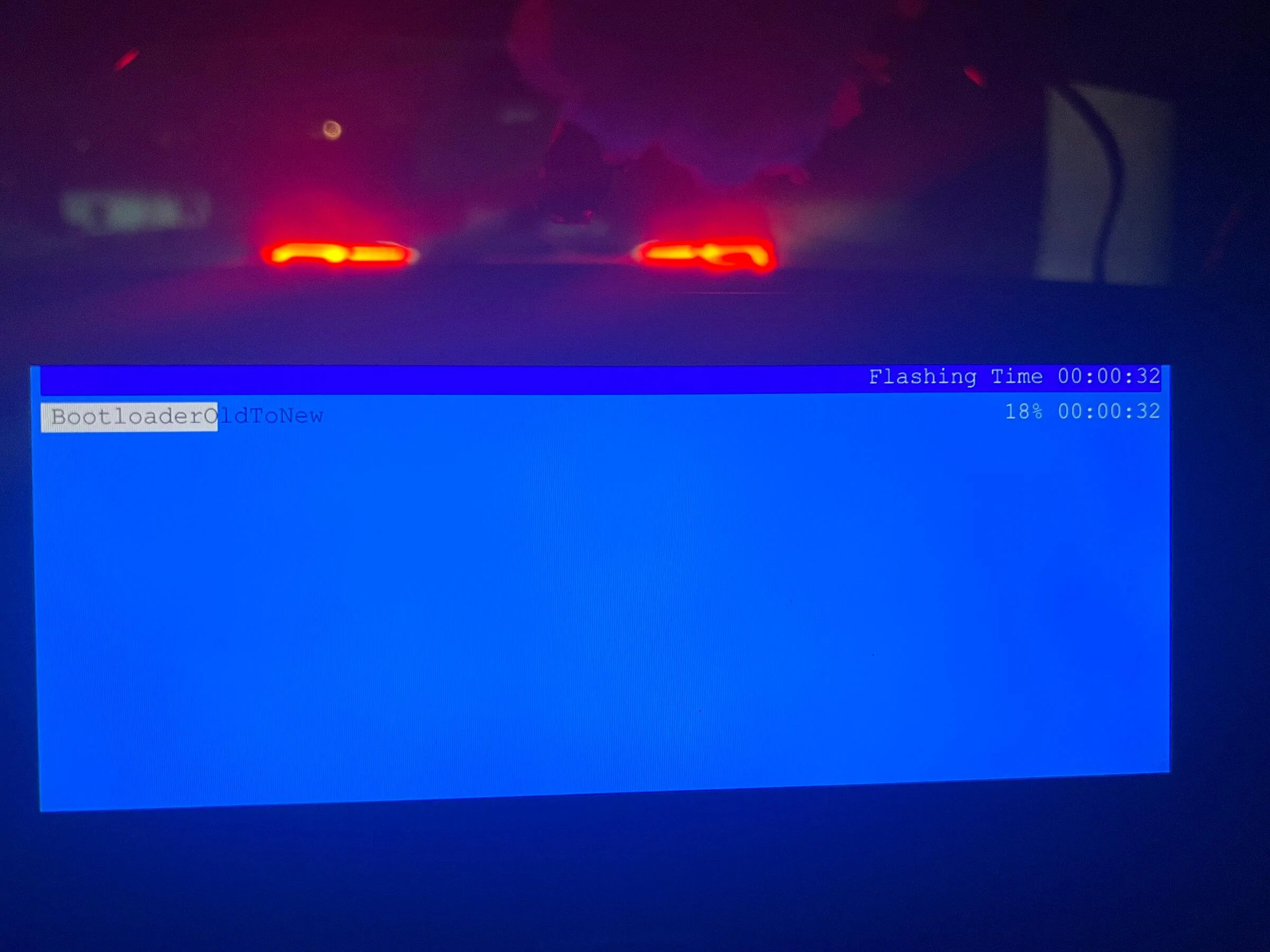

Did this today, was relatively easy. I just installed GTS Techstream from here: https://www.toyota-tech.eu/DiagnosticTools/Software/GTS though and that worked fine too. Had to buy a license through the EU site but it was only 30 euros that way (one 20 euro subscription for a week, and one 10 euro license for a week). Took about an hour and it definitely whinges at you about battery charge! You also have to wait quite a while for it to scan the car for the first time.
I also didn't need to alter the action plan despite my amp being missing and ASD disconnected. ISTA reported all as working fine.
I then had to bimmercode back what I wanted and re-set my quick actions in the 1-8 buttons next to the volume knob.
Hopefully this latest i-level sorts out throttle hesitation as has been reported in that thread. Certainly didn't happen to me again in the same circumstances that it had done before, but we'll see over a longer period.
