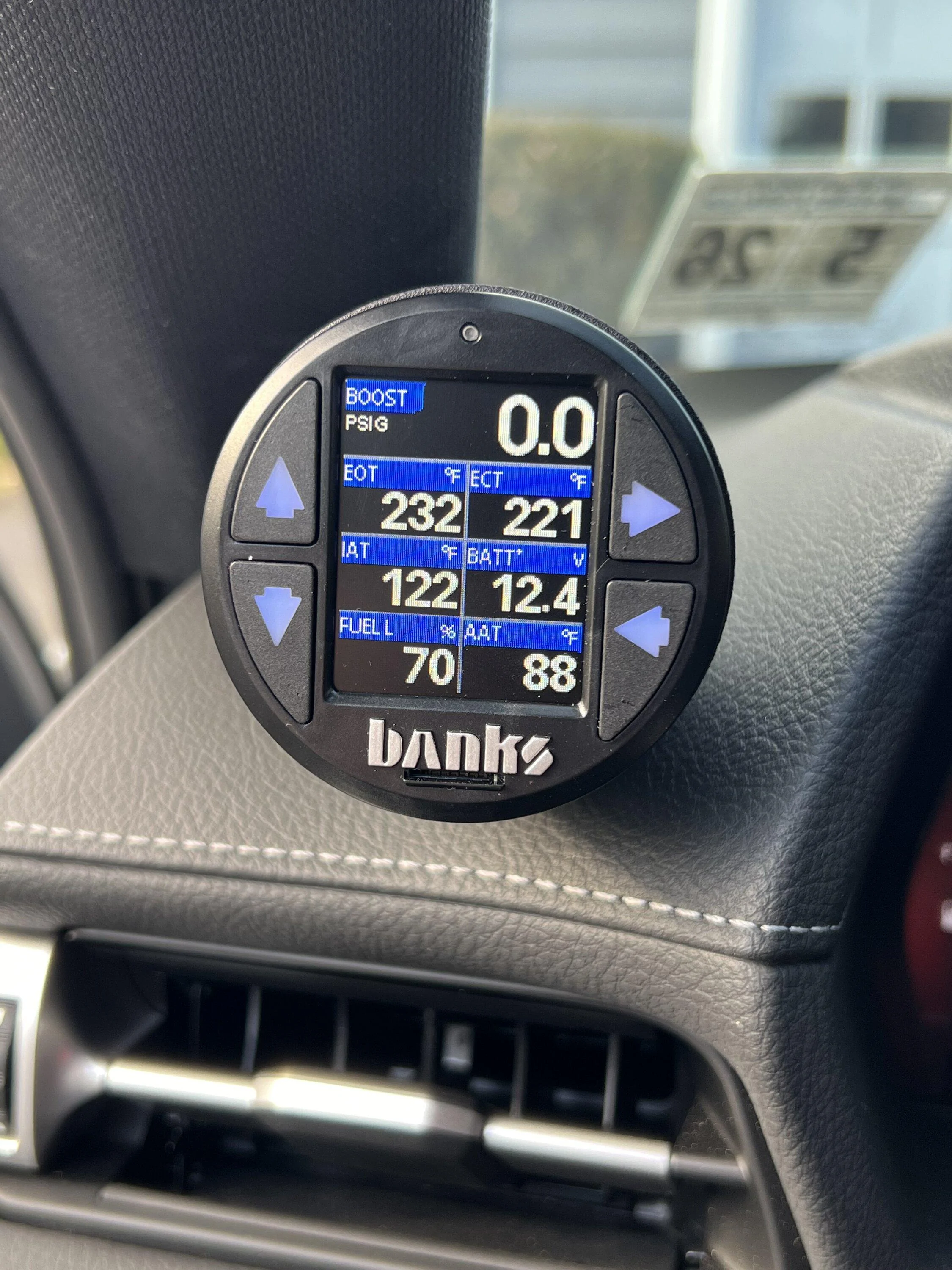

Is the Banks idash easy to use and has it been working fine for you??? Any review as I noticed on the Banks website no BMW or GR Supra options to choose on their site.
Yeah, like @Thraxbert said, it just plugs into the OBD port. I believe that if you have one of the mentioned vehicles on the Banks website, you may get additional data available for display, but for the Supra, you get all the main things one would want to keep an eye on - no issues.

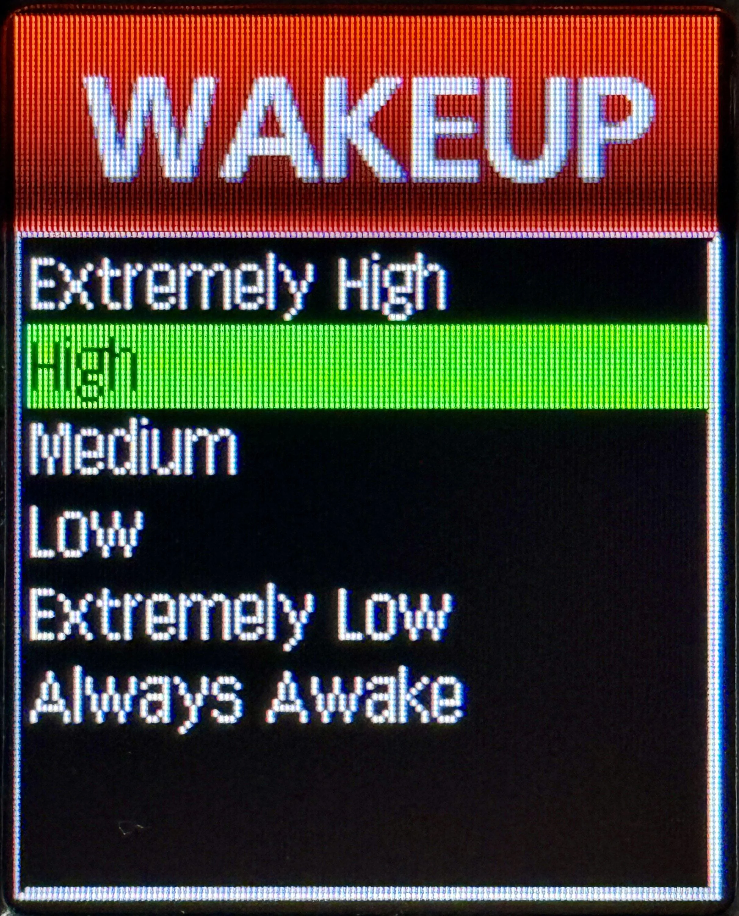

I love mine! However, sometimes it doesn't turn back on after restarting the car. And sometimes it displays a double dash "--" under all parameters when it does come back on.
Those without any issues, what are your vehicle settings and wake settings? I've got my auto-start/stop turned off via Bimmercode, so I have that set to normal.

Have you changed your wake sensitivity? I had the same issue. Had to move it to whatever the highest setting is (as in top of the list).
I did. These are my current settings. Should I change it to 'extremely high' ?

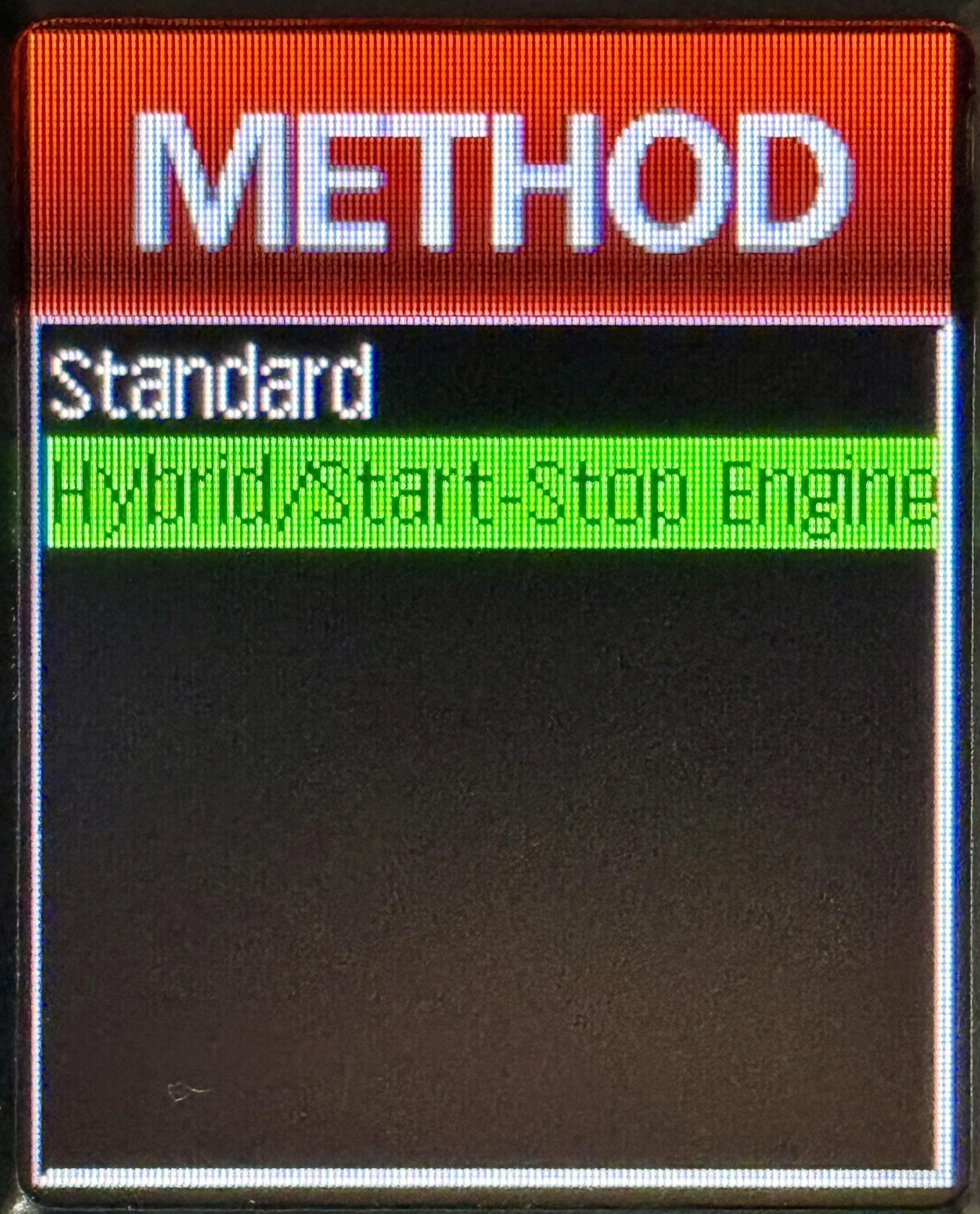

Also, I was told by others to change from 'standard' to 'hybrid/start-stop'

I believe mine is at extremely high (after testing “high”).
I don’t think I messed with the start/stop, but I also have that bimmercoded to just remember the last setting (so effectively disabled because I don’t like start/stop).

Ok, I'll change it to 'extremely high' and see how that does. Thanks! :thumbsup:
Yeah, I also have my 'start-stop' coded to remember the last setting via Bimmercode, but I don't know if that setting really does anything in this case.

I just had this issue today of the gauge shutting off and changed my settings like yours. Also had to kind of bend the tab so I can take it off the the plug. Hopefully this works

Did you leave the 'standard' setting or change it to 'hybrid/stop-start'?
