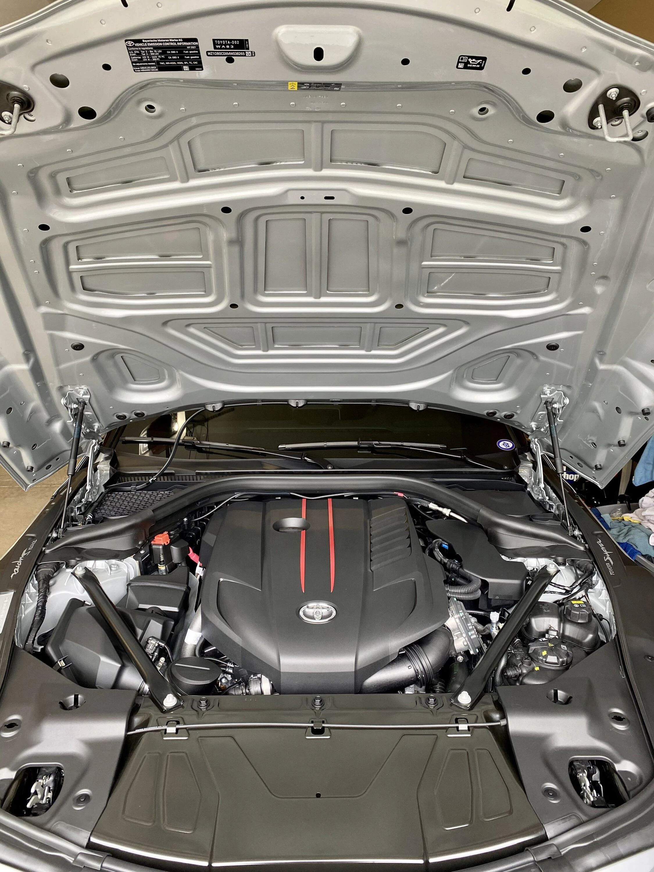

How do you guys keep/clean your engine bays?

Clean it. ;)
I use the shitty old microfiber towels and detail spray of choice. Granted mine never gets too dirty. Is yours a mess?
Mine isn’t a mess but wanted to get an idea of how to clean it in advance for if and when it does get a bit dirty

Depends on severity. I keep it clean regularly so I just use the same shampoo as the paint. Add degreaser via spray bottle on tough spots and let sit for a minute. Agitate gently with a soft bristle brushes to move crap out of hard to rinse spots.
Do not apply cleaning products on hot parts or in direct sunlight unless specifically told to.
(do as I say, not as I do <3)

Actually I keep the engine bay tidy at all times using micro fiber towels and quick detailer, and some Aerospace 303 for plastic and rubber parts. It's like cleaning the toilet.. if you keep it clean all the time, cleaning itself is not difficult.

I simply go to a quality .25 diy carwash. It’s all about the pressure of water. I use one that has higher pressure than most (some act like a garden hose - crappy) .… wash with the soap selection … then rinse with the water and dry as normal. No added cleaning chemicals are needed.

APC to clean, rinse, then add a protectant of your choice. Some protectants are better than others at not attracting dust. Less is more usually when it comes to using topper products. After that it's easy to maintain with a quick detailer.

I’ve personally never been a dressing person for the engine… just collects dust most of the time (same goes for the interior). Leather conditioner… yes.
I like the simple clean look of a wash and dry in its natural state.

On topic... I clean whatever cap I'm unscrewing to add oil/coolant/etc. but beyond that - you could probably plant a garden on my engine cover at this point. 😓 Some day I'll get around to that... I promise.

Ya I stopped cleaning my engine bay unless I'm going to a show. To much dust and dirt where I live.

This is what I do with our other vehicles when the oil is draining:
1. Spritz water on all reachable components, and wipe off with a microfiber towel or paper towel. Repeat for interior plastic components.
2. Spray rubber protectant on a cloth or paper towel and wipe down all rubber hoses and hood seals. Continue with door and trunk seals.
3. Clean seats with leather conditioner and a microfiber towel.
4. Protect leather with Zaino "Leather in a bottle" for an amazingly realistic leather smell.
The above assumes that this cleaning process occurs at least once per year. That's why most of the unclean surfaces have a light layer of dirt and/or dust on them. Heavy-duty cleaning is not required.
