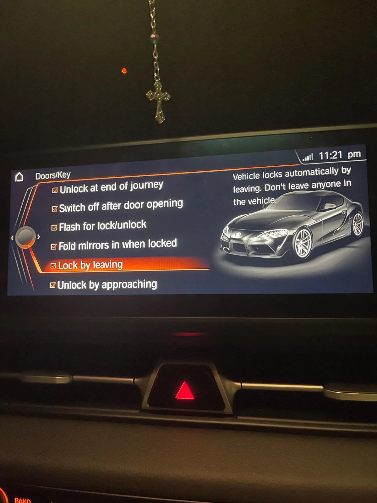

Did the contactless coding and everything is working correctly.

Can someone who's done this post a screenshot of the selection(s) in the head unit, after this has been coded?
