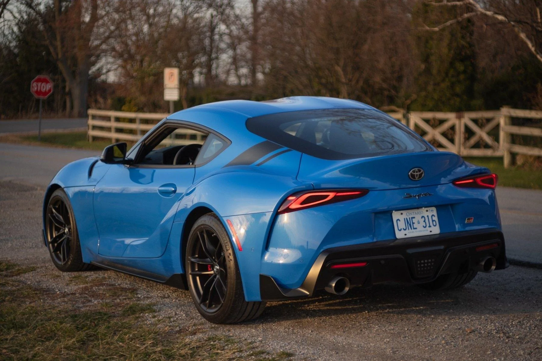

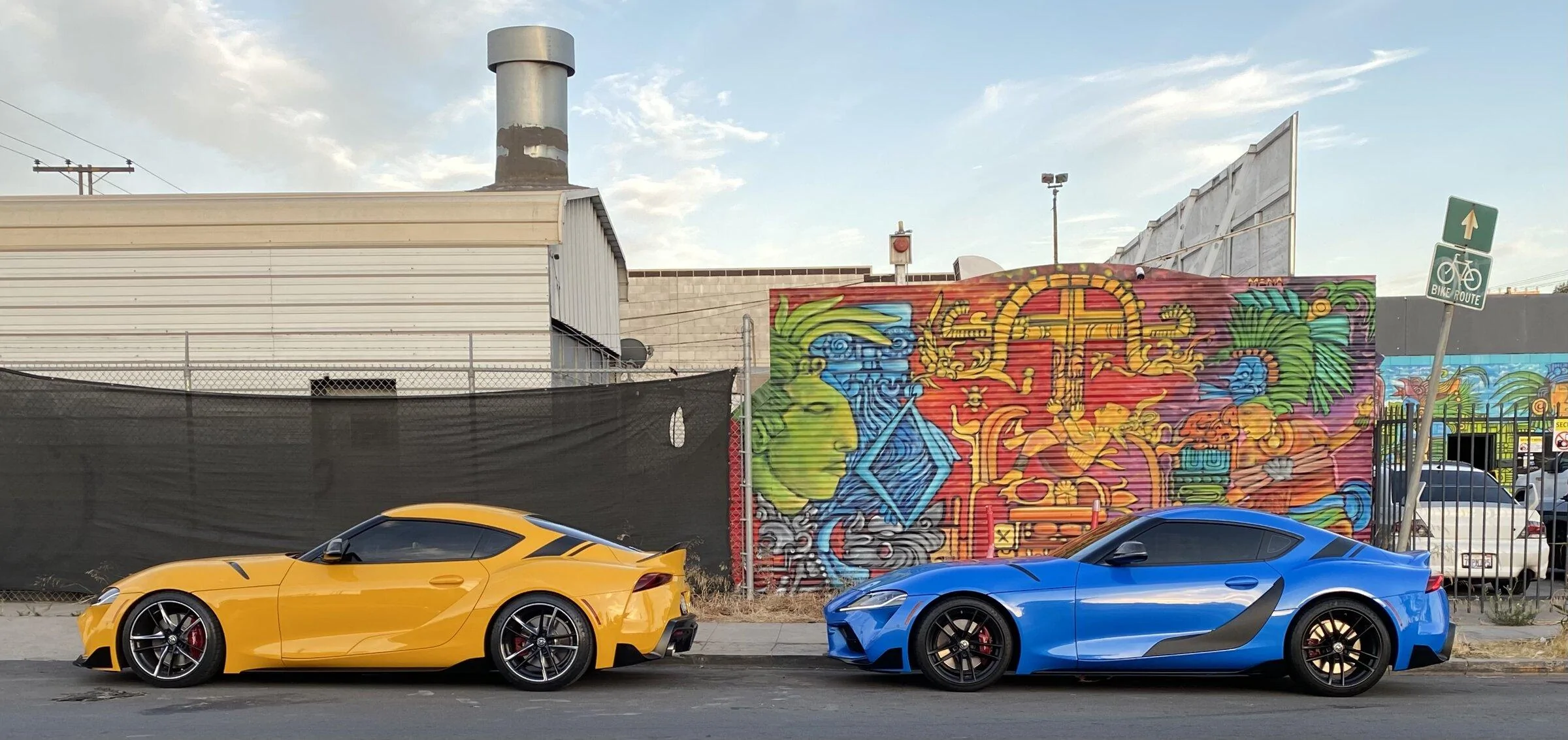

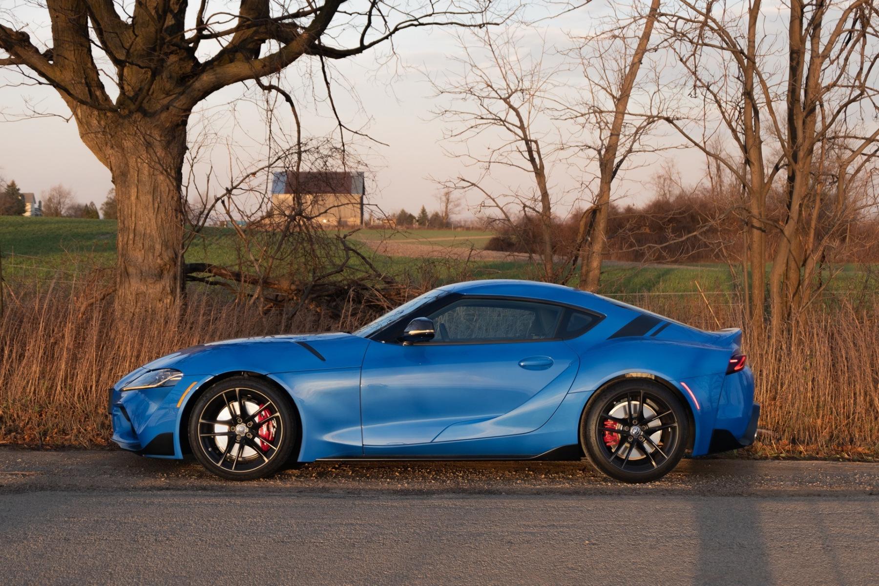

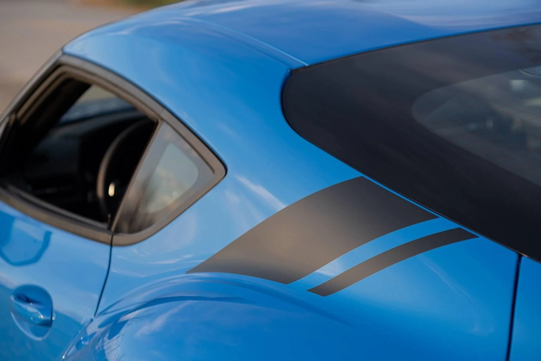

I believe about 4" & 1" wide. It aligns parallel to the edge of rear side window as well as door garnish almost as if the line continues from door garnish to the vinyl. if you are using knifeless cutter, cut the vinyl from back to front for obvious reason.
link below should give you some idea.

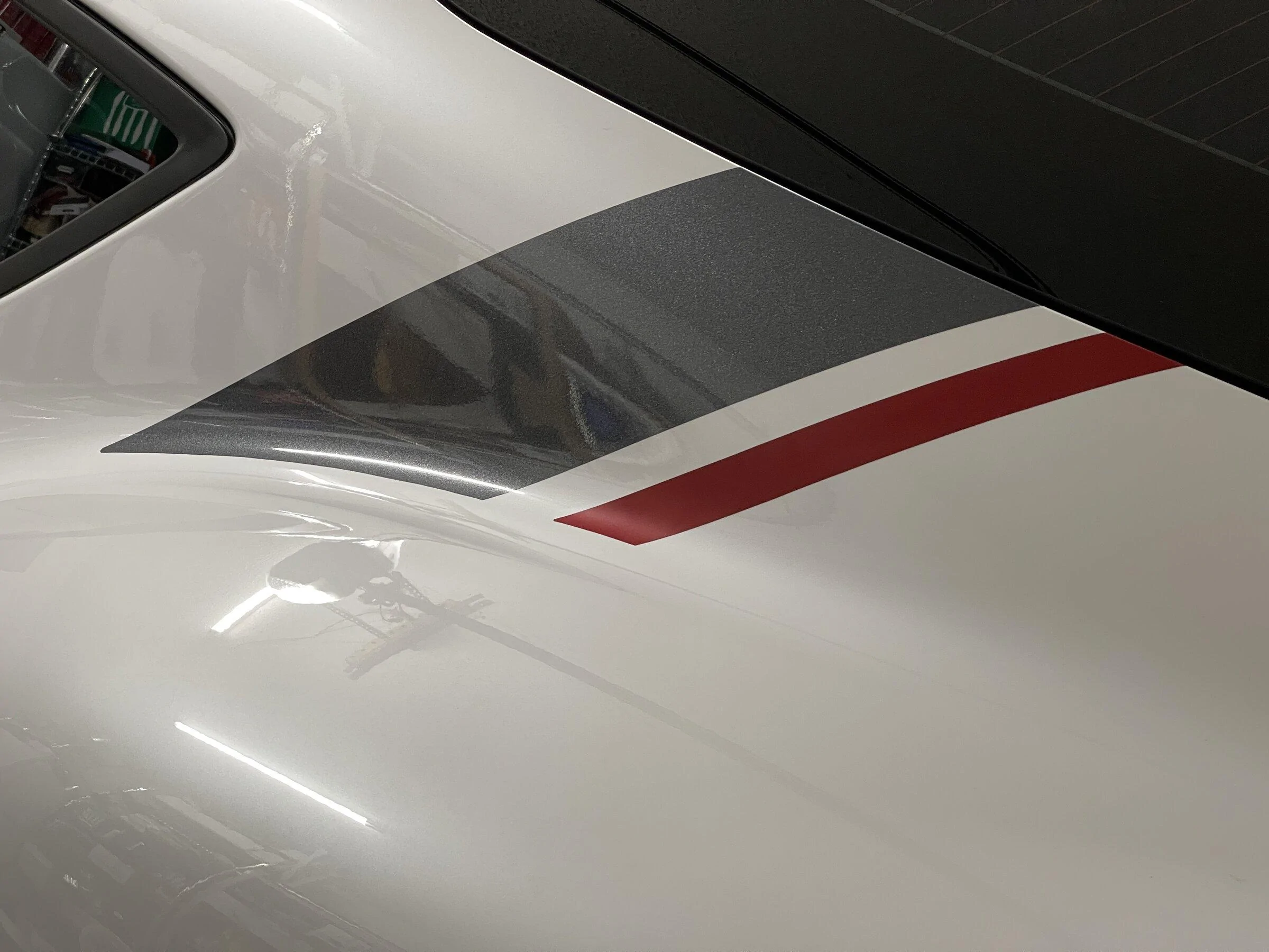

If you're already willing to measure/cut. lines are parallel to the body. 3rd pic should give you an idea where it ends..

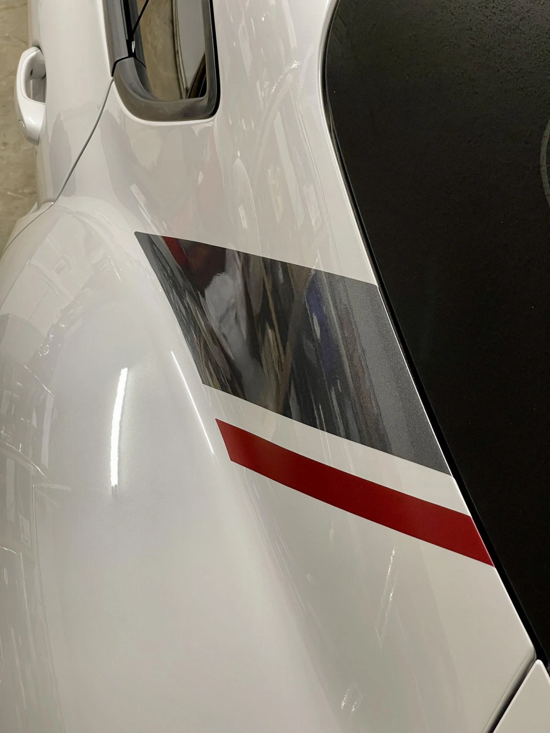

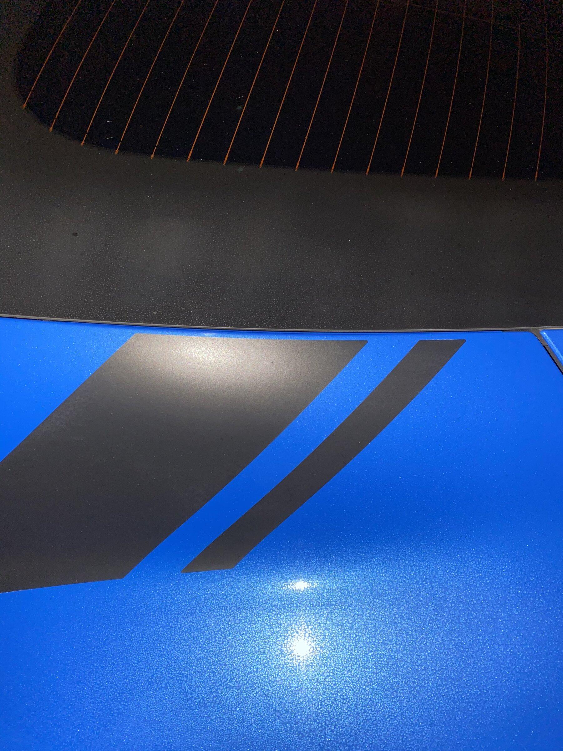

I compiled a bunch of photos from different angles when I cut my own from a graphite metallic and dark red metallic vinyl.
I also made sure they overlapped over the ridge by the rear hatch glass.

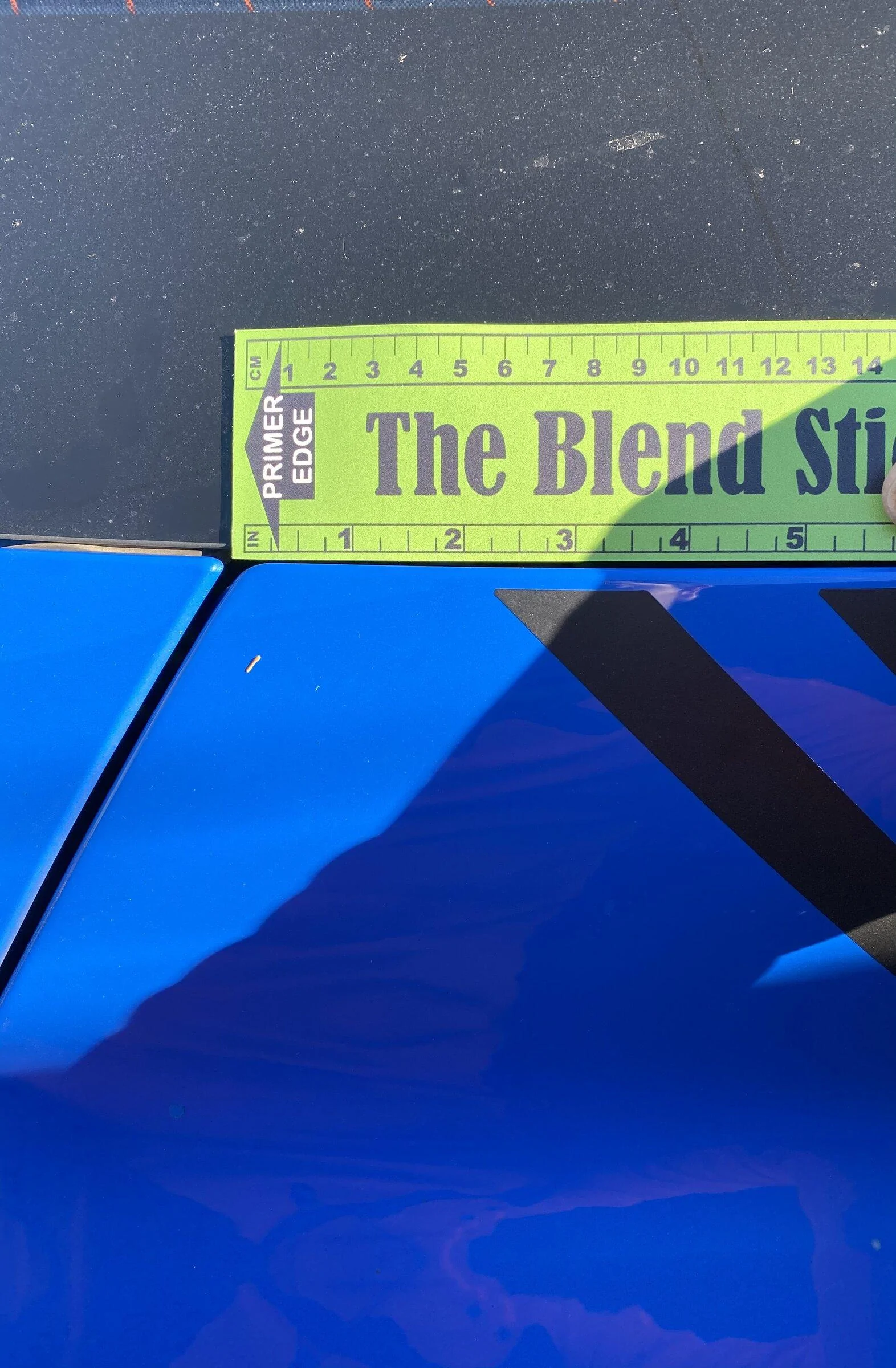

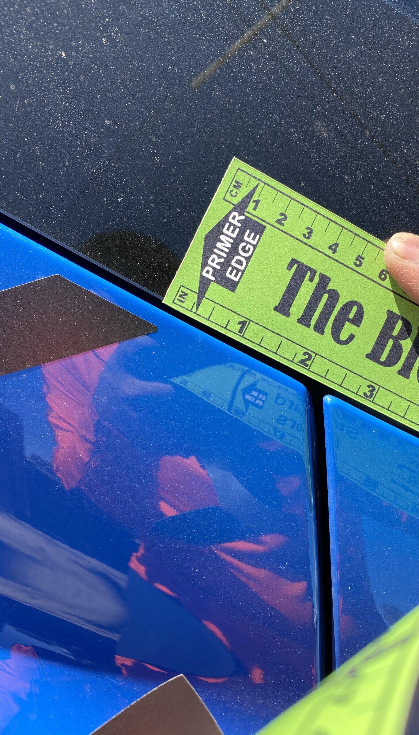

Also, this is the measurements from the trunk to the stripe.
Since you're being overly awesome. Would you mind getting length of stripes? Thanks again, crazy helpful.
