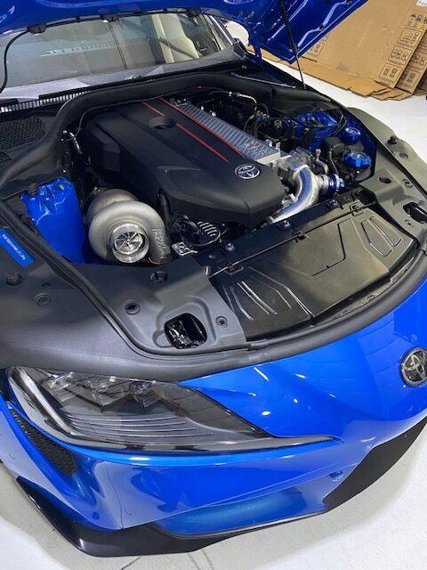

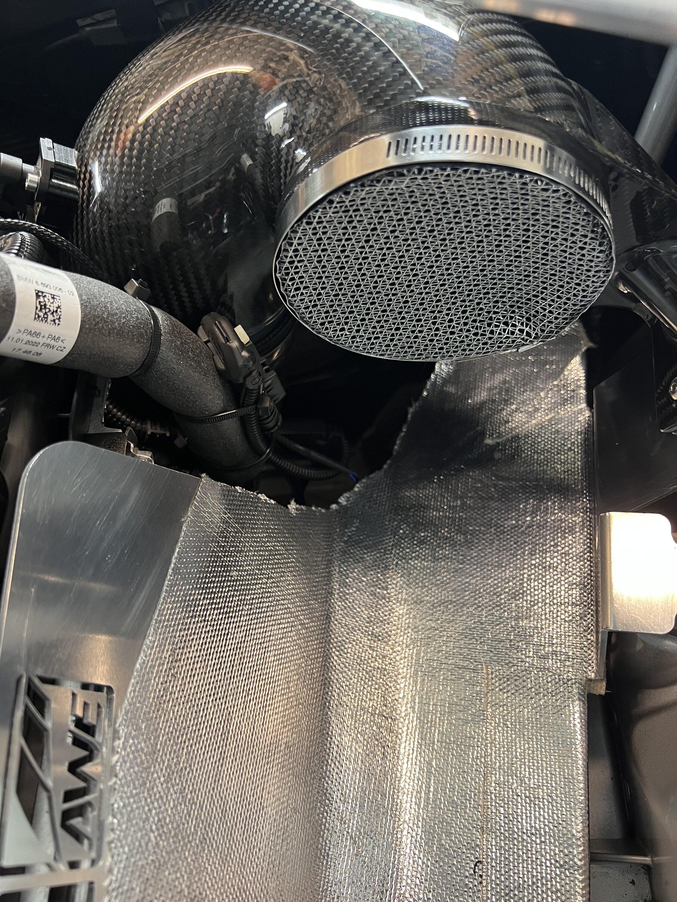

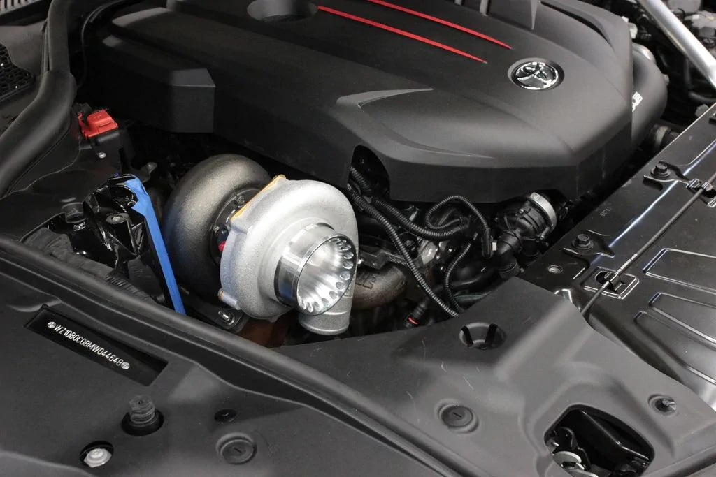

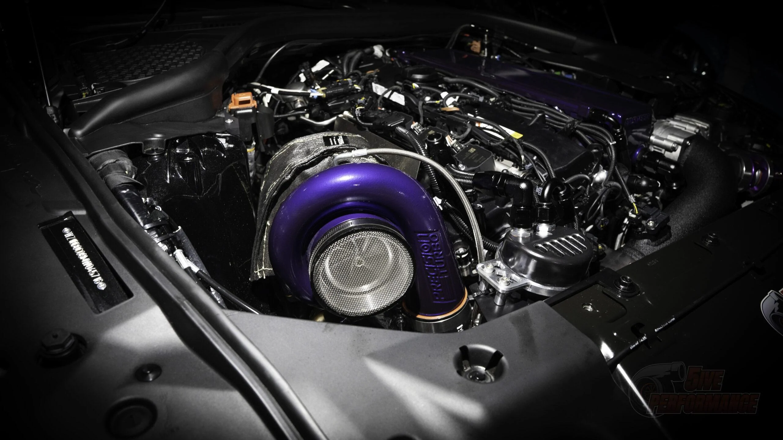

I’ve seen countless turbo cars with no filter, just straight turbo, so I fuk’d around and removed my filter and put on a double layer mesh screen, sounds nasty AF. But seriously, do turbo cars really need air filters?

kidding aside, I remember you poked some holes next to the radar for CAI inlet hose and it's not like the under the hood is sealed. I doubt a rock or stone is likely to be sucked in given that your engine shield cover is intact (except small ones!). Top of my head, I can think of leaves and stuff like that getting sucked in.. I don't know if slimy stuff could make it there, but wouldn't want the turbine splashing crap onto the turbo core.

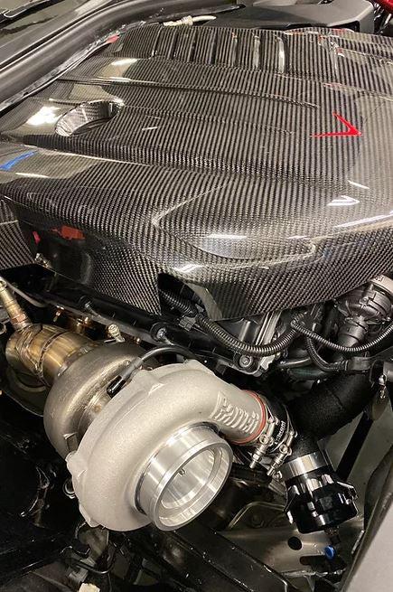

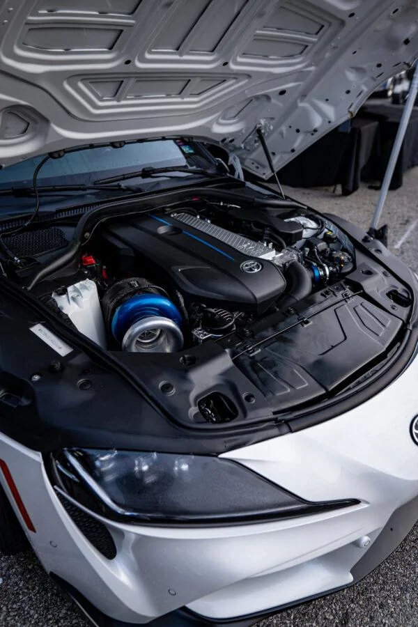

@GoldenEye I’ve noticed a lot of the big top mount turbos like the pictures you posted and have wondered that myself. Genuinely curious as to why those setups don’t need an intake filter. Maybe one of these top mount turbo guys can chime in and educate us as to why.
