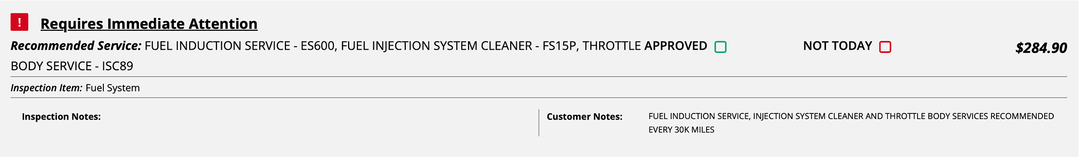

I'm not quite sure what this is, but do I really need this at 30k miles?

If you run your car on quality fuel then and it doesn't sit around unused for extended periods then the cleaner isn't needed. Quality fuels already have detergents to keep injectors clean.

Use Top Tier rated fuel and/or simply pour a bottle of fuel injector cleaner that contains high amounts of P.E.A. (polyether-amine) into your tank every few thousand miles. The Top Tier fuels are recommended by various auto manufacturers due to a minimum level of detergents included in the fuel to help keep the fuel system clean. PEA is the active ingredient in any aftermarket fuel system cleaner that actually works. Amsoil PI or Chevron Techron are popular examples. Generally, any additives sold by dealers are high profit margin products that cost more than the DIY equivalent if they even do anything significant.

If itā€™s an induction cleaning service (cleaner sprayed through intake manifold to clean intake & valves), itā€™s a great idea for direct injected engines. With port fuel injection the intake valves are generally wet so they donā€™t build up a lot of carbon/deposits, but on DI engines that doesnā€™t happen due to the injector spraying directly into the combustion chamber, so the deposit build up can slow the air getting into the combustion chamber causing fuel trim issues and performance loss. Without any correction I have seen engines go (more in to 100k-150k mi mark, some as soon as 80k), especially in cheaper cars and when the owners are less prone to thorough maintenance. Thereā€™s a lot of info on this out there if you choose to do your research. I tried to keep the info short and sweet.

I believe I read that at least some Audi direct injection engines (2.0 turbo) require walnut blasting at 60,000 miles.

Correct, my sons 2012 GTI at 120k miles was starting to misfire bad when cold. Had the walnut blasting at the dealer when it was at 70k (from the PO). Me and him did it with the seafoam and zip tie method. I'd buy a walnut blaster if I had to do it again. But it was soooooo badly caked I'm surprised it was running at all.

If I understand your post and you are referring to carbon build up on the rear face of inlet valves then fuel additives have zero effect because it's a DI engine. For walnut blasting it's a remedial action and has no preventative aspect to it all.

Only way to truly prevent build up is water injection. The average Supra owner is not going to do that. Walnut blasting is gonna be their best bet to keep it under control.

Water meth port injection isn't the whole answer to inlet valve carbon build up anyway, port fuel injection is the best answer. Gasoline has detergents included in it to keep the back of the valves clean as the contamination occurs and WM does not. WM injection is only used under specific parameters where in a non DI engine the port injection is constantly cleaning the back of the inlet valve with the fuel detergents while ever the engine is running. Some of the problem isn't just oil mist via the PCV system being re ingested but also to some extent exhaust contamination and reversion back into the inlet tract during valve overlap.. You can only mitigate so much with a DI engine. As a a side note walnut shell cleaning has been used on jet engines for many many years. I've never done it on a jet or ICE engine but I know the procedure. On our jets we used to water wash them regularly. The Walnut cleaning was for operators in severe operating conditions.

BMW engines currently are not experiencing any major build up. The valve timing events of the motors have minimized this. No dealer here is going to recommend any injection service, additive or walnut blasting on the current M or B58 motors. It has been this way for sometime now. They might check at 120k kilometers or more. My 14 M235i had a new valve cover gasket put on at 90k kilometers. Clean and in need of no service on the valves. N55 series motors are also not known to develop and inordinate amount of carbon build up on intake valves at all.
The N54 was the gold standard for troublesome carbon build up. Thats not an issue with the follow on motors at all. The issue is far less apparent.
The carbon build-up on BMW diesel engines is a big mess. I have seen that first hand at my dealer. Will not own any of those. They are a gunked up fiasco.
