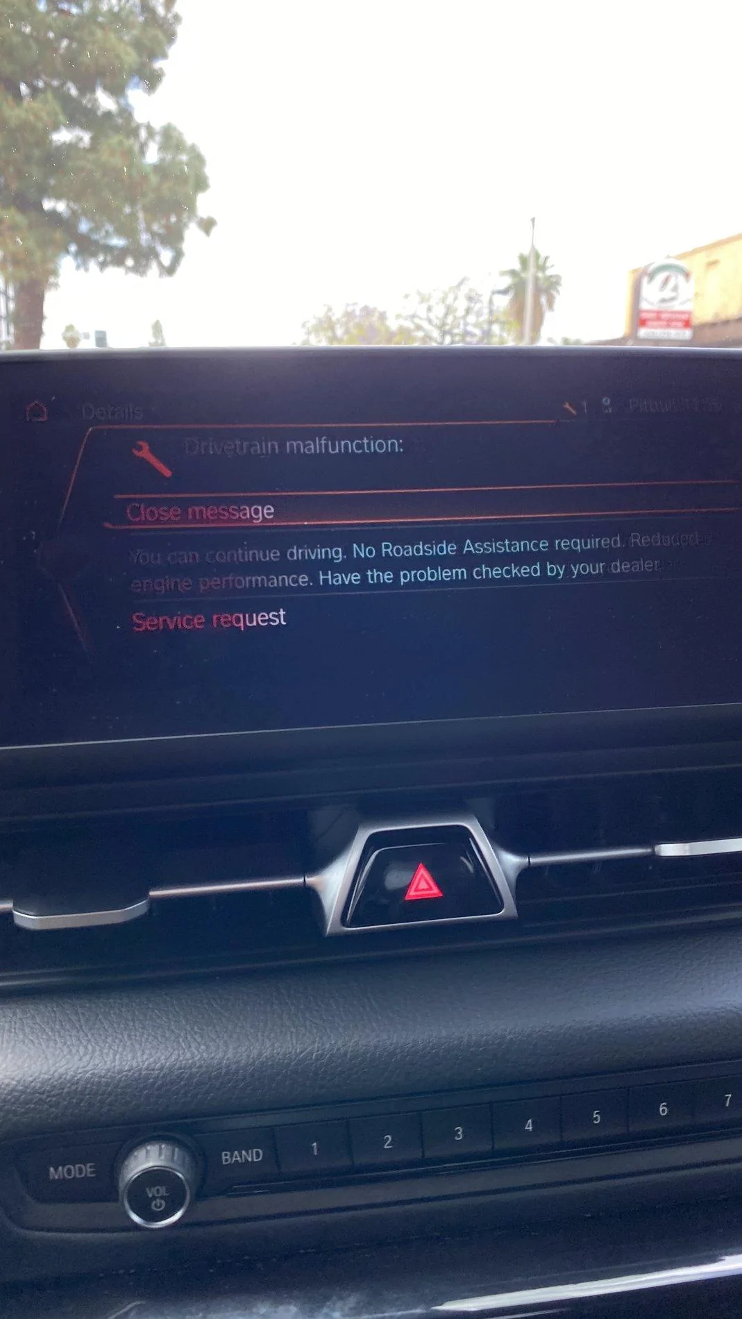

Today I got a drivetrain malfunction message.
I did google search what causes it and symptoms it shows several reasons. So I did notice couple symptoms like car start shaking, vehicle seems to cut off/die while on idle but no engine light and it still starts. Also when I turn on my A/C I smell gas.
Has anyone come across like this? And/or has solve the issue?

how many miles do you have? take it to the dealership for sure

Is your car stock? Tunes can cause this error. And a downpipe could possibly cause it in the right condition, or some bad fuel.

Car has few mods downpipe, exhaust, Charge pipe and scorcher power module. Iā€™ll be doing my own maintenance from now on. I already bought stuff to keep it maintained.

Do not go to the dealer if you have a Schorcher. This is a piggy back computer. And yiur car fell out of its parameters. Try to reproduce this and Contact afe. As I am sure they would love feedback and will update the firmware. This is one small issue of piggy backs. People donā€™t realize they can contact the manufacture. That and even if they contact due to no ability to datalog the ability to adjust vs a custom ecu tune is limited.
but this being said... it is likely from the piggy back. And I would guess at 3500-5200 especially after a mid gear pull.

So i spoke to the technical support and said that the car is still learning from the scorcher.

I doubt the Scorcher does much learning. With the parts you've already invested in you'd be much better off ditching the Scorcher and getting a real tune.

yeah that learning bit... unless you just put it on doesn't require heavy learning. These cars adapt extremely fast. They use real time closed loop fueling and can adjust on the fly. They don't need multiple tanks of fuel to "feel things out"
