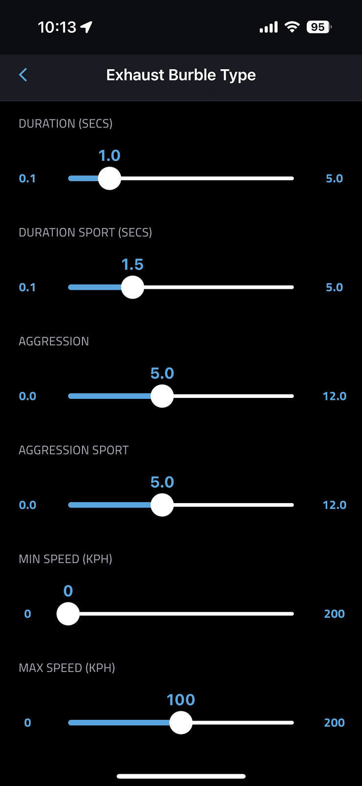

I'm warming to the idea of tuning my MT, but was wondering how having a tune affects the use of the Sport button. I know this is rather trivial, but at present the Sport button in my car essentially acts as a quick way to silence the burbles from my exhaust.
If I were to go ahead and get the car tuned I'd want to increase the burbles and pops via tuning - yes I am a child - but would love to keep my one button silencer.
I understand that you can switch maps with either BM3 or MHD and that one map could be tuned with burbles and another without, but from what I understand changing the maps isn't an immediate one button function.
Any insights or ideas around this concept would be much appreciated.

I am currently running an OTS tune on MHD. I don't have the MHD+ stuff yet. High flow cat. Stock exhaust. I can adjust burbles with MHD. I set it (medium to aggressive) and never readjusted. Going from Sport to Normal mode quiets the burbles and sounds like stock Normal mode.
I hope this helps.
Burble settings can be different between normal and sport.

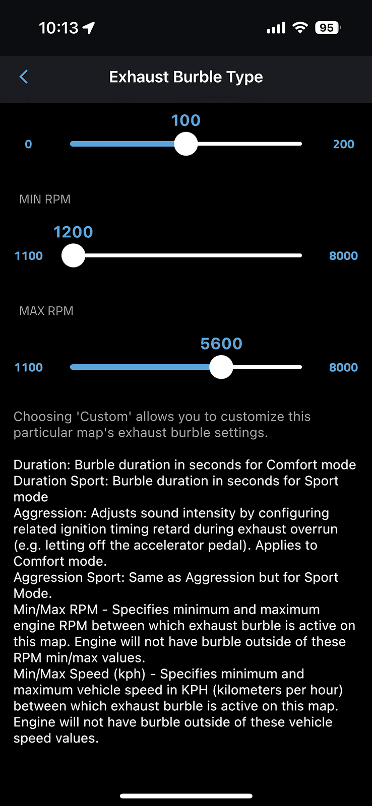

So wait.. I'm just going to repeat it to be clear.. If I have an OTS/custom map, I can set it to have burbles like crazy in sport but none in normal mode? This would be perfection!
If so, can I presume this would be the same for either MHD or BM3?
Bryan / Briana
4,739
9,478
Your moms bedsheets
Yes, the custom burble settings apply to both modes independently.
Your tuner can also adjust them in a custom map.
