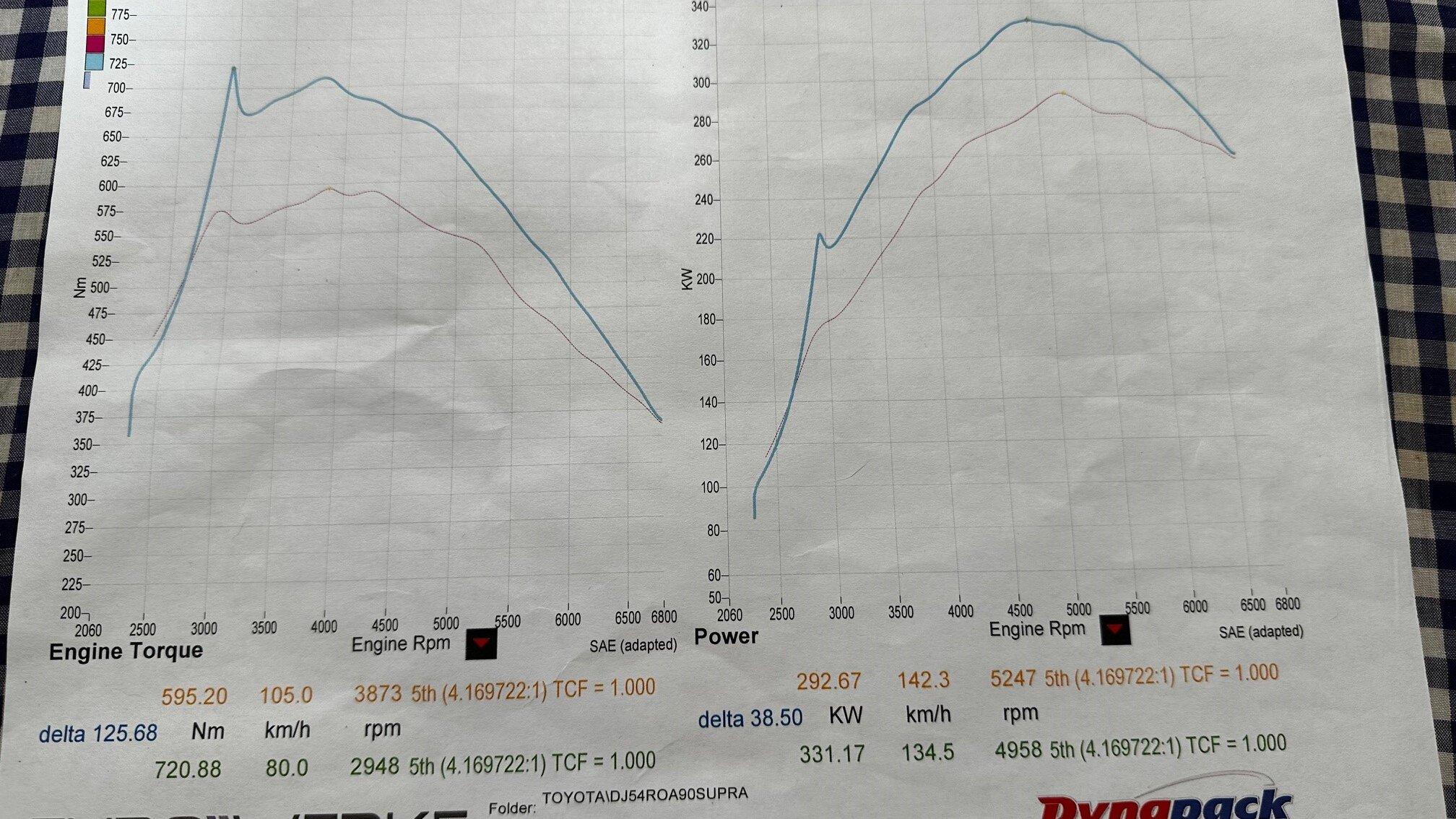

I'm in AUS too, and I just had my car custom tuned on 98. What were your hp & tq figures before & after the tune? I feel like our dynos here (DynoDynamics) read really low.
@Twisted Tuning are you able to have a look at these numbers? catless dp + intake + exhaust 2021 Femto Unlocked tuned on 98. I had the tuner do a revision and it made more power (2nd chart). Thanks :)

How's the logs look?

This was tuned on their own tuning solution, so I don't really have a way to look at logs. Unless I get bm3 or MHD as far as I know. Do you know of any solution I can use to get some logs?
Oh ok, I mean can't tell much from a dyno plot other than power. You should definitely as an owner have a way to log your own car. These cars make power easy. Doesn't mean it's a good tune. Get datalogging capabilities for your sanity.

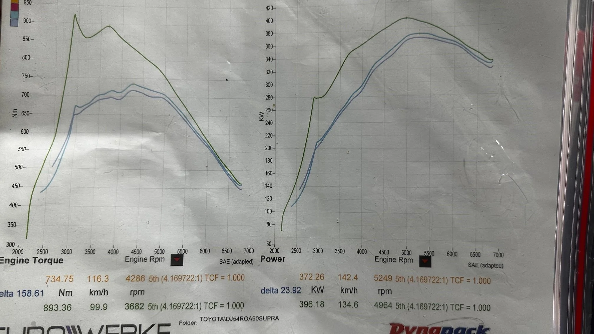

Hi JS
I got the car retuned, from memory on the standard power it made with no tune, with intake and catless downpipe was 258KW@wheels (345hp)
With the tune it got up to 284.5KW@wheels (381hp)
but then i got it tuned from another tuner in sydney who tunes a lot of the B58's and got 331KW@wheels (443hp) mind you this is from a hub dyno. But got the tuner to do a comparison from the old tune to the new tune. The old dune from a dyno dynamics dyno got 284.5KW which equated to 292KW on the hub dyno .
Completely different car to drive between the two tunes. Below is a dyno sheet the first one is 98 the other one is E50
