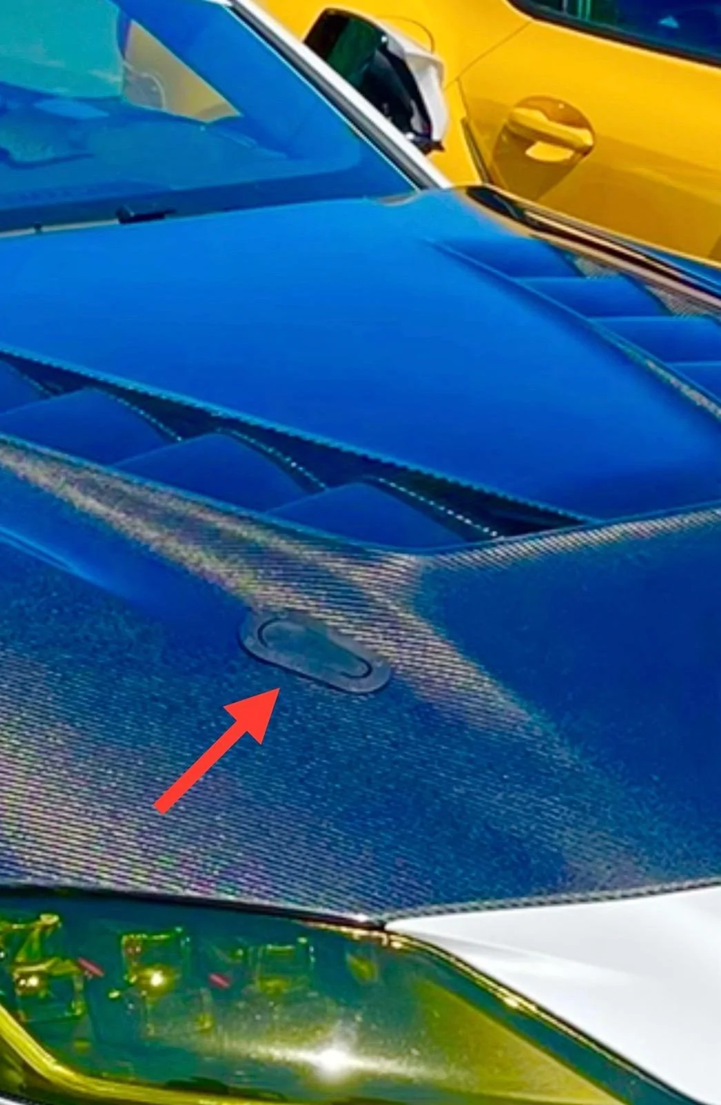

Did you install top side hood latches? Those CF hoods are known to flex, that could be why it’s triggering the sensor.

These are the latches I mentioned. Also double check the hood bump stop adjustments.

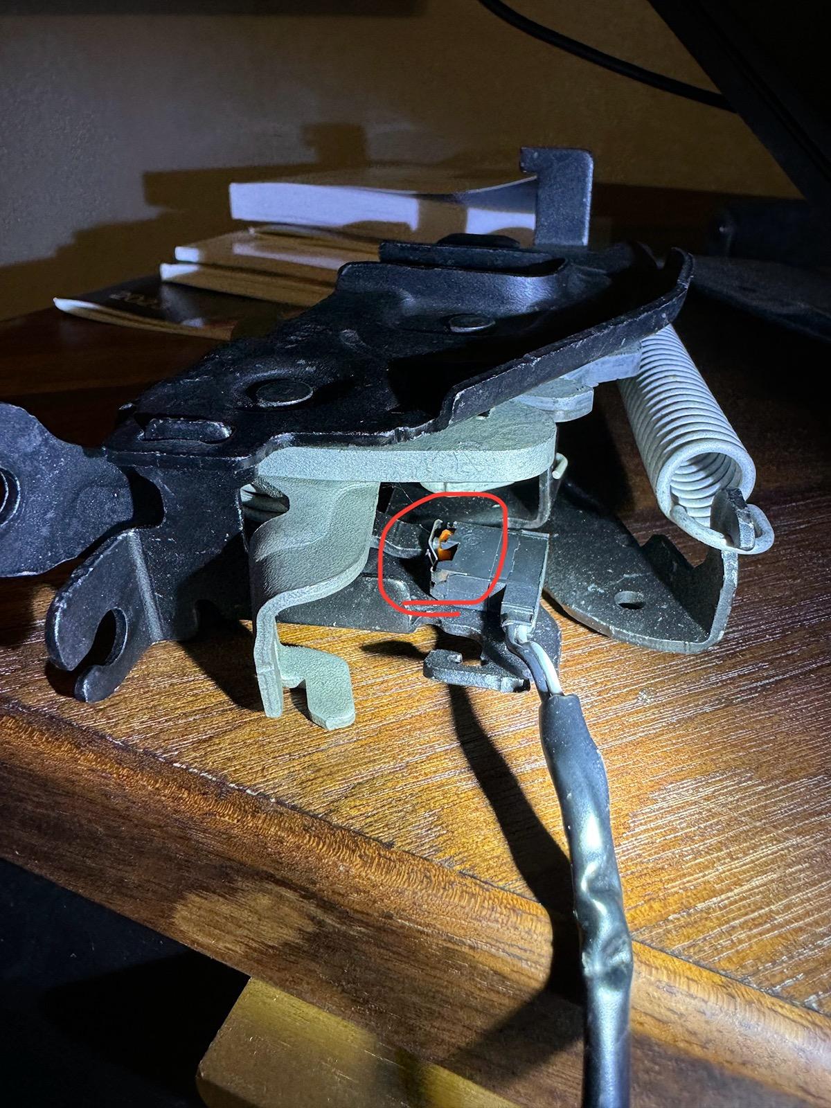

before you start cutting anything, first make sure the warning isn't a false positive. have you checked the switch for continuity? you should be able to trigger it with a screwdriver to simulate a hood-closed position.
an031994
an031994
Tony
Apr 8, 2022
Fort Worth, TX
2023 Mk5, 2005 Honda S2000
I did try to check to see if it was a sensor issue. I took the latch off the car and pressed
down the area circle in red with a pick but the hood open light remains on. Looking into it further it seems to be a common BMW issue. From what I read you can either add a resistor or swap out the latch assembly for a new one.
i3igpete
May 16, 2022
402
370
Chicago
2023 3.0L 8AT
yup, that was going to be my next suggestion, try jumping the sensor wires and figure out if there is a break in the wiring harness.
