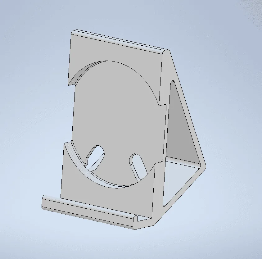

Sweet. I'll probably print one but modify it to take the magsafe charger. I recently printed this stand for my desk at work I left the sides exposed so that it wouldn't interfere with my case and two slots to angle the cable in the preferred direction. Just gotta take some pictures to upload it into Printables.

I was thinking of making a charger version. Do the chargers work well (hopefully much better than the charging tray in the car)? If so I'll pick one up and update the design for it.
It works much better than the tray. The 15W output really makes it charge closer to a decent wall or 12V charger but obviously not as fast as quick charging speeds. I will likely print mine with a bottom edge just to make sure it doesn't drop on me while going around the track since I wanna be able to keep an eye on several parameters. Feel free to PM me if you'd like the .stp of the stand I made so you can go nuts with it.

I may take you up on that, thanks! I can send you my step files as well if you need them.

I finally got a chance to sit down and play with combining the magsafe charger into the holder you made. I might make it a bit wider and add some honeycomb cutouts to make it look nicer but in terms of function this should be more than sufficient. Had to thicken up the front face to 7.5mm to allow for the 56.25mm diameter cutout at a 5.5mm depth. I might shrink the diameter a hair just to get a more snug fit after I get a chance to print it. Wouldn't want the whole thing popping out on the road 😅 .
