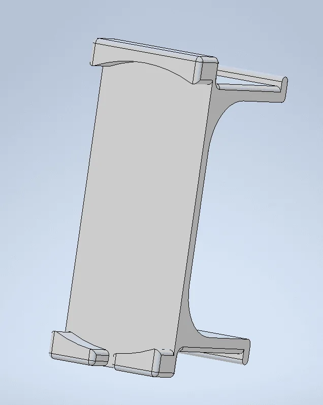

I finally got a chance to sit down and play with combining the magsafe charger into the holder you made. I might make it a bit wider and add some honeycomb cutouts to make it look nicer but in terms of function this should be more than sufficient. Had to thicken up the front face to 7.5mm to allow for the 56.25mm diameter cutout at a 5.5mm depth. I might shrink the diameter a hair just to get a more snug fit after I get a chance to print it. Wouldn't want the whole thing popping out on the road 😅 .
