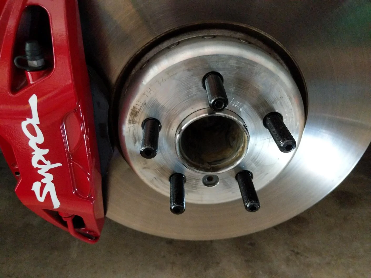

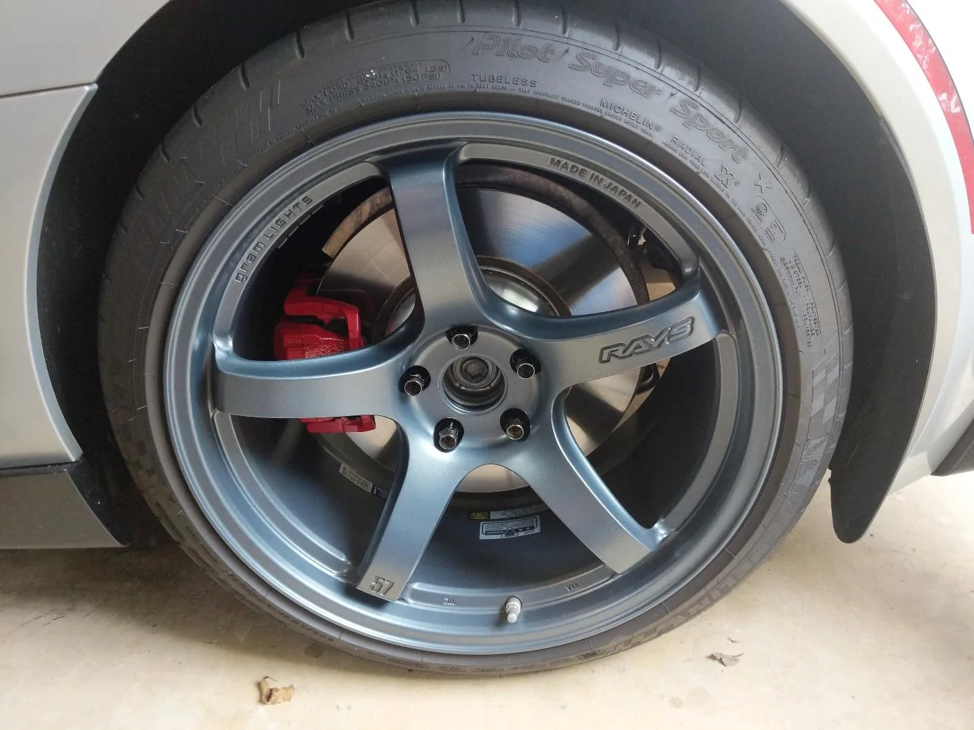

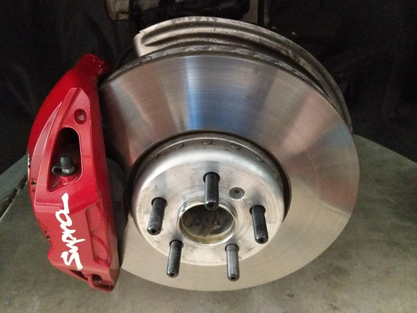

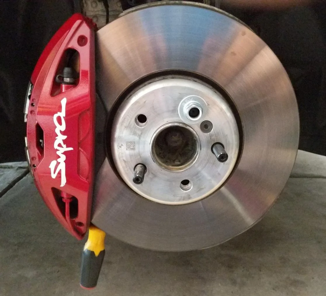

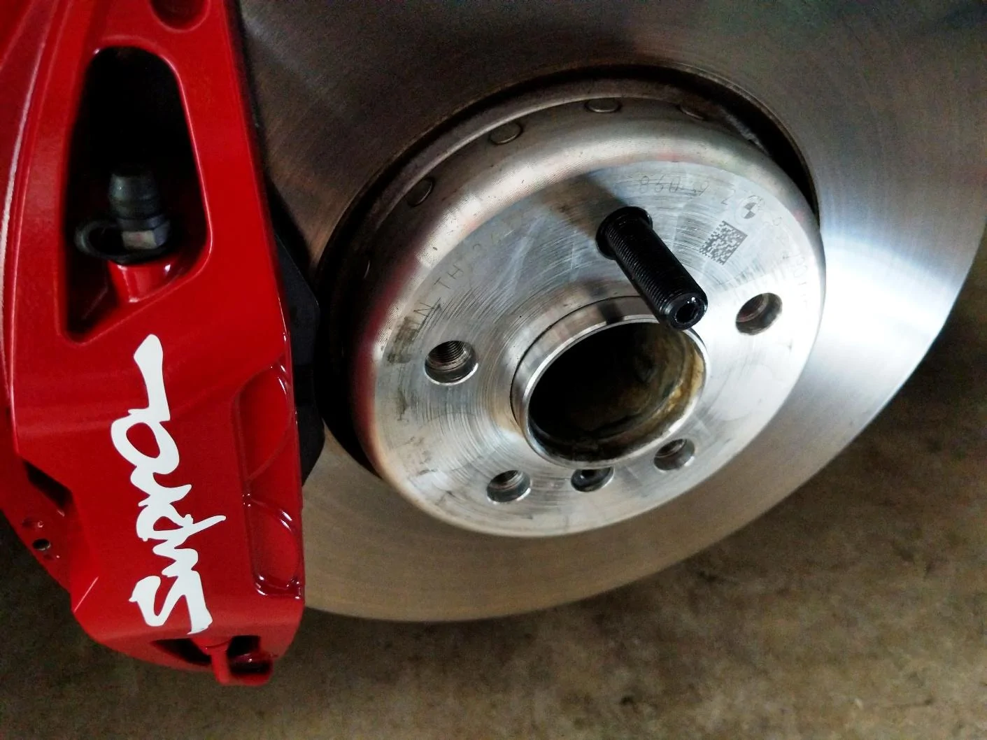

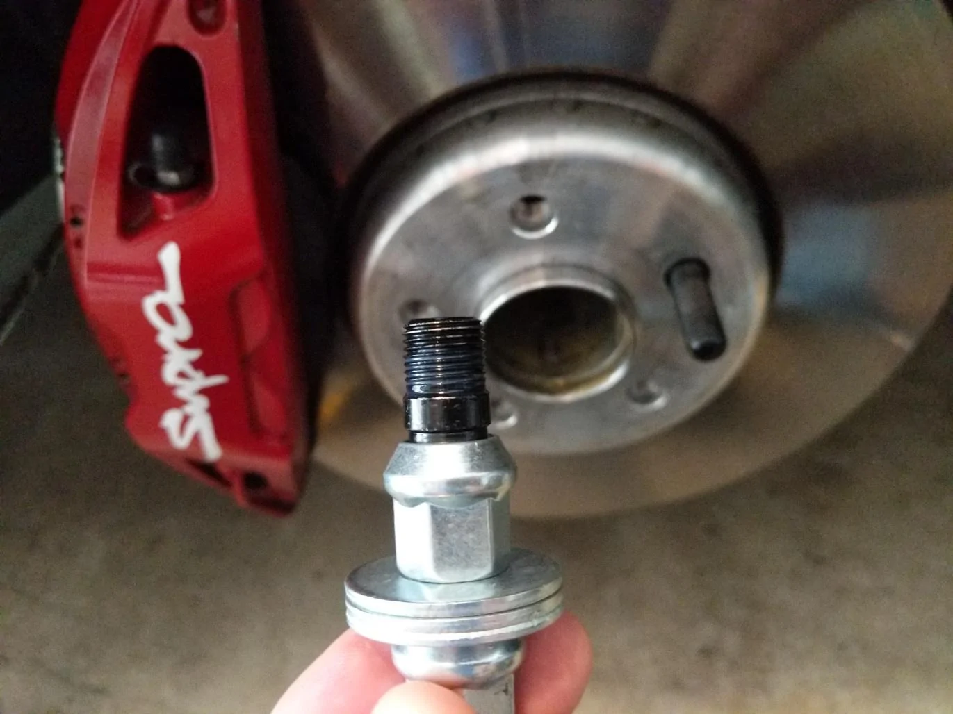

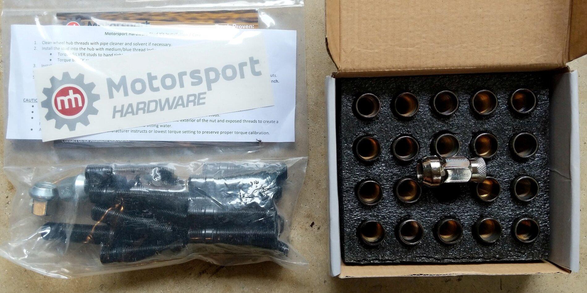

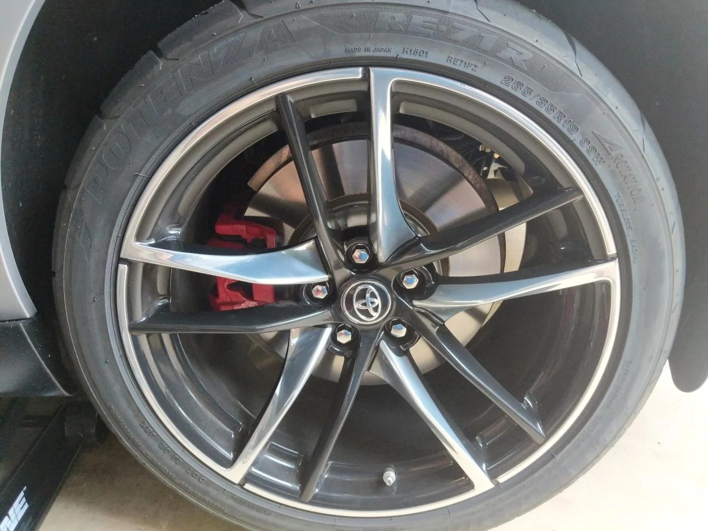

Picked this kit up on clearance and did a quick install. Installation time appox 1hr. Easy installation.
Likes:

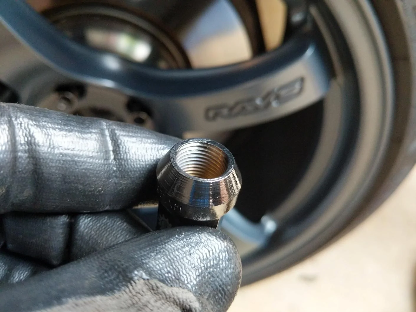

14x1.25 nuts can be hard to find so this is a steal for an entire kit.

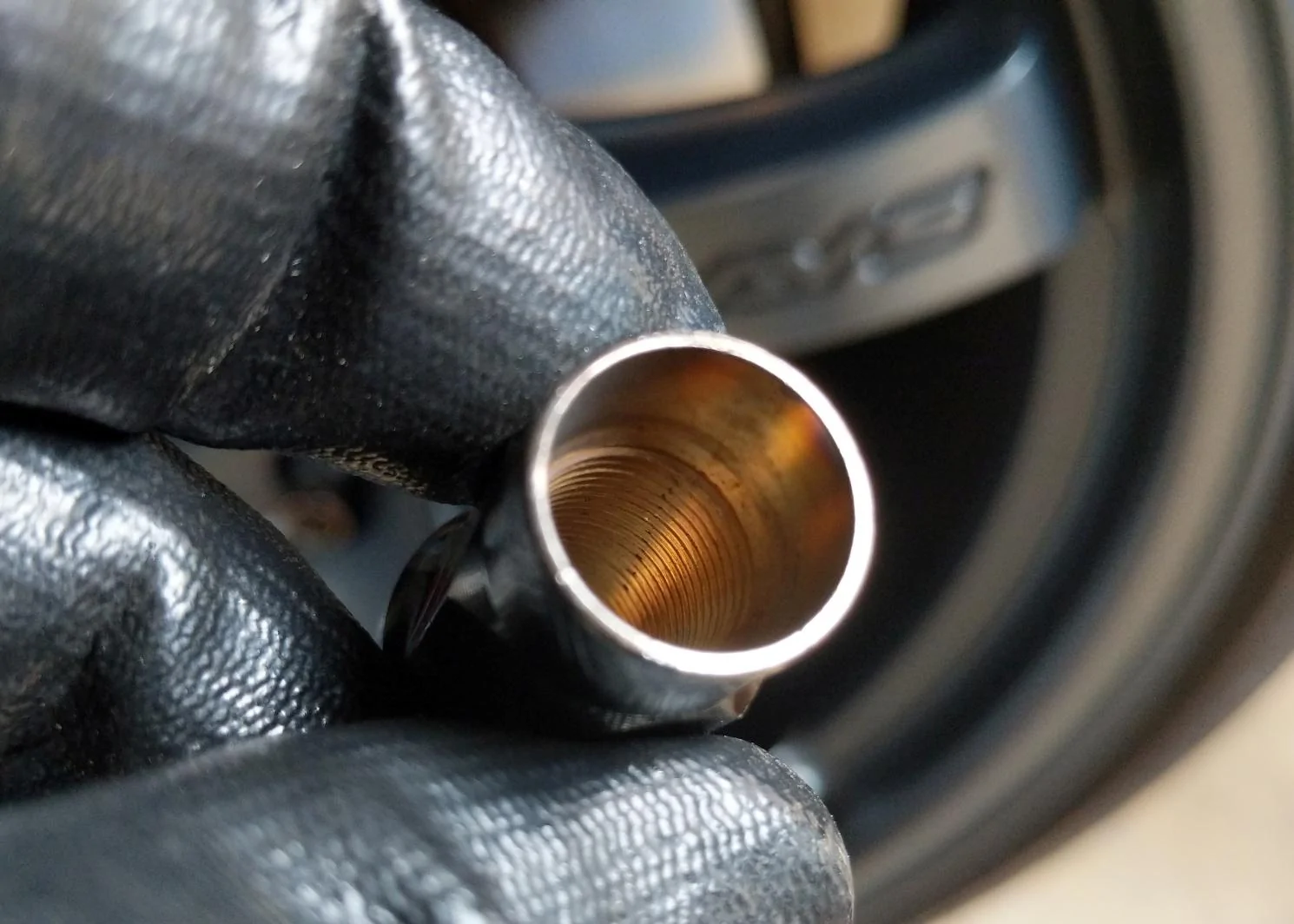

Threads on nuts start at the end and continue for 3/4 of the length giving increased thread contact patch.
Considerations:
This is the first time I've done a stud conversion. I thought 60mm would be too long but once installed, I think I would prefer a longer version. I would also prefer one that had the bullet speed loader end to it. But for the price this is a hard contender. I do like the fact that none of the threads are exposed from the end of the nut thus cutting down on rust/thread damage.

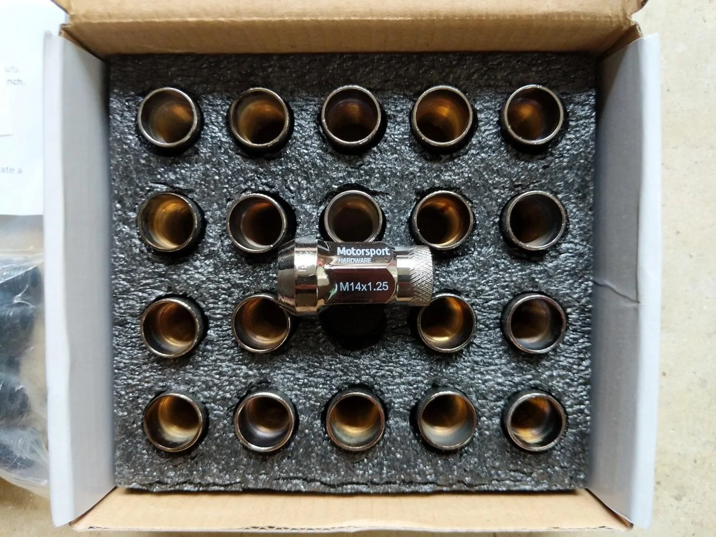

Info From Webpage:
https://motorsporthardware.com/prod...-stud-5-lug-kit-14x125-mh-titan-nuts-package/
60mm Black Stud 5-Lug Kit 14×1.25 & MH Titan Nuts Package
Clearance $80
A FANTASTIC deal for enthusiasts/racers that are looking a great value which includes the MH Titan nuts in our Clearance section!

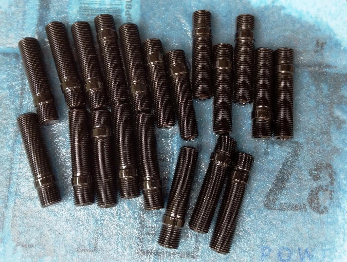

60mm studs
14×1.25 Thread for F-Chassis BMW and Late Model Mini cooper
10.9 Grade hardness
Gun Metal Finish
60mm studs can accept up to a 15mm spacer
Why on clearance? The studs may have some variances in the hex and/or finish but it does not affect the functionality in any way
There may be some inconsistencies with this particular hex so we will be including (2) nuts for installing using the double nut method

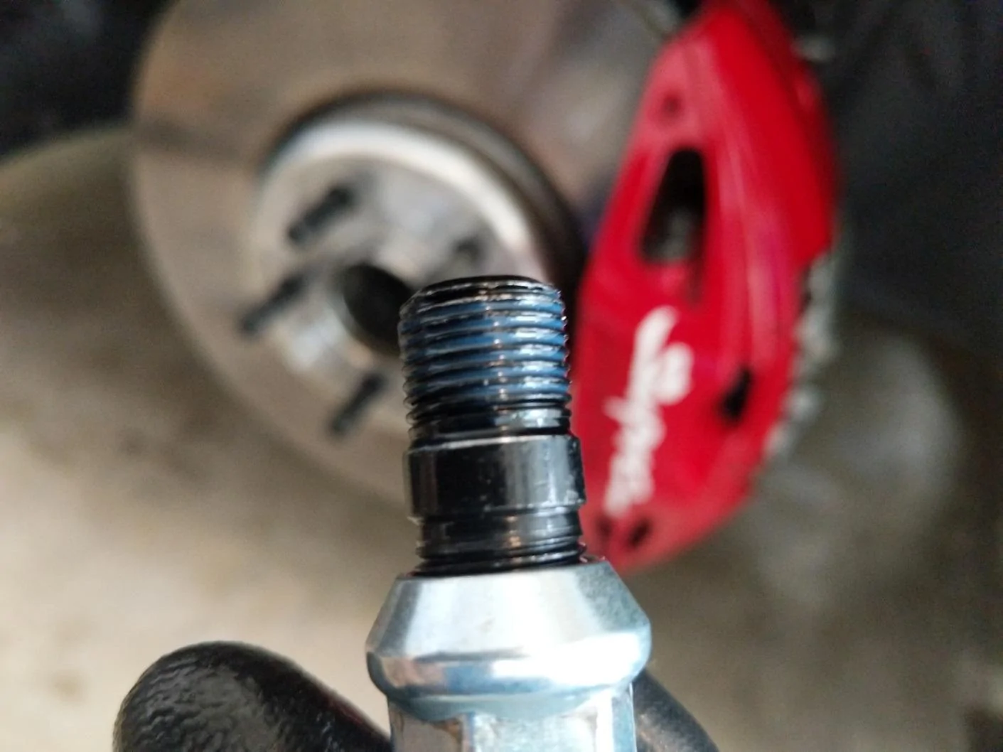

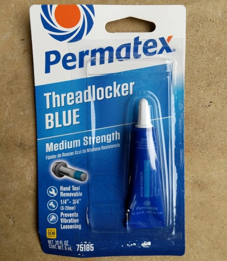

Tip #2
Use some blue threadlocker when installing the stud into the wheel hub. This will help lock and secure the stud and prevent vibrations from turning the bolt. Red thread locker requires heating of the bolt to remove if you need to change a bolt.
30MilesOffshore
30MilesOffshore
Jan 27, 2020
379
318
Charlotte, NC

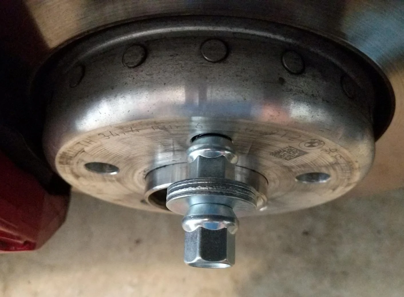

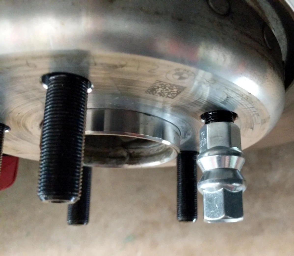

Tip #3
When installing the stud, do not place the nuts nose to nose. They can shear the tips onto each other and then get locked on the stud. When you go to remove the double nuts, you will keep removing the bolt as well.
30MilesOffshore
30MilesOffshore
Jan 27, 2020
379
318
Charlotte, NC
Tip #4
Grab a couple of washers from Home Depot/Lowes and put them in the middle to create a friction plate. This helps tremendously with install and removal of the double nuts.
When putting on the first nut be sure to leave some room and not go all the way down to the bottom of the threads.
Torque the studs to 25ft/lbs
30MilesOffshore
30MilesOffshore
Jan 27, 2020
379
318
Charlotte, NC
Tip #5

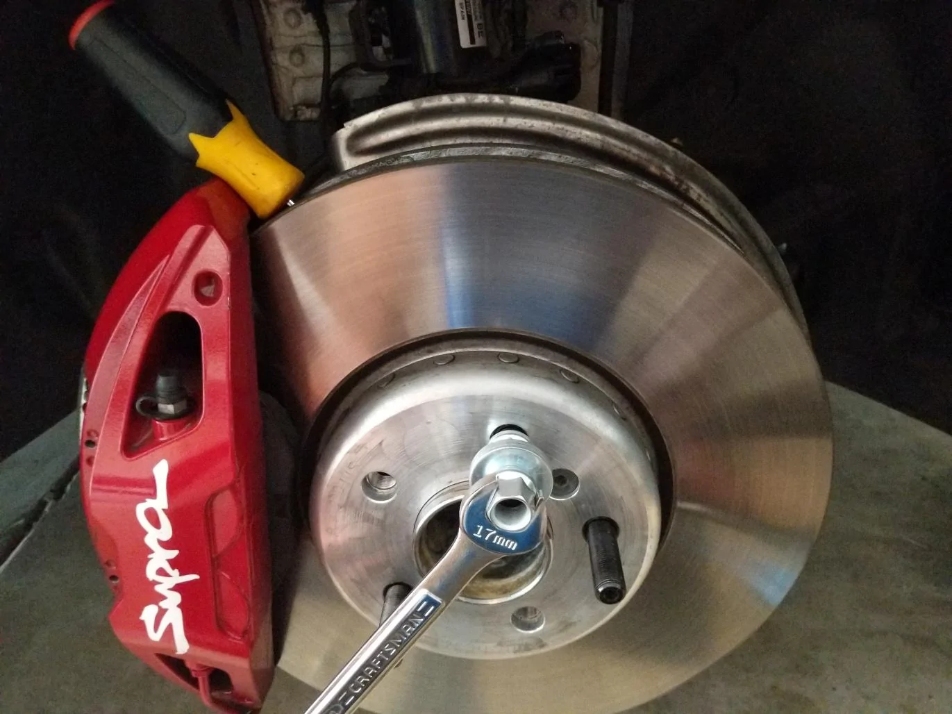

Wedge a soft handle screwdriver in the front rotor to keep it from spinning while you are torquing everything. Another option is have someone sit in the car and hold the brake down. You will need to put it in the top and bottom when installing the double nuts and removing them.
30MilesOffshore
30MilesOffshore
Jan 27, 2020
379
318
Charlotte, NC
If installing spacers it is recommended to ensure that the nut gets a minimum of 7 full turns when torquing.
