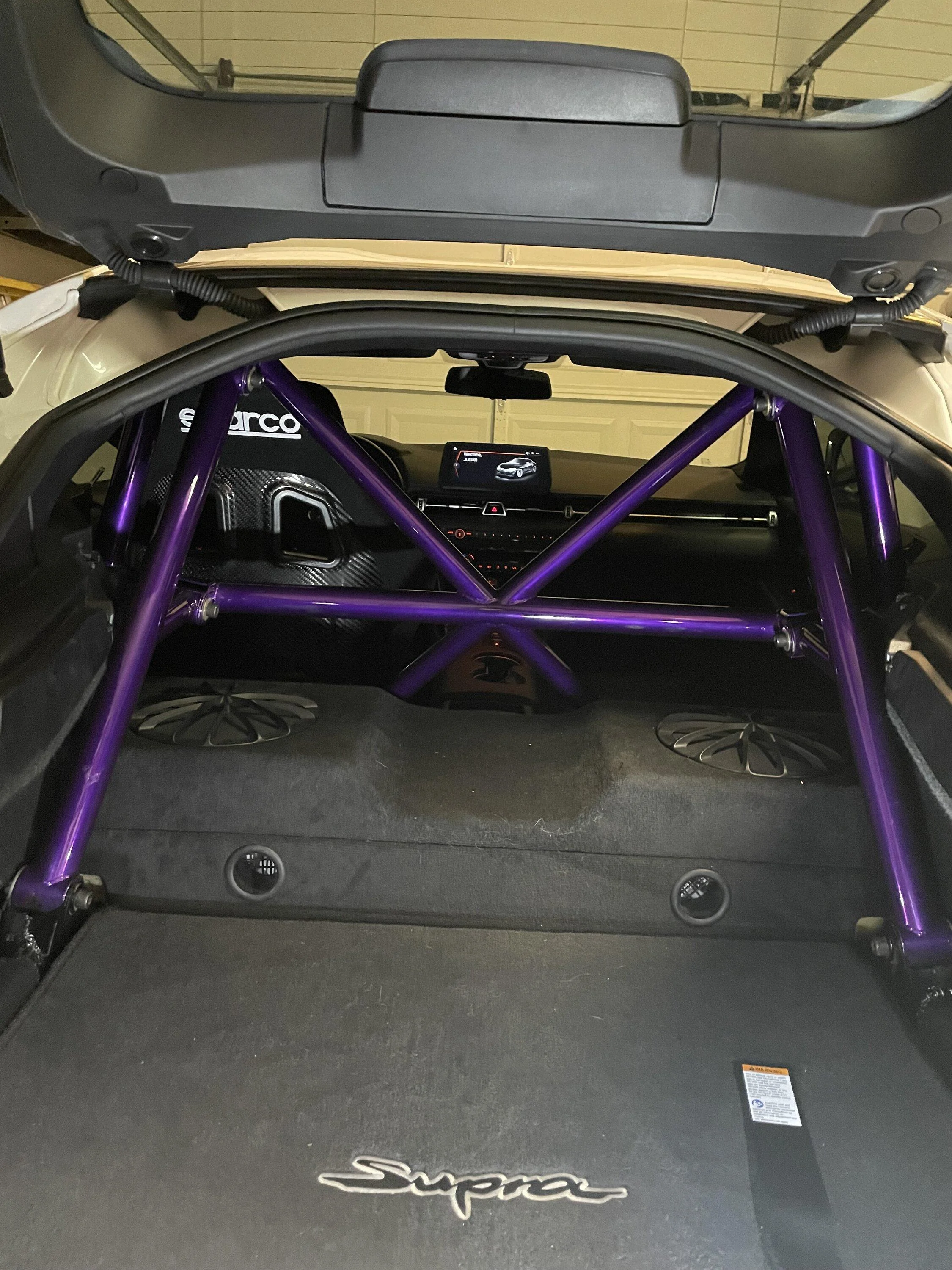

I have since gone to a bucket. Running a Sparco QRT-C on a Sparco slider and Dotekiā€™s bracket. The Sparco QRT line is made for bigger people. Highly recommend them or an EVO XL which is a bit cheaper. A bucket gives you more leg room than the stock seat, but no recline obviously. The stock seat is like 4-5 inches thick whereas a bucket is an inch total. You save a lot of room with a bucket, but you need the slider to get it back far enough.
I had enough room with a bucket to then go with dotekiā€™s half cage/roll bar. This also gave me a safe option for harnesses. I just put the stock seat back in for test fitment with the roll bar. It is not comfortable for me at all.

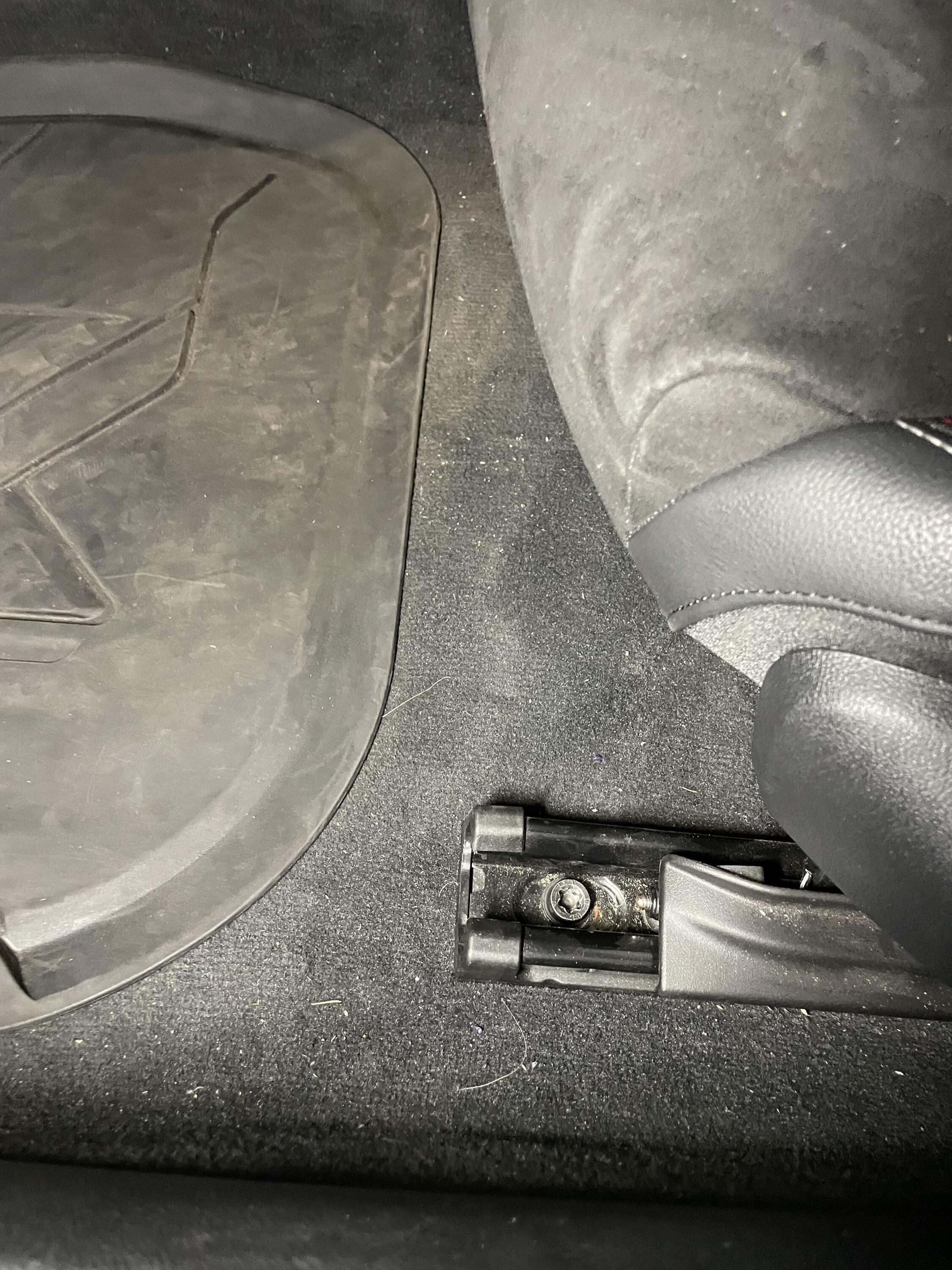

This cage is engineered specifically to maintain as much space as possible. I lost very little in rearward position (see pic of slider below), but I lost some recline due to the rollbar up top and height of the stock seat.

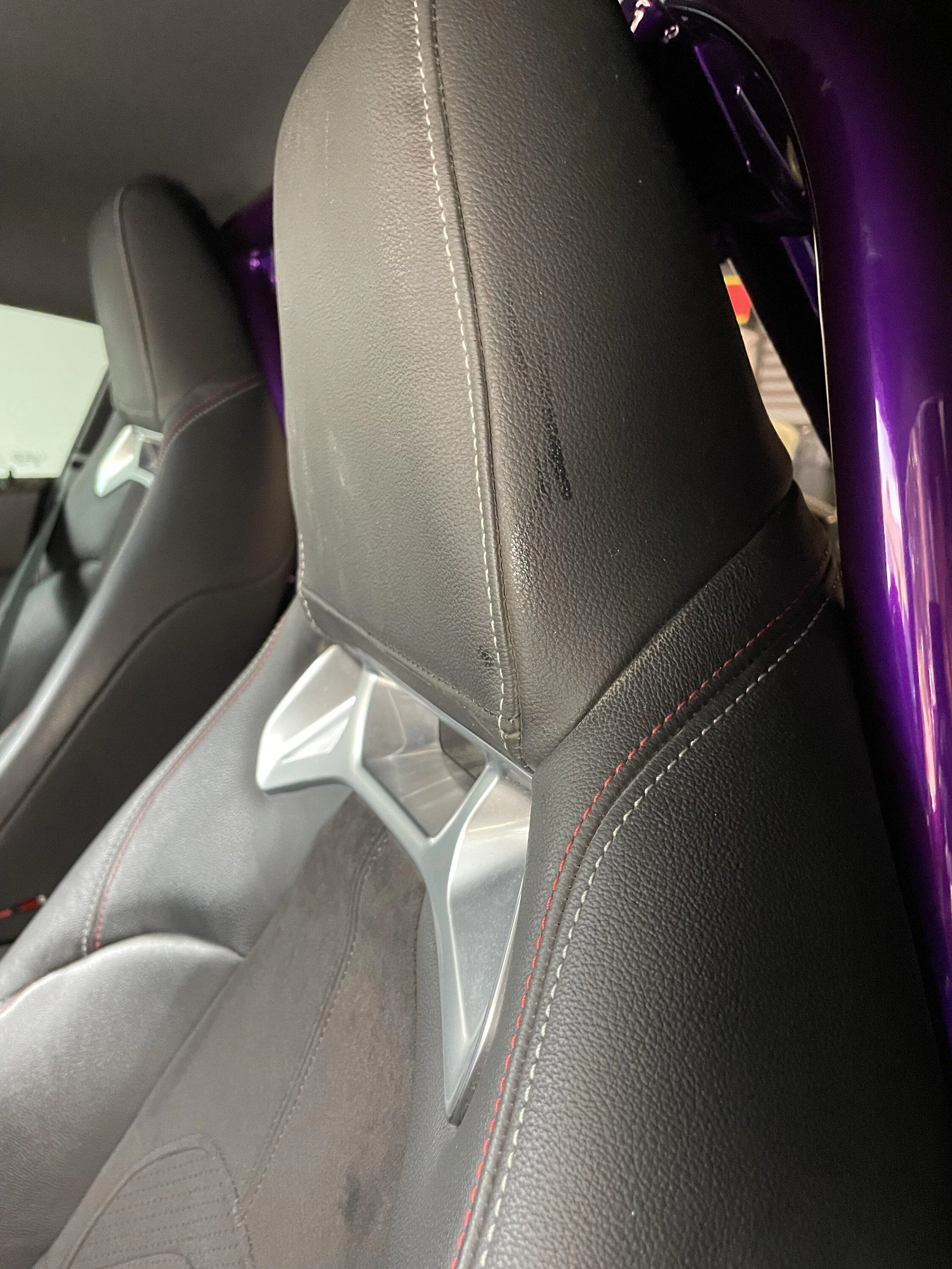

this is all probably fine with stock seat for 95% of supra owners, but I am personally not comfortable in the stock seat with cage. I needed more recline than the stock bar allowed with stock seats which is why the cusco bar was great for me.
i am 100%comfortable and in correct drivers position in the sparco with the cage.
