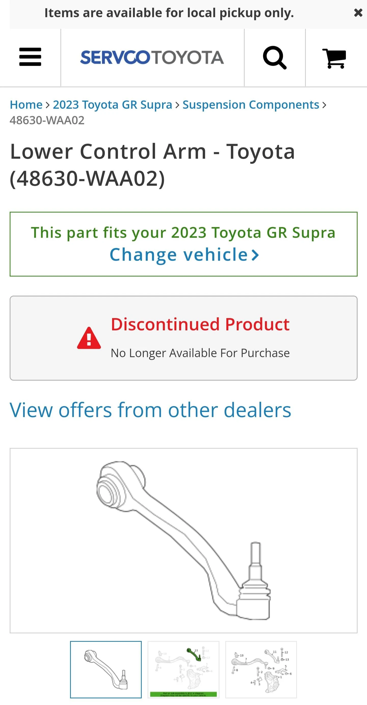

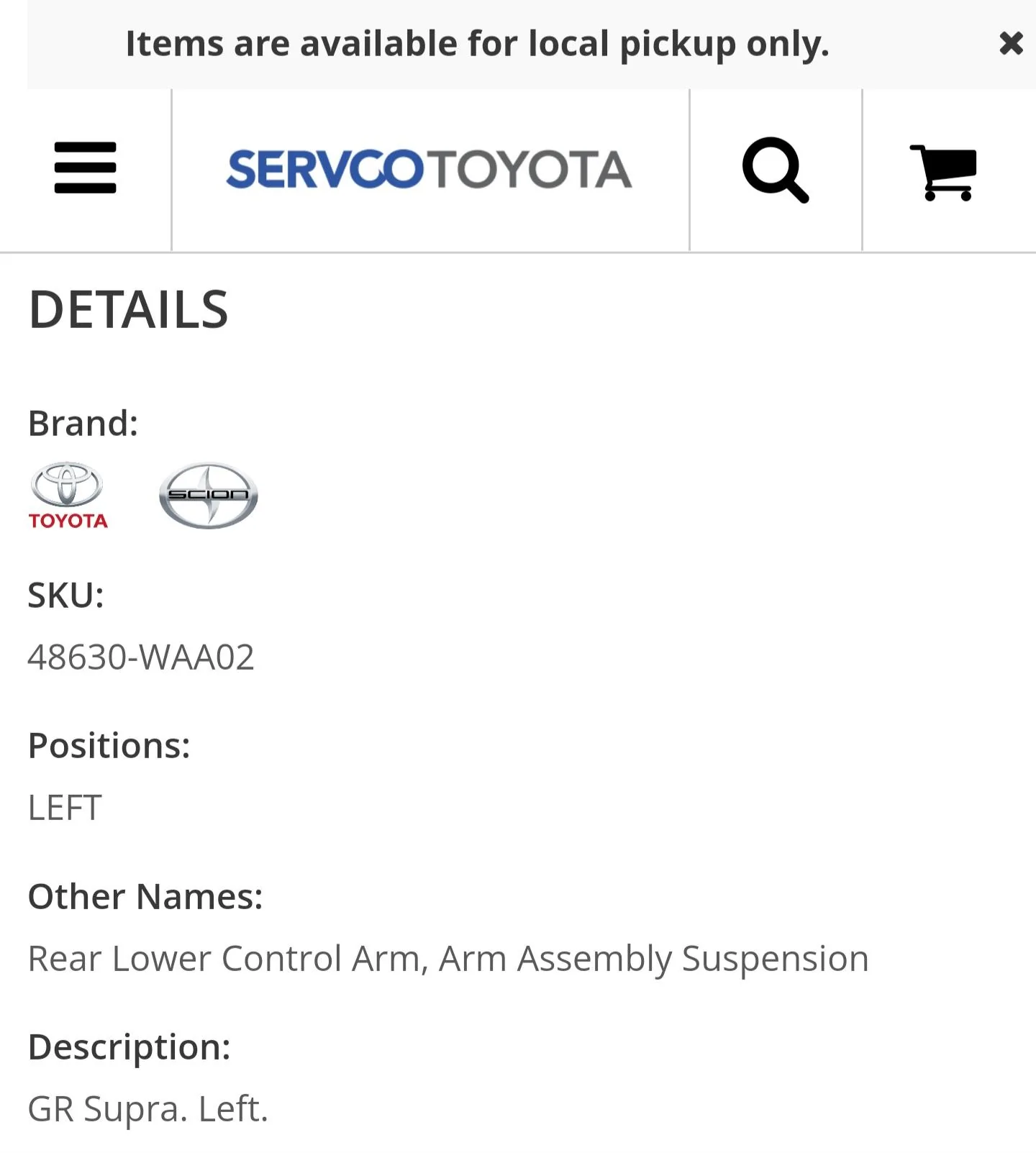

My car is currently in the shop for repairs, with a single part preventing it's driveability currently on "national backorder" with no ETA. It's the left rear lower control arm, visibly bent and causing the tire to pull to the left. Looking up the part number 48630WAA02 says the part is discontinued and I can't find anywhere that has it for sale.
My question is if anybody can help me find this part, or advise me on an aftermarket alternative, or something, to help me get my car back!

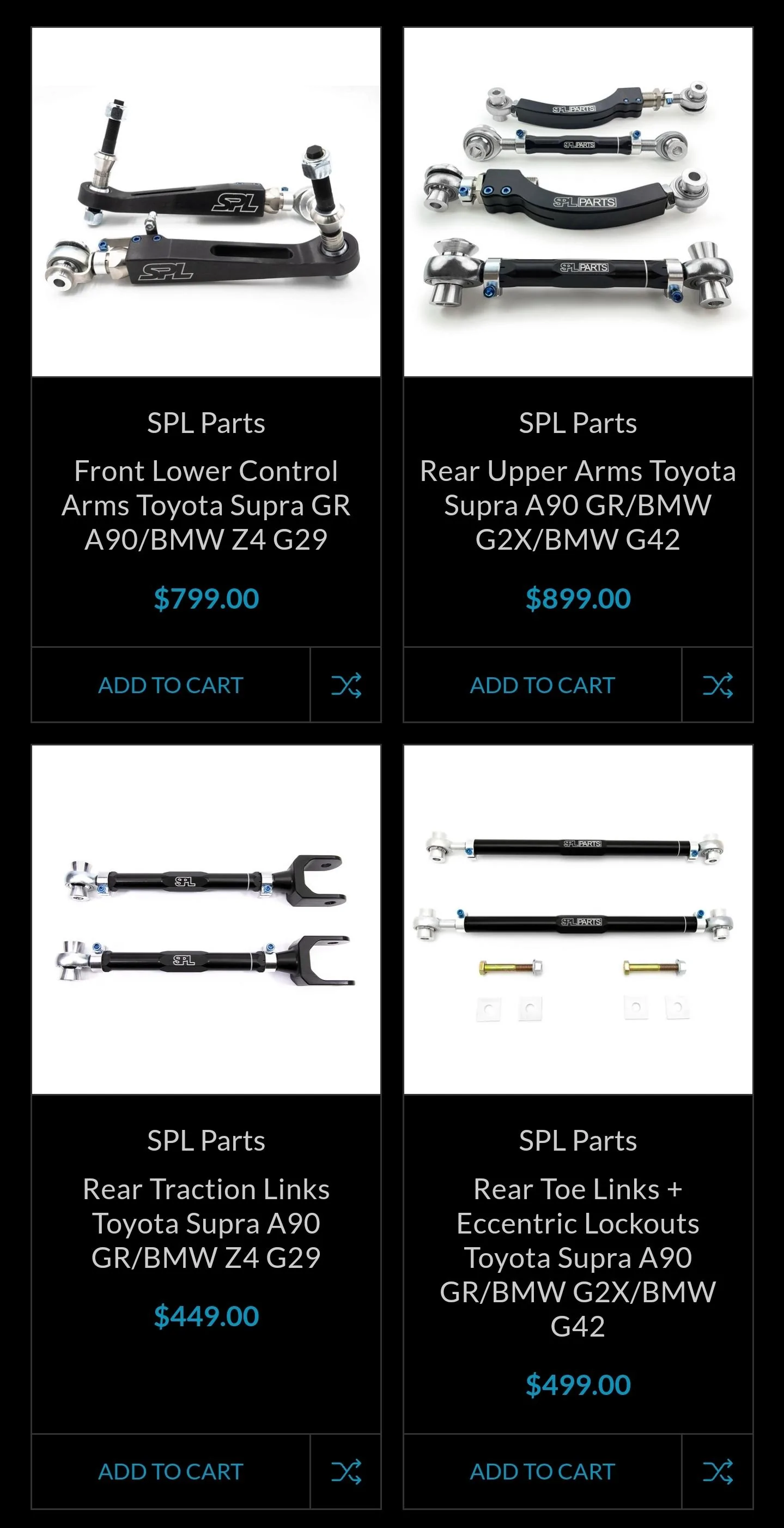

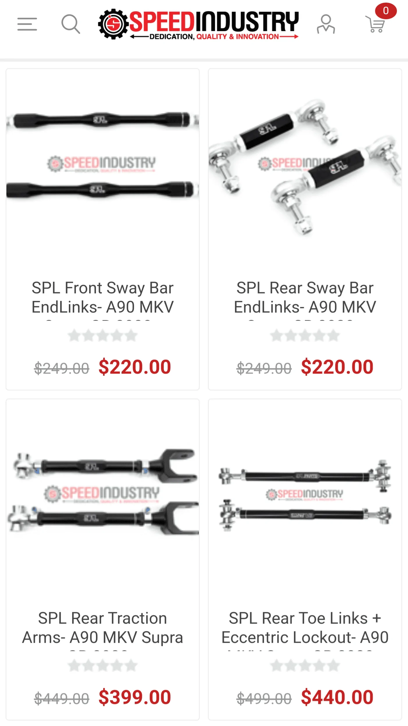

Also there are many upgrades available if you want to make them a bit beefier 🥩 :
https://verklineusa.com/collections/suspension
https://www.splparts.com/supra-g29-2020
https://speedindustry.com/megan-racing-rear-camber-arms-rear-upper-gr-supra-20bmw-3-series-19

Thank you for the suggestions! However, I called every Servco Toyota dealer parts department in my state of Hawaii and each one (there's not a lot of em) confirms that none of them have it in stock, nor are able to order it. On all Toyota parts sites that a Google search comes up with from the west coast to east coast, and even up in Canada, it says the right side is available, but the left side is strangely discontinued?
eBay doesn't seem to have any. In addition, those sites nor the usual aftermarket parts sites usually reccomended on this forum don't seem to have solutions for the rear lower control arms. The closest it gets to it are the front ones.

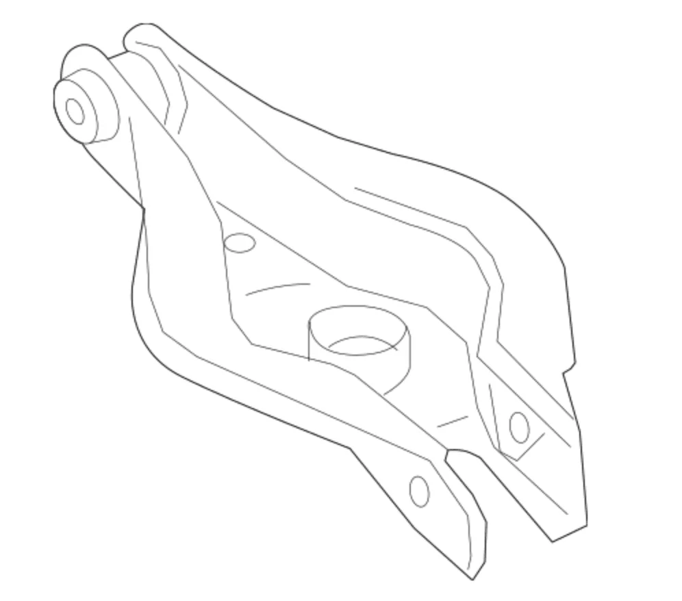

That's actually the front lower control arm in the front of the car. They call it "rear" because it's the rear most arm in the front arm bundle.
Looks like you have an old part number
Drivers side:
Toyota - 48630WAA01
BMW - 31106888153
Passenger side:
Toyota - 48610WAA01
BMW - 31106888154
BMW parts are the same thing.
