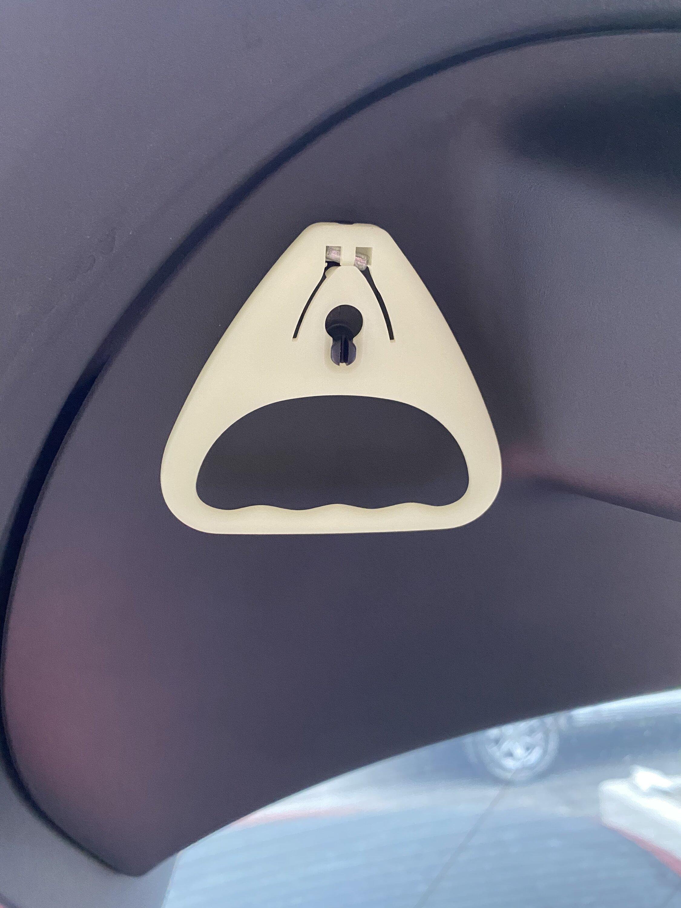

Check your emergency trunk latch. Thatā€™s been known to cause that issue.

Checked the emergency latch and itā€™s secure. Also lowered the trunk knobs.
Issue still occurs. The alarm light blinks fast for 10s and then goes slow. So it detecting something is open but no warning signs on the dash..

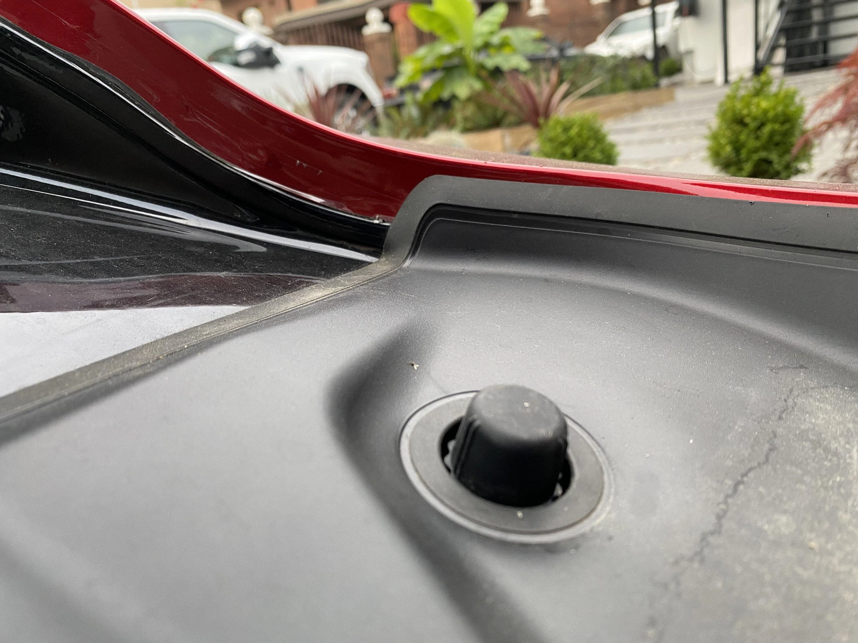

Possible only one side of the hood is fully latched? Not sure if having only one side latched is enough to not show in the cluster.

Hood is fully latched.
Anyone know where the hood open sensor is?

That is something that would need done in BimmerCode first. What he is describing is exactly what mine does when I have my hood latched in the ā€œfirstā€ position for my tender. It definitely thinks something is left open somewhere.

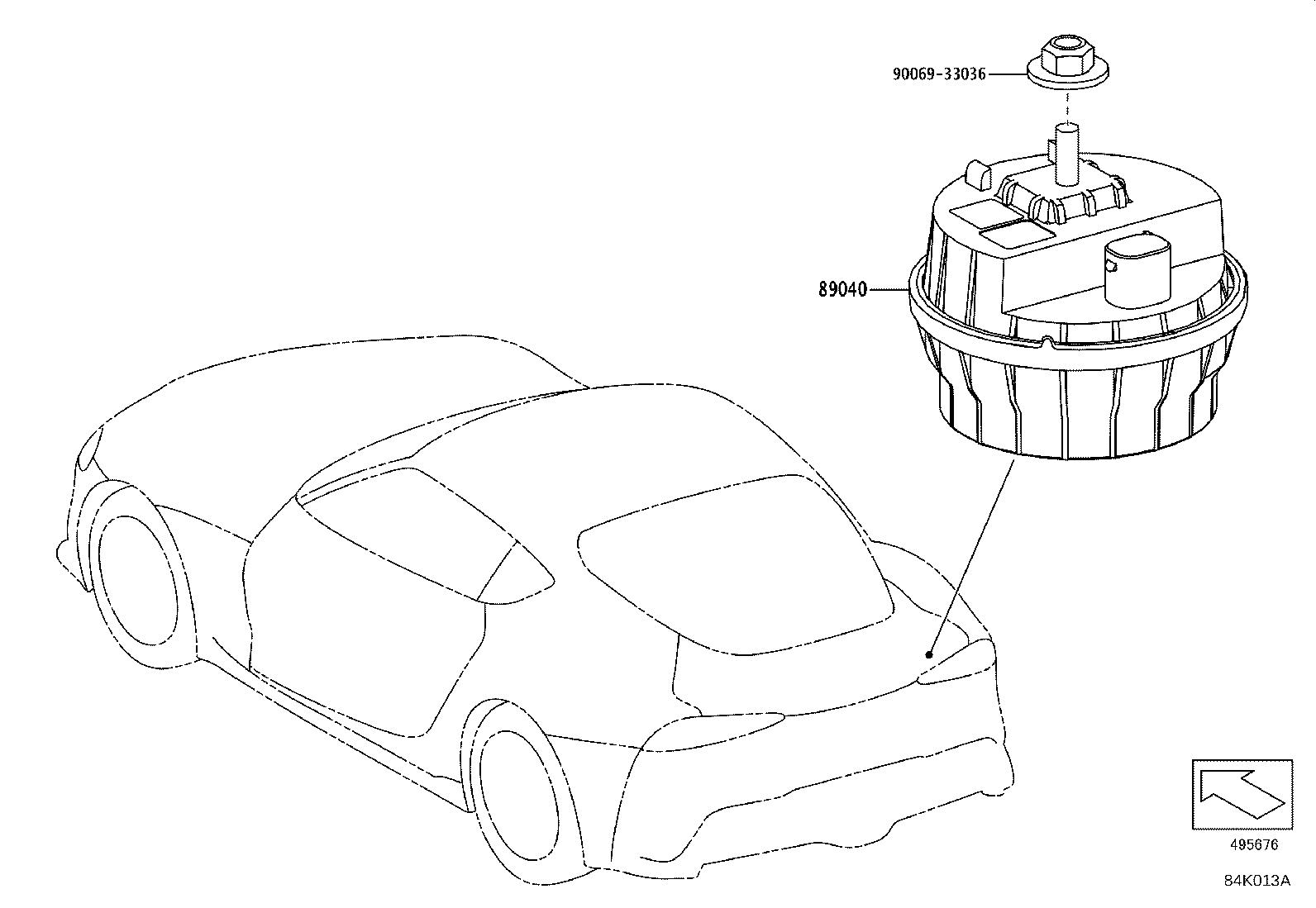

Starting to think the following tilt sensor may have been left unplugged if it's located in the bumper.
The image points to the trunk lid but would like to know if anyone knows where exactly this component is located.
