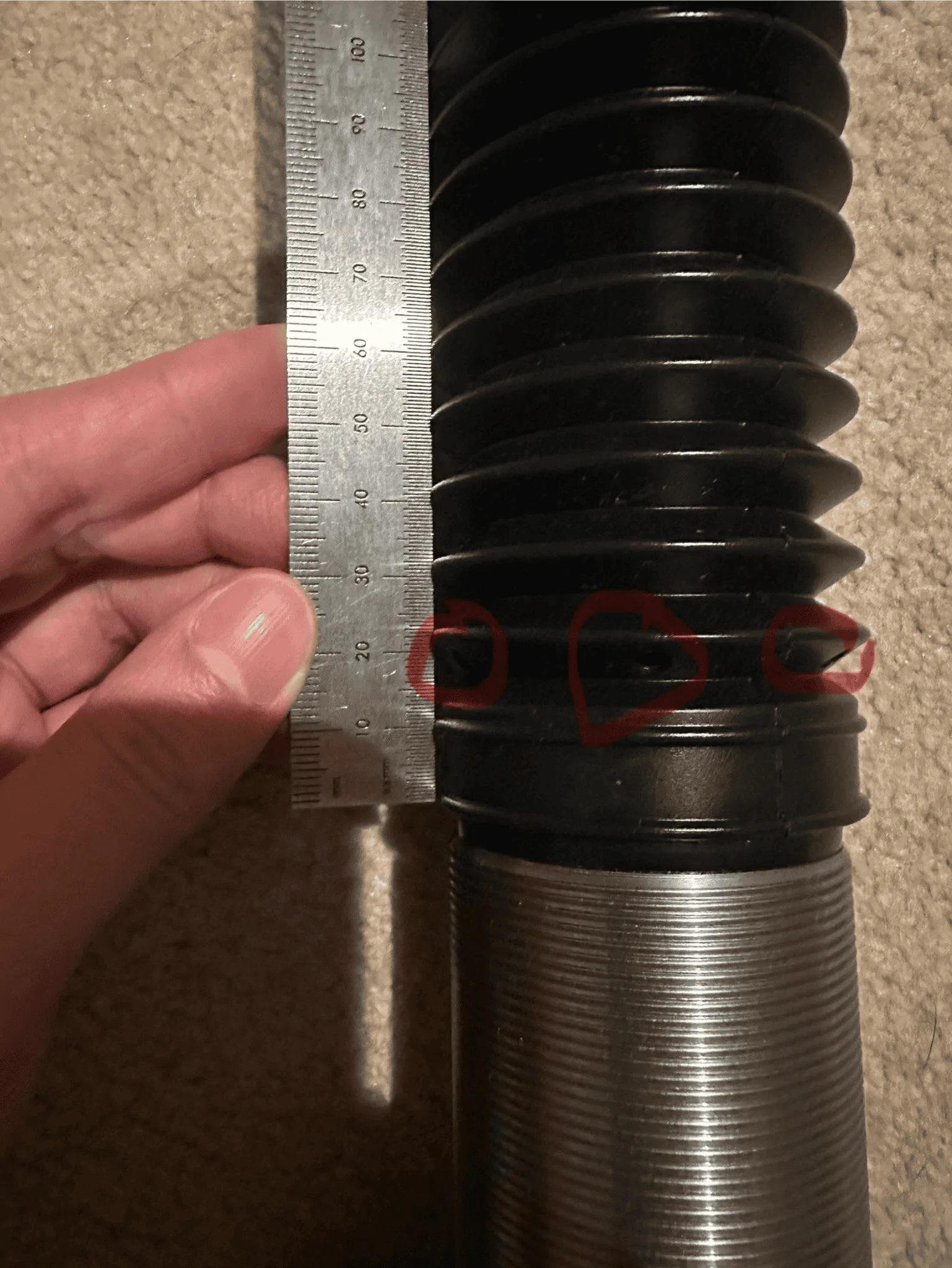

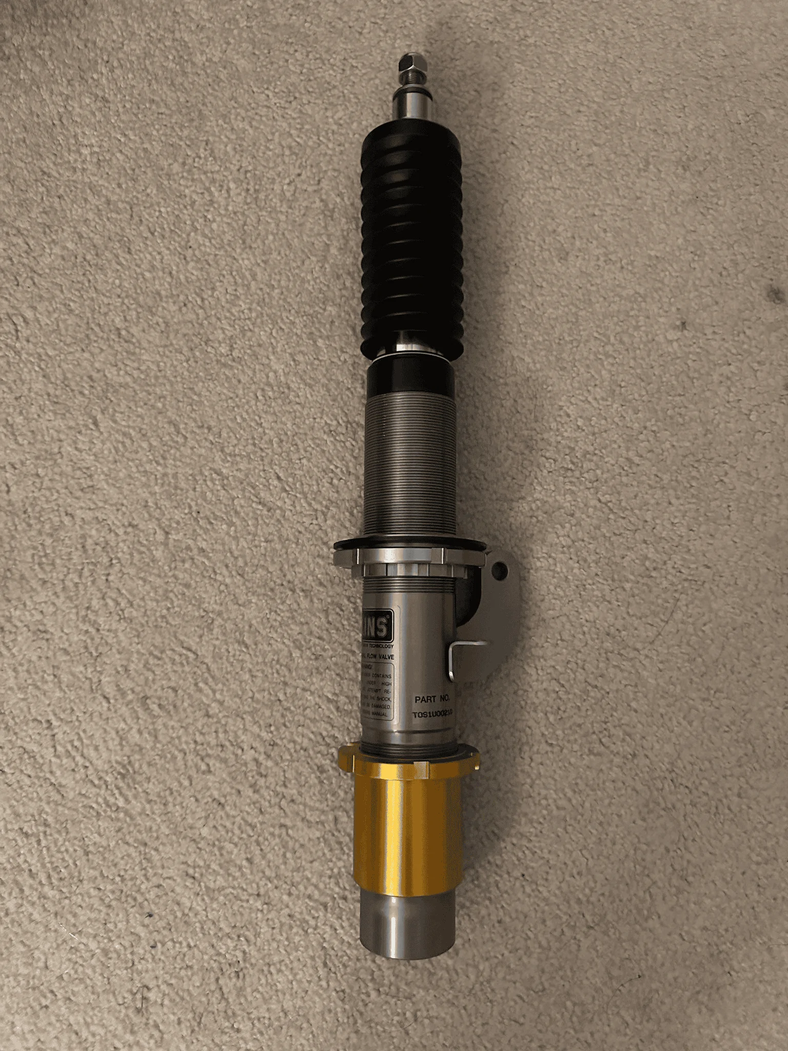

just picked up a set of ohlins road and track and will be installing them in the spring. i'll be using the OEM top hats to keep this more or less a street car with some occasional autox/track.
just a few things i noticed. the procedures ask to cut the bottom of the dust boot by 30mm. i confirmed with ohlins USA this is to allow water to evacuate. if you don't cut it, the boot creates a seal with the shock body and could potentially trap water.
here's the original uncut dust boot. there are holes in the boot to allow some water to escape, but still possible to trap water based on the design. i circled where the holes are.
here's the 30mm cut dust boot.
