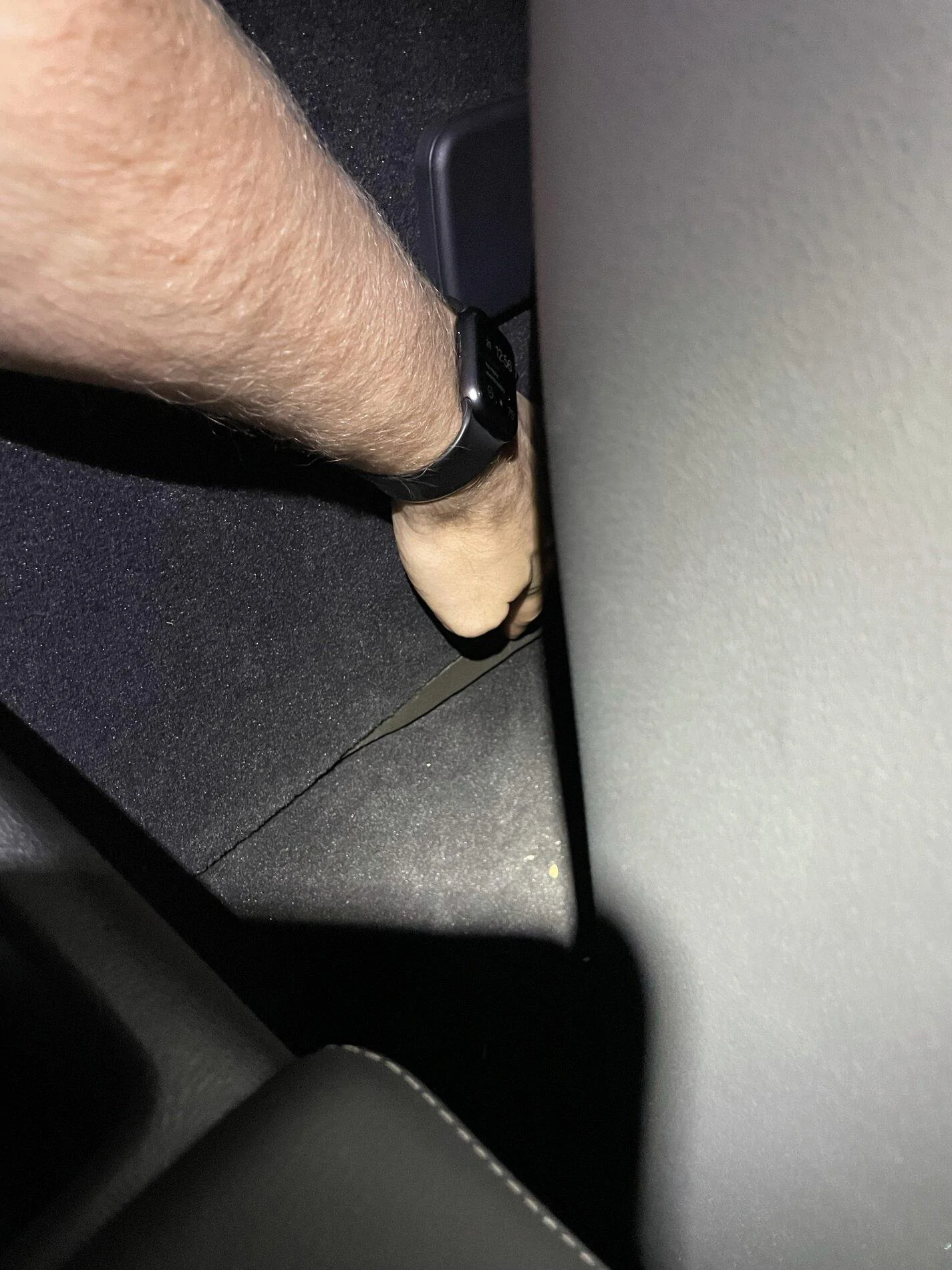

Hi everyone, new to the group. I have a 2020 Supra. ive seen some threads on the forum about rattles but not sure if its the same issue as the one that im having.
i have a NASTY rattle when i play any music in my car. With all my Tone settings in the middle.
the rattle comes from the the black felted area where the child anchor is behind the passenger seat. if i press my hand against that plastic block and press against the whole compartment the rattling goes away and the music sounds better. soon as i release pressure the rattle comes back.
im dropping it off to a local dealer but im sure theyll either find a temporary fix or not fix it at all.
does anyone have this same issue?
how did you fix it?
is this covered under manufacturer warranty?

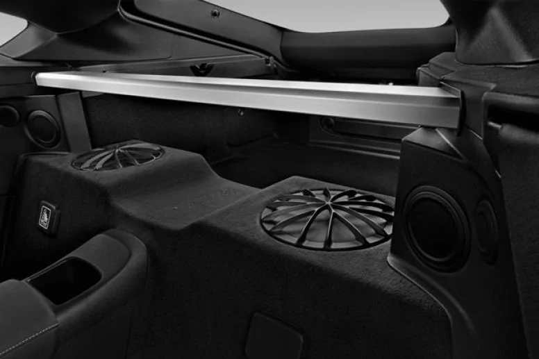

Also the problem is the oem quality so replacing anything with another oem piece would likely not solve your problem anyway. I'd follow tadda's recommendations. They definitely helped me. Especially the part about adding silicone between the cheap pieces on the plastic subwoofer grilles

I thought this was the thread linked above but I guess tadda was referencing a different thread.
This thread by @tadda outlines a bunch of great modifications to help optimize your audio and decrease vibrations.
https://www.supramkv.com/threads/how-to-improve-oe-sub-bass-quality-and-eliminate-vibrations.5092/
Towards the end of the first post there's a section about the subwoffer grilles and applying silicone. Essentially if you pull out the grilles which pop up easily, then separate the 2 plastic layers that are very loosely connected, you can apply a bit of silicone in between and it will help the rattle that a lot of people (myself included) would hear.

Also, if you want to just fix the vibrations from the panel with the child seat anchor, here is a 30 second fix: just put some foam padding in the gap between it and the lower panel to tighten it up.
