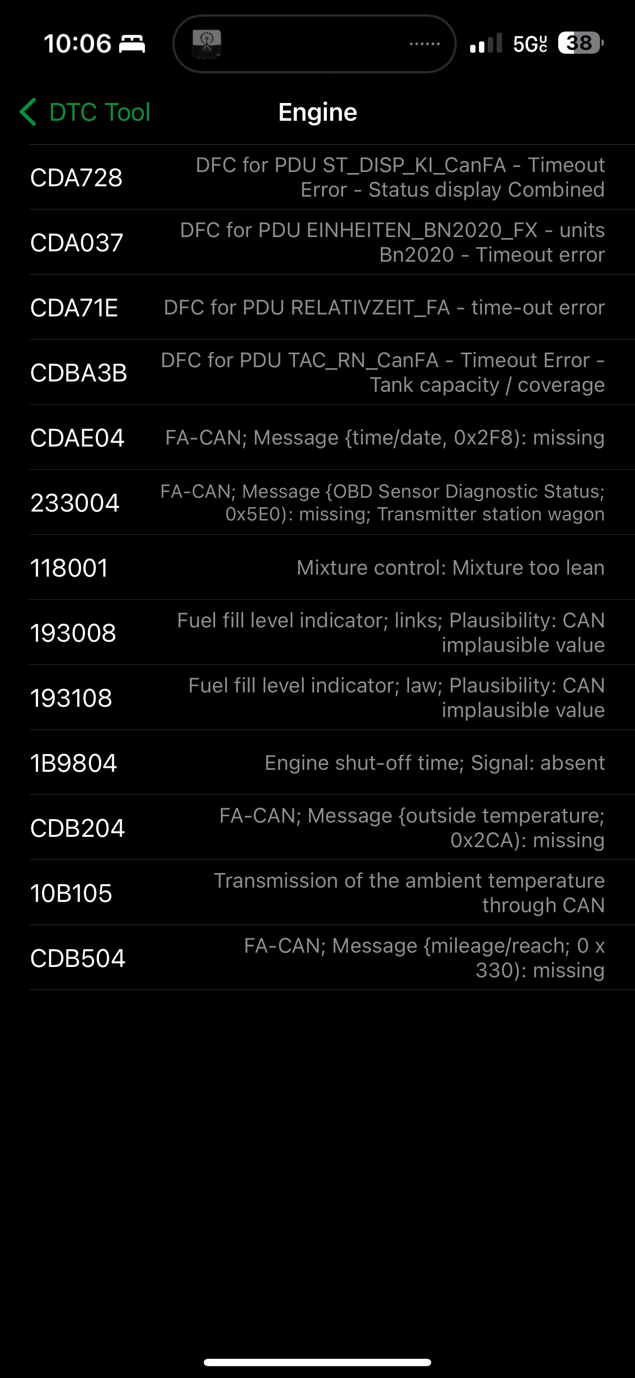

Attached a screenshot of the codes I’d get when my cluster doesn’t work and a video.

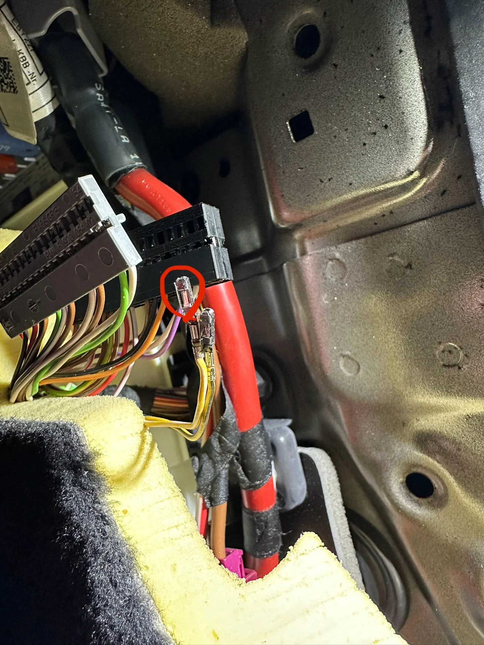

SOLVED:
Error codes were from canbus wiring broken pin - Replaced with new pin from BMW and works perfectly again.
Misfiring - Smoke tested and had a tiny leak on downpipe - Realigned and retorqued

Yup, these are all CAN codes, and those are the two wires the flex fuel kits ask you to modify in the passenger footwell. This is poor connectivity, loose connections, improper depin/repin, something like this. But it's all in the wiring.

Sounds like some of the wiring didn't go back as intended.
I suggest carefully going over the canbus wires and ensure everything is where it should be.

Just took out the BCM and the yellow/white wire came straight out without picking it out. It looks like it’s missing the locking tab/piece. The yellow/black wire was fine. Is there a part number where I can get a new piece to put on the wire?

SOLVED : Smoke tested and had a tiny leak on downpipe causing misfires and lean codes - Realigned and retorqued and running perfectly.
EDIT :

A leak in the down pipe 1000% didn't cause those issues.
Correct, I added/edited the fix to the electrical issues on the original post and forgot to add it to my last response. It was canbus wiring. I’ll add it now
