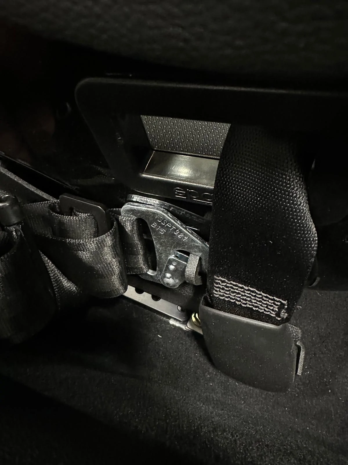

My Supra is my daily and also my track car so I wanted the option to run harness and stock seat belts
For any one that is running both seatbelts. How did you guys go about installing the stock mounting brackets to your after market rails? The stock brackets uses a latching style and I don’t see a bolt that I could remove

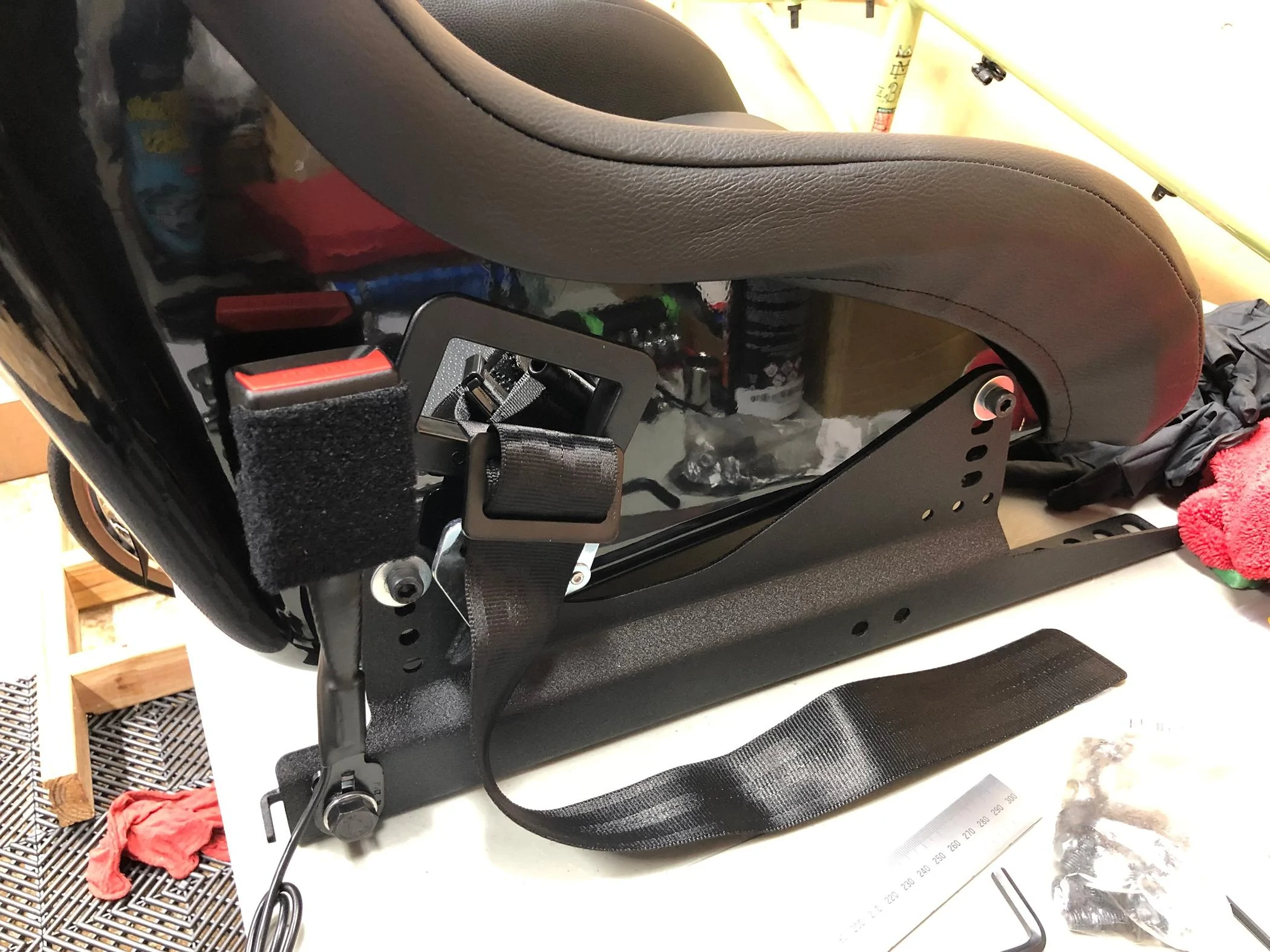

What Bryan said. I use the same hole my lap belts bolt to.
racebuild
Jul 14, 2023
208
214
BMW
^ what they said.
I also stacked my lap belts with the factory belt mounting. I added in a flanged sleeve/bushing on each mount to keep articulation of the belts.
