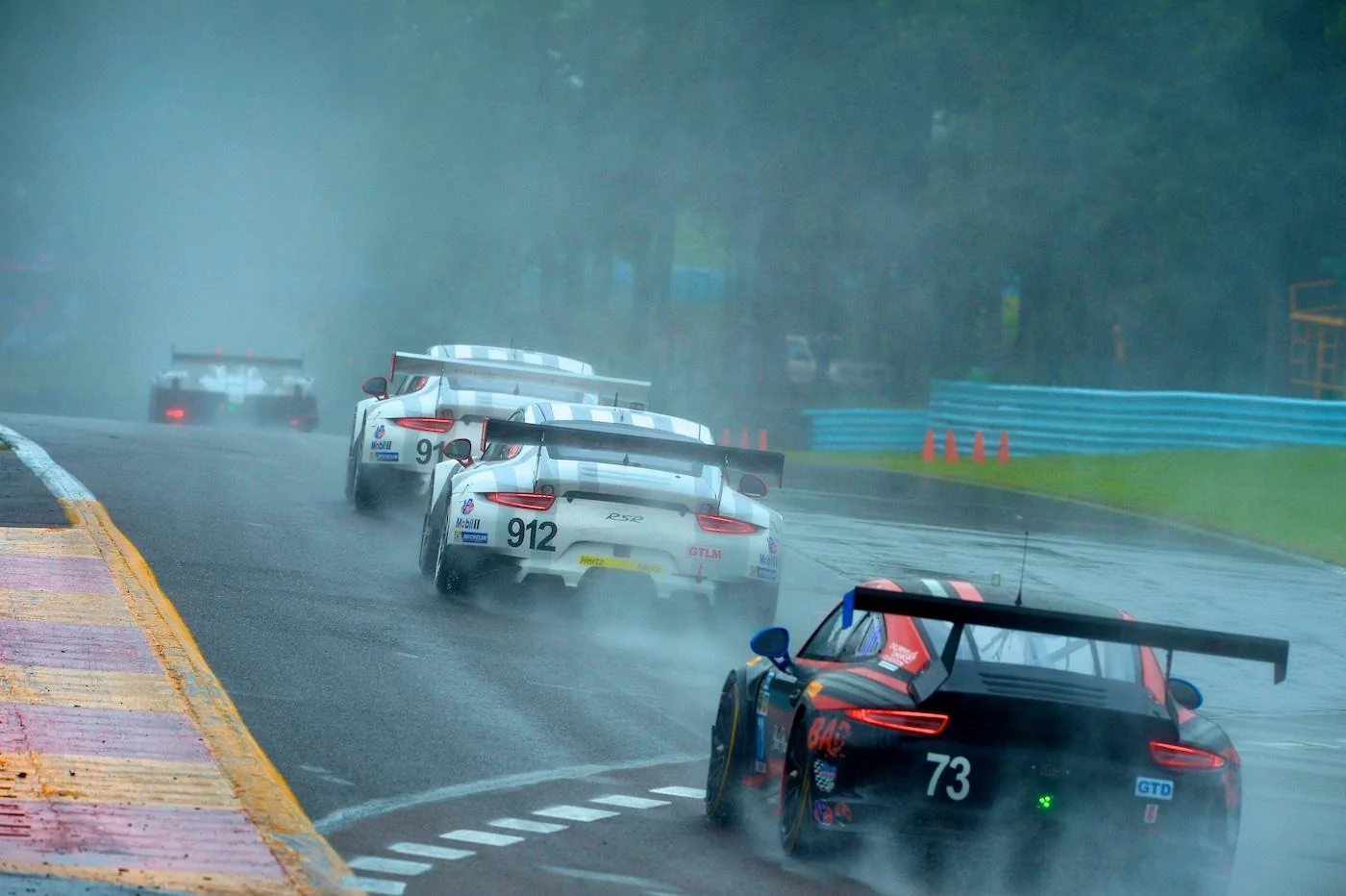

I'm disappointed, because I thought this was gonna be about sweet wake vortices visible in the mirrors during heavy rainfall and the associated spray at highway speeds...

Well you messed up on two counts then. :)The idea of winglets at the tips of a wing is to eliminate wake vortices. Thats why commercial jets and other a/c have them these days. Eliminate the wake vortices, which reduces the drag and the fuel burn so on longer flights you can increase your passenger/freight uplift because you need less fuel for the flight duration. Higher t/off weight for less fuel.
On a race car during an endurance event you would get a measurable fuel saving and maybe eliminate a pit stop.

I knew "vortices" possibly wasn't the right term, at least, in terms of something we desire, because obviously they're a drag...but then again, does Street Hunter claim their wing is truly functional, or just there for aesthetics?
More or less I was wondering if the vehicle's wake (visible in the mist/kickup) is noticeably different with the wing, like more of a 'rooster tail' than without the wing.
I followed the development of the 787 Dreamliner, and am very impressed with how effective those new winglets are. All great ideas are obvious, aren't they?
