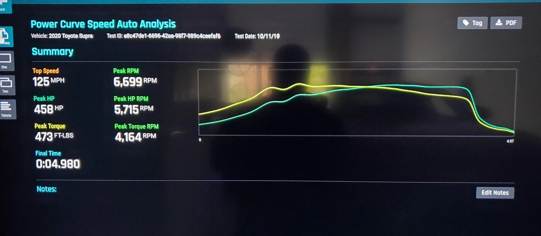

Saw some people asking about 93oct pump numbers on the Pure Turbo upgrade.
Ran ours dry tossed in a couple gallons of 93oct on our bone stock other than Pure Turbo.
458whp on our Mustang dyno. Should equate to 500+whp on the dynojet.

I like how the torque and graph in general is smooth and linear. I prefer this over stock turbo just for that.
1) Would the tuning be any different for cars that are used on track say for 20 minuets sessions?
2) Have you done a similar setup with a down pipe? Any CEL?
3) The above run was with no meth?

1. for road course style racing, the tunes would always be setup a little different than a drag tune. For instance, on a drag tune you want the more power and torque you can get without spinning the tire like crazy.
For road course, you don't want ultimate neck breaking torque, but more of a tame linear onset of power where it doesn't easily unsettle the car. Also, a little lower power for a 20 minute session is advised. Track maps take testing with the driver and his style. I've done tons of maps like this for people over the years.
Also, another thing to note i can adjust your throttle mapping to be more or less aggressive or touchy as well to accommodate the track performance.
2. yes, no worries on CEL. my tune will take care of that
3.correct, no meth. 93oct only.

What was the stock whp/torque numbers on that dyno?
Really interested to see how the above car will do with the same setup + Twisted DP.

it put down right around 295ish whp on stock turbo.

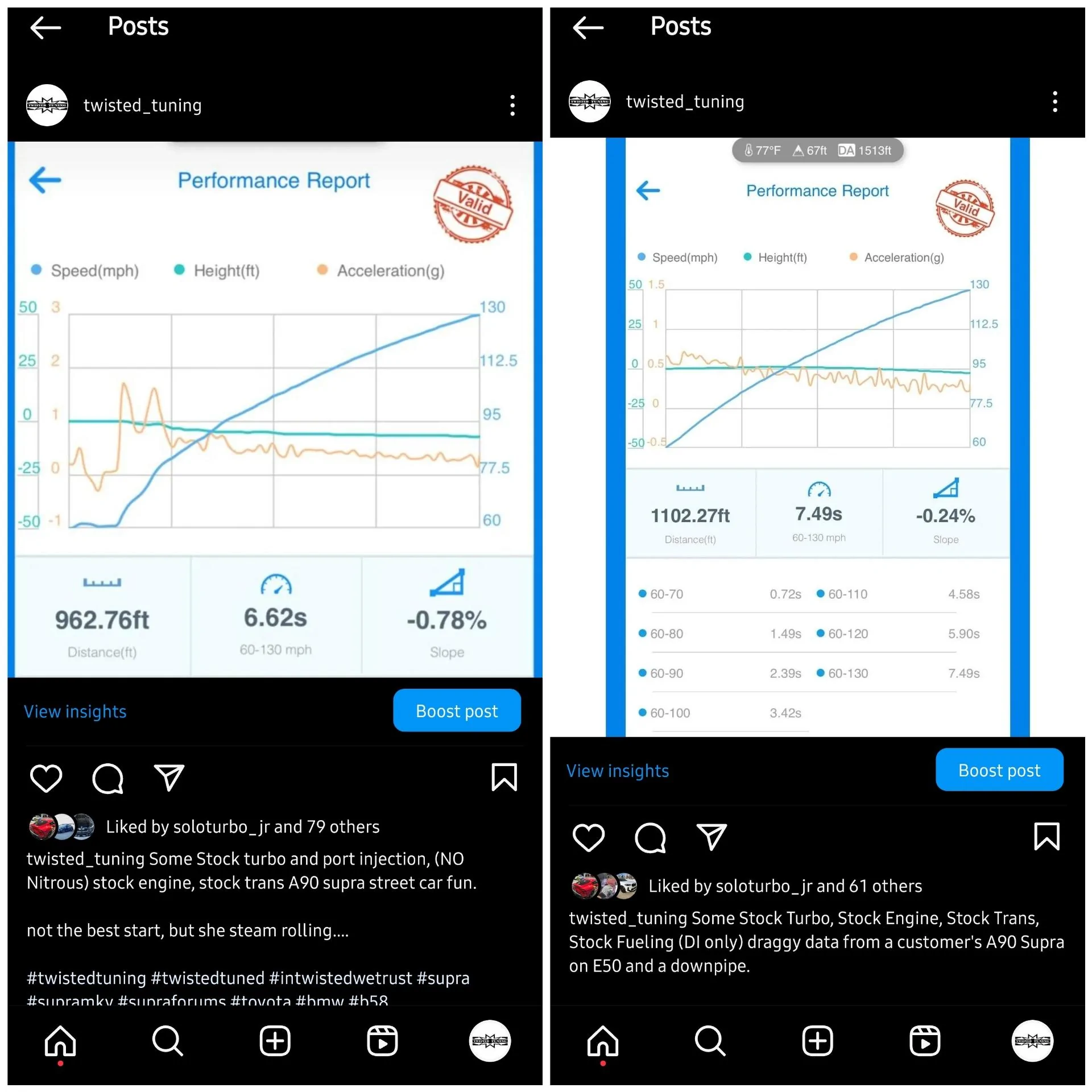

Couple stock turbo result. One with port injection on just DI.
