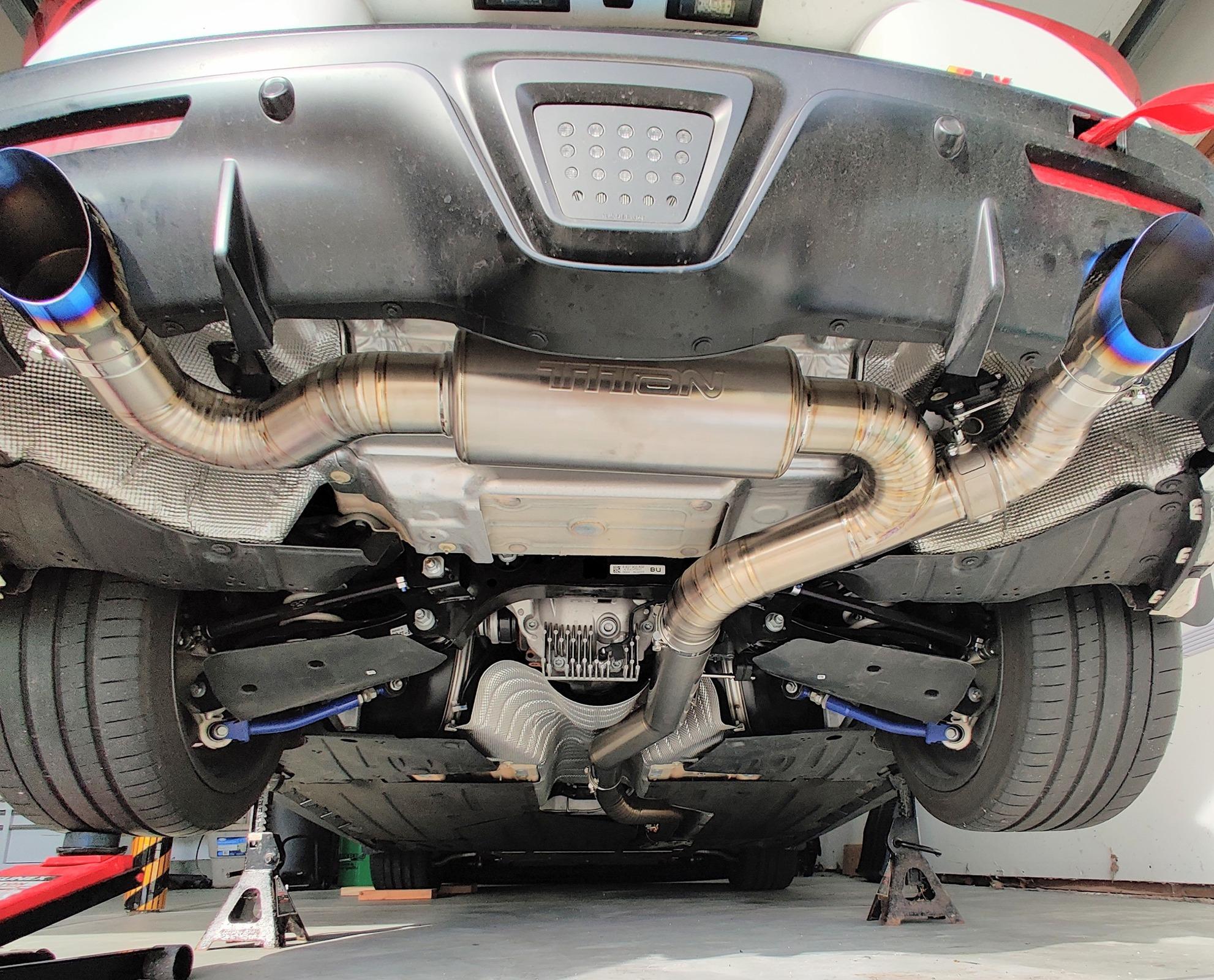

titan motorsports exhaust. In Normal mode its LOUD but very little drone at 8th/80mph. at 92mph there's a perfect harmonic and its almost silent. very "warm/smooth" RB26-like sound in normal as well.

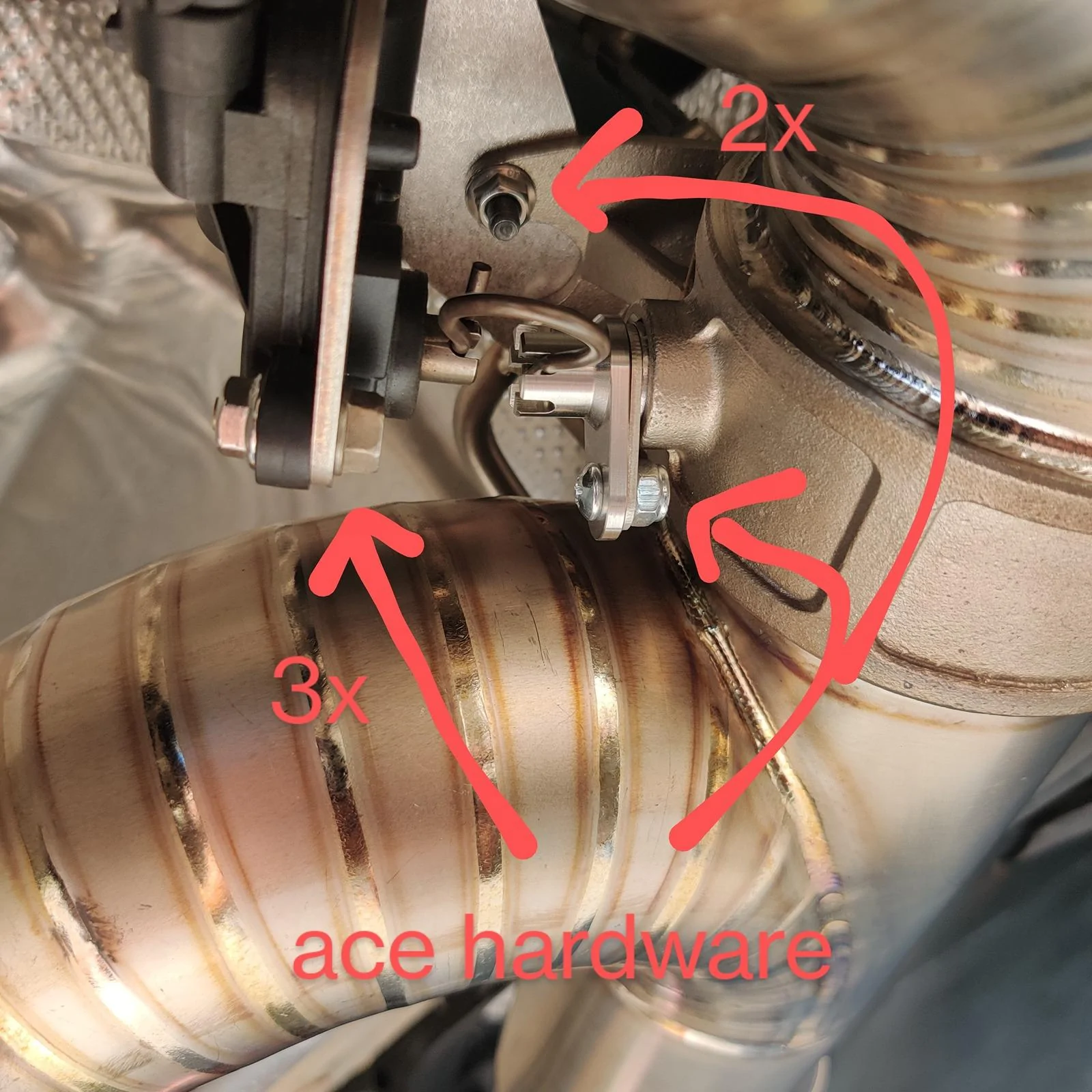

some install notes specific to the titan (since they don't provide any, and no videos exist).
-discard the exhaust valve motor's heat shield, it won't fit flush onto the provided bracket
-motor bracket does not include any hardware, and unlike the factory bracket does not have threaded holes. You can reuse the 3 OEM motor-to-bracket bolts, but you will need to find matching nuts
-the motor bracket is a separate piece. You will need 2 bolts and nuts to mount it to the exhuast bracket. this will be a smaller size than the motor bolt, and will need to be a socket head to clear
- Titans flapper valve is actuated by a small arm that needs yet another small bolt and nut to bolt it down
- installing the spring clip will be backwards from How it was from the factory. The half moon side of the clip is too small to fit on the Titan arm so you will need to put it on the motor side

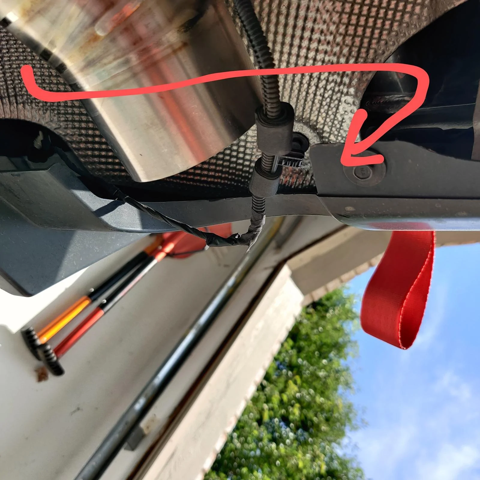

- the wiring harness will be able to reach the motor, but you need to Route it over the heat shield

titan motorsports exhaust. In Normal mode its LOUD but very little drone at 8th/80mph. at 90mph there's a perfect harmonic and its almost silent. very "warm/smooth" RB26-like sound in normal as well.
