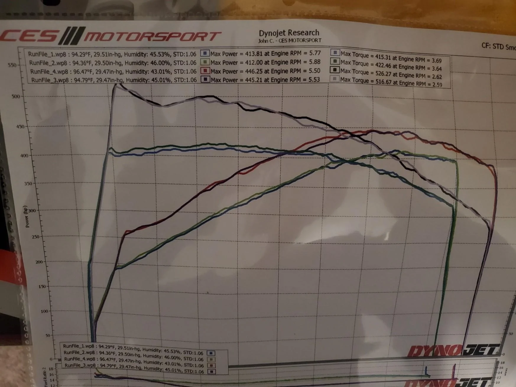

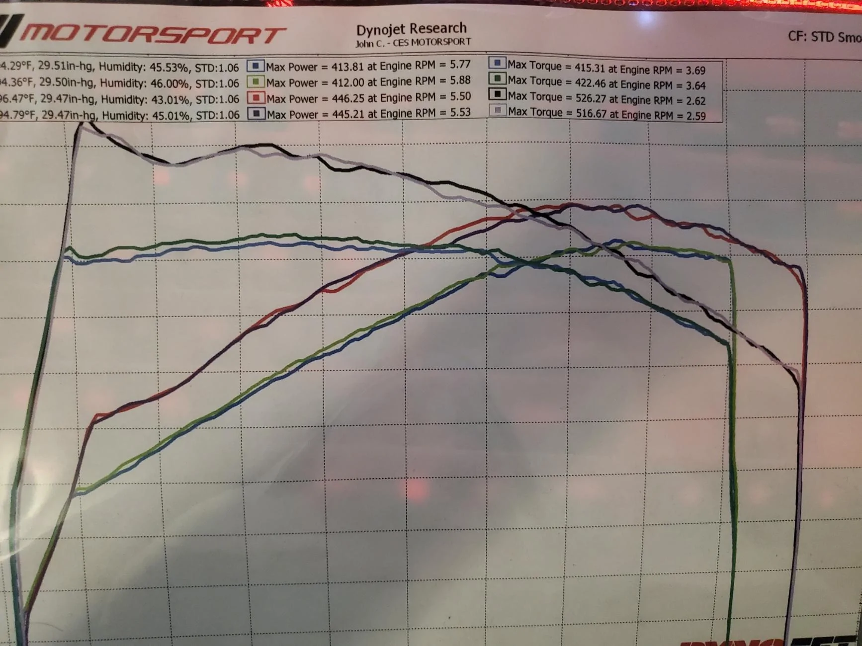

MHD Tuned, price for everything ranging from the catless downpipe, ECU Unlock fee, MHD Super License for the B58, MHD OBD Dongle, having the shop teach me how to use MHD and install the stage 2 93 octane OTS map, and 4 Dyno runs was $1600. Car made 446whp and 526wtq on its best run on 93. Since then, I've had an E40 custom tune dialed in and the car is a hell of a lot quicker now. I would assume it's making 510ish whp and probably 550ish wtq now. The price of the E40 custom tune by Fabian @Pureboost.de was another $475 USD and it took 8 revisions to perfect it. So, from start to finish, the entire thing cost me right at $2,100 but that does include my downpipe since CES Motorsport sold me the downpipe on the day of tuning, and I don't think many people are including their downpipe price in their total pricing of the stage 2 tune adventure.
In this picture, we forgot to do baseline runs with the car on stock downpipe so the first two runs are stock tune with CES Motorsport Catless Downpipe ONLY! The two following runs are with the Catless Dowpipe and Stage 2 93 OTS Map. I posted a second picture of the same Dyno sheet so that you can see the ambient temps. It was a hot ass North Carolina summer day in that shop.
Review: Car runs and drives absolutely perfectly on both the 93 OTS Map and the E40 Custom tune. There was an issue at one point when trying to use an OTS E50 map that was causing "insufficient fueling for power delivery" Errors that would put the car in limp mode, but this has since been resolved and the car runs and drives like it came from the factory this way on both maps.
