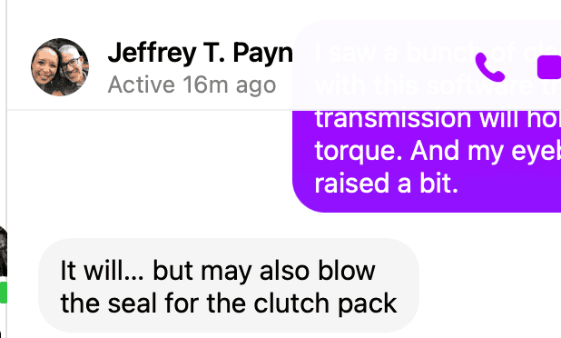

Right off the back everything is much smoother. The shifting on both sport and comfort are smooth. The downshifts sound great in M mode with the blips. Comfort mode is much better without the car racing to 8th gear. Idk why everyone is scared and worried. If you leave it in the regular OTS maps, you will be 100% fine. XHP has always been a top mod in the gen 1 b58 platform for years which is the same trans. Leave the OTS maps as they are and do whatever updates they have and it is perfectly fine. Don't forget to drive easy the first 50-100 miles
79
8,447
13,869
I assume you're making a joke? 8HP51's only applications are the Supra, G20, G29, and Jag XE.
No one is scared or worried. Read through the thread a little bit and see what we're saying. OTS maps going to improve your 1/4, especially the safe ones.. To a lot of folks, "then what's the point." The more aggressive and custom tuned options for this specific trans in this specific application are still unproven. None of the fast guys have had enough time to really tune, really push, and really find out what the limits are and where the limits are.
The clutch pack seals are without question, a weak point. We have a calculated, but not proven understanding of how the OTS maps are going to perform on built trans', either. There's a ton of variables. Yes xHP is proven for a bunch of applications, but this -is- software, written by humans, or a relatively new trans (3rd Gen ZF85x).
To some, the worst case is pretty bad, and the best case isn't that great.
I assume hes referring to the 8HP50, which in fairness is very similar to the 51 that the supra has.
79
8,447
13,869
It is very similar, but it is not the same, doesn't have the same TCU, and has variances in the valve body, and (not as importantly) different gear ratios.
Not everyone is getting this to improve their 1/4 time by tenths of a second. Yes that is a factor that can be beneficial, but the overall drivability is so much better and that makes it worth it alone. With the ability to customize certain setting if you know what your doing. None of the fast guys have it yet, but they are working on something. Visconti is definitely working on something. Obviously, for anyone looking to make high power and best possible performance, a pure trans would be better route since our trans mechanically can't support high tq. But for $400 bucks, the software is worth it. Just like it has been for every other platform they had supported. It's not that deep bro lol
