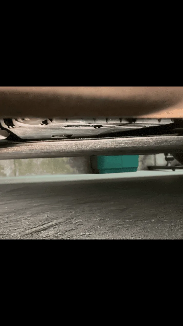

So for the leak, would it show any on the driveway or there is a tray underneath the area?
3rdGearEvo
Paul
Oct 29, 2019
103
109
Staten Island, NY
2020 Supra MKV, 2003 Evo VIII

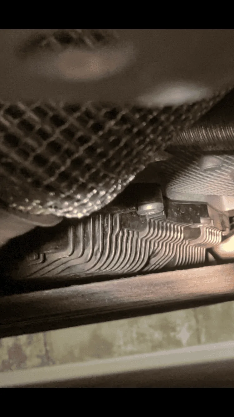

If you lay on the ground next to the passenger side of the car, you can shine a flashlight between the chassis and shroud under the tranny pan. It’s not very easy to see but if you look closely you’ll see the tranny pan and tell if it’s leaking.

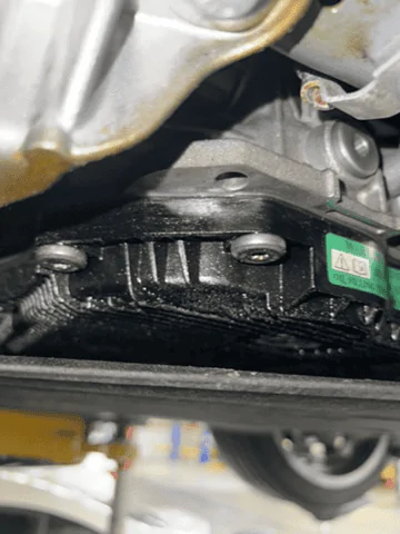

Brought mine in for an oil change today and got this picture from the service team. They are starting with replacing the pan and seal. I'm guessing I'll be bringing it back again to have the yoke done. Making note of the part numbers

Welp! Was in today having the oil changed. Wanted the dealership to do it so they could check the trans pan and have documentation of the problem and all. It’s wet again. Back in it goes for the yoke seal I guess.
