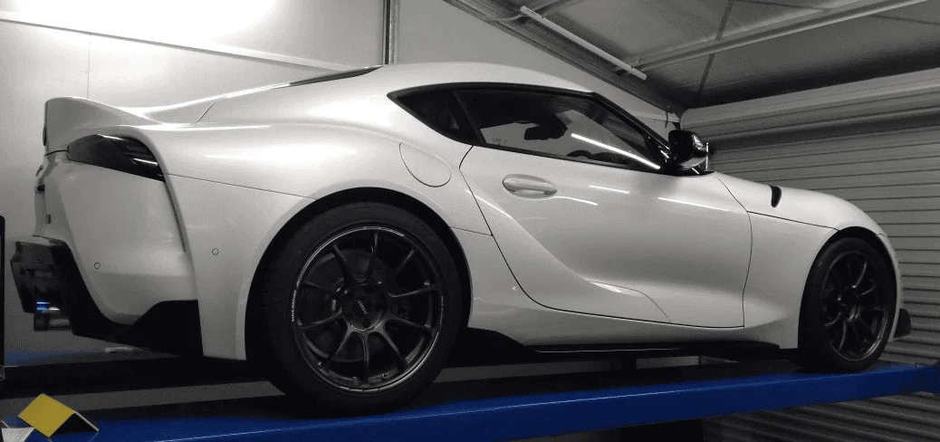

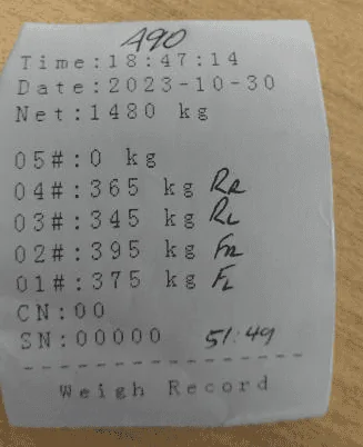

2023 A90 6MT Supra
1480kg
AU "GT" Grade (No HUD, no JBL speakers, 18" wheels standard)
51:49 F:R
19" ZE40 time attack 2 w/ 255 and 285

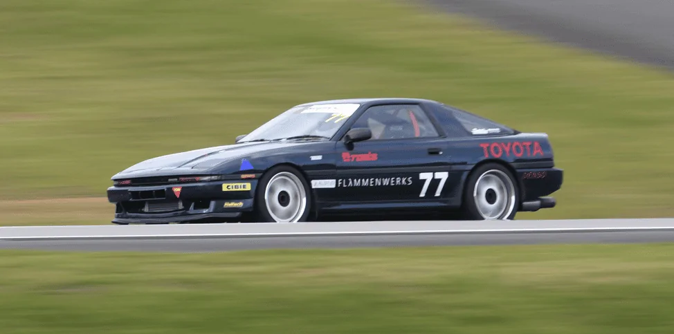

1986 A70 Supra
1410kg
55:45 F:R
1JZGTE R154
+ Big Brakes
+ 18x10 Keonigs 265/35 square
+ half cage
+ Single Turbo and 4" exhaust
+ FMIC
- 2x 7kg seats
- No interior
- No sound deadening
- No Heater Core

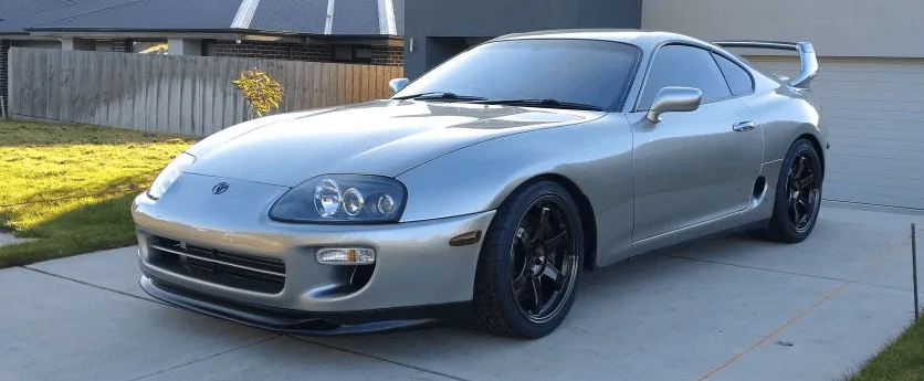

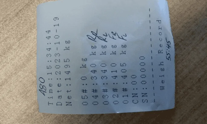

1999 A80 Supra 1495kg
55:45 F:R
2JZGTE V161 SR3 Recaros
Stock, except for:
+ BIGGER (355/8pot 330/6pot)brakes
+ FMIC
+ 18x10 TE37SL 265/35 square

I usually only track the A70, the other are too pretty to get banged up at the track. I tracked the A80 back when it was stock, but was slower than the A70 - experience and less fucks to give helps.
The A70 is getting pretty good now, hunting down GT4 Caymans at the last event.

a) There's the corner weights
b) I know. The intention is to dispel certain myths about how heavy/unbalanced these cars are in terms of tare mass. (except for A70, that thing is porky pig) RHD we are even more screwed with Toyota due to the heavy turbo shit on that same side.
